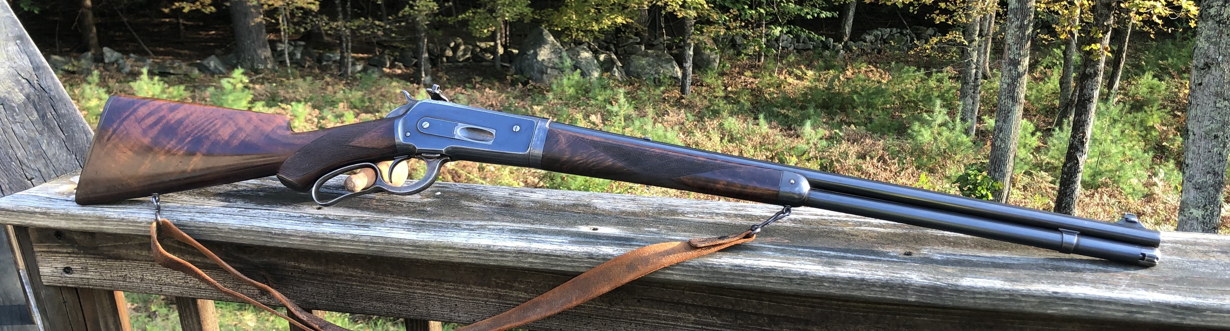

And while we’re hear talking 33’s, thought that M64lvr would like this one. It’s one of my favorites. sorry I don’t have pics of my other 33’sIMG_0492.JPG

Yes Sir, love it, its about perfect picture of my idea of what I’d want in an 33wcf Mod 86. Especially that wood, its amazing, Climbing Lyman too! Takedown also, Thank you, Thats a Rifle make a man feel good even when he sits on a log to rest from a long hard gameless hunt, then can’t wait for tomorrow!

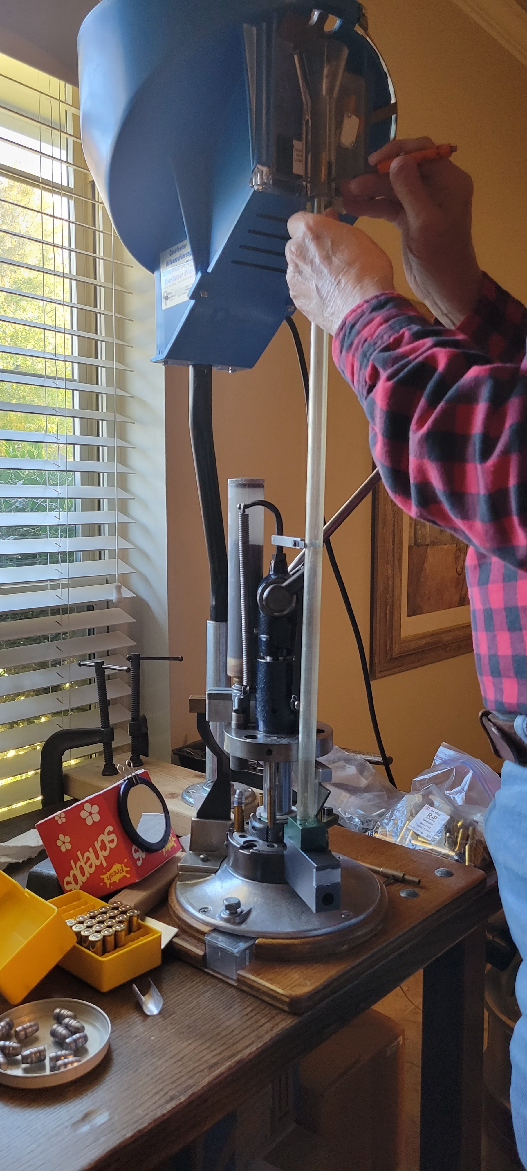

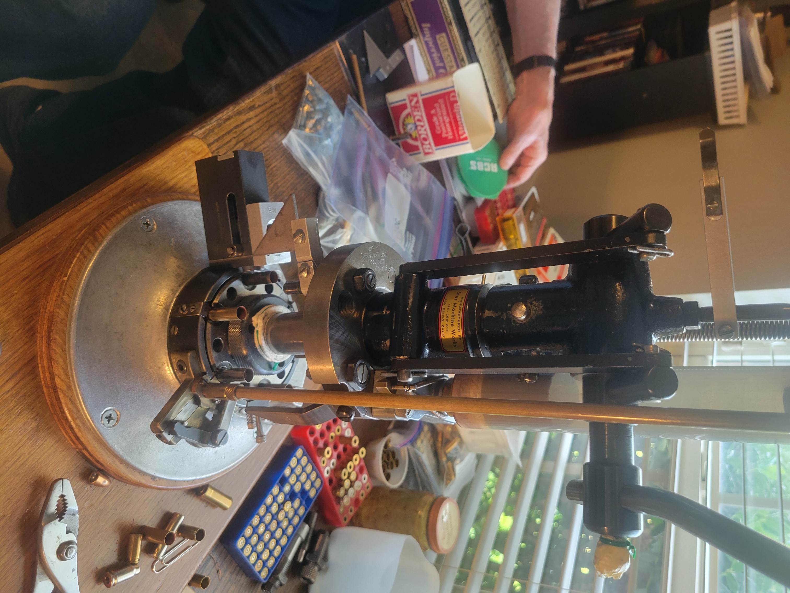

Tim,  Will do.  I’m engaged right now in moving a friend’s entire Star loading outfit, including the heavy bench he built for it, into my upstairs office/mancave. He is moving to assisted living and wants me to have it.  An engineer,  he built this bench for strength, not lightness. I had to hire another friend ‘s 20 year old bodybuilding son to get the 80 pound.top upstairs.
This particular Star has been modified to use a Dillon motorized case feeder and comes with three toolheads and die sets for 44 magnum, 45 ACP,  9mm Para, .380 ACP, .38/357, and 5.56 NATO. A very generous gift. Its donor has loaded all my handgun ammunition for materials cost, for years and I’m enormously grateful for getting equipped to replicate the task.  I don’t cast bullets (yet) but a Star lubrisizer is included in the gift. Not sure what dies but will guess 45 ACP because the donor was an avid Bullseye and practical competitor.

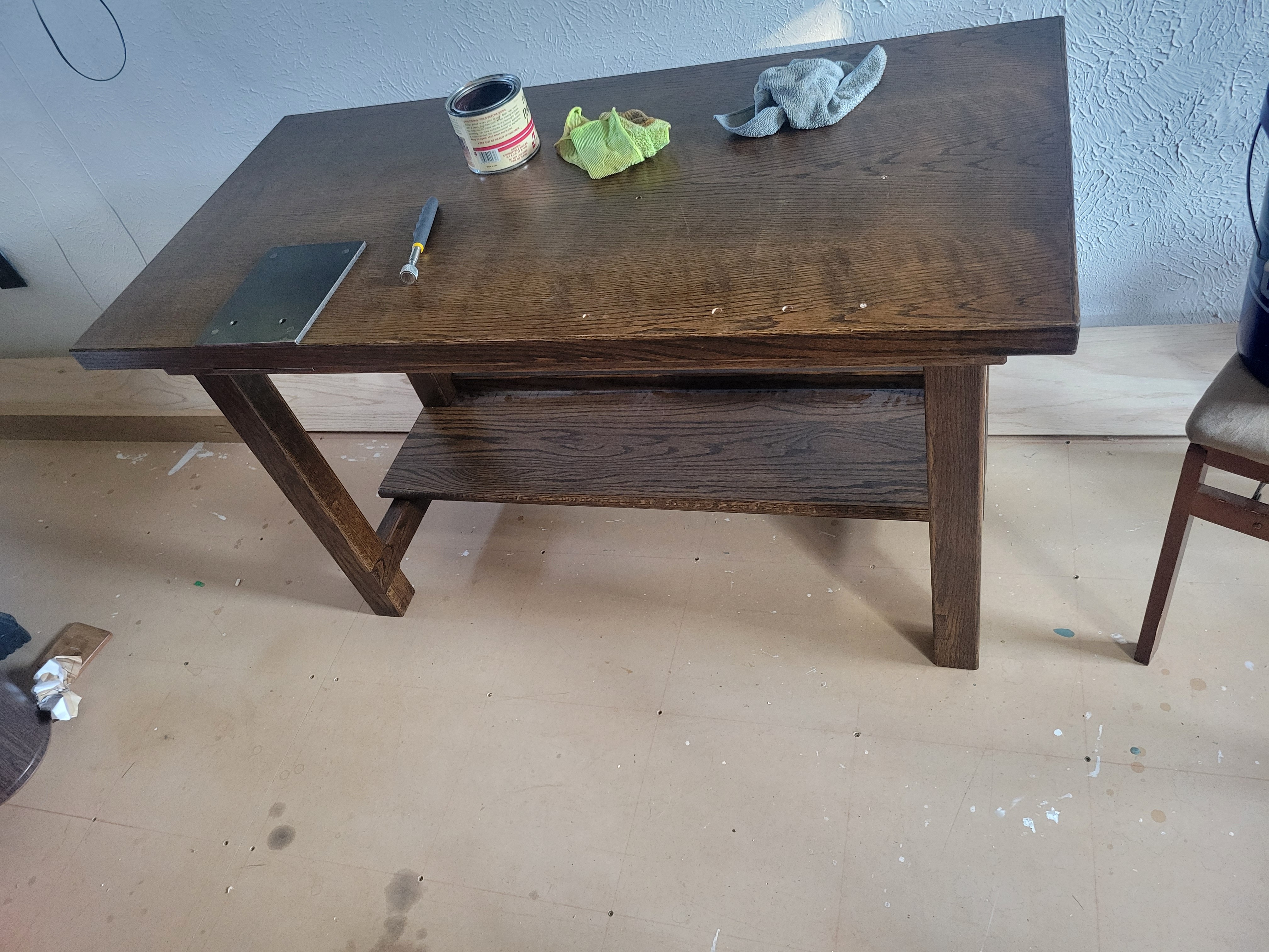

There is a steel plate reinforced part of the bench drilled for a Rockchucker,  where mine can be installed and remain. That’s where the 33 WCF ammo will be built. 20250930_175246.jpg

My NRMA spec reloading bench is one reason I hire movers. It comes apart easily into three parts but they’re all big and heavy. I even hired movers to bring it in and out of storage during my renovations. I worked for a moving company 45 years ago and I appreciate the skill those guys have. It’s not as pretty as your new bench but it was home to a Star press about 40 years ago. I think you’ll like your new bench. Sure looks sturdy.
