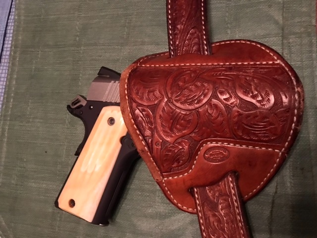

Mike, don’t forget to wear your Rolex President!
I was thinking the .45 with antique ivory would be a nice touch.
Wink
