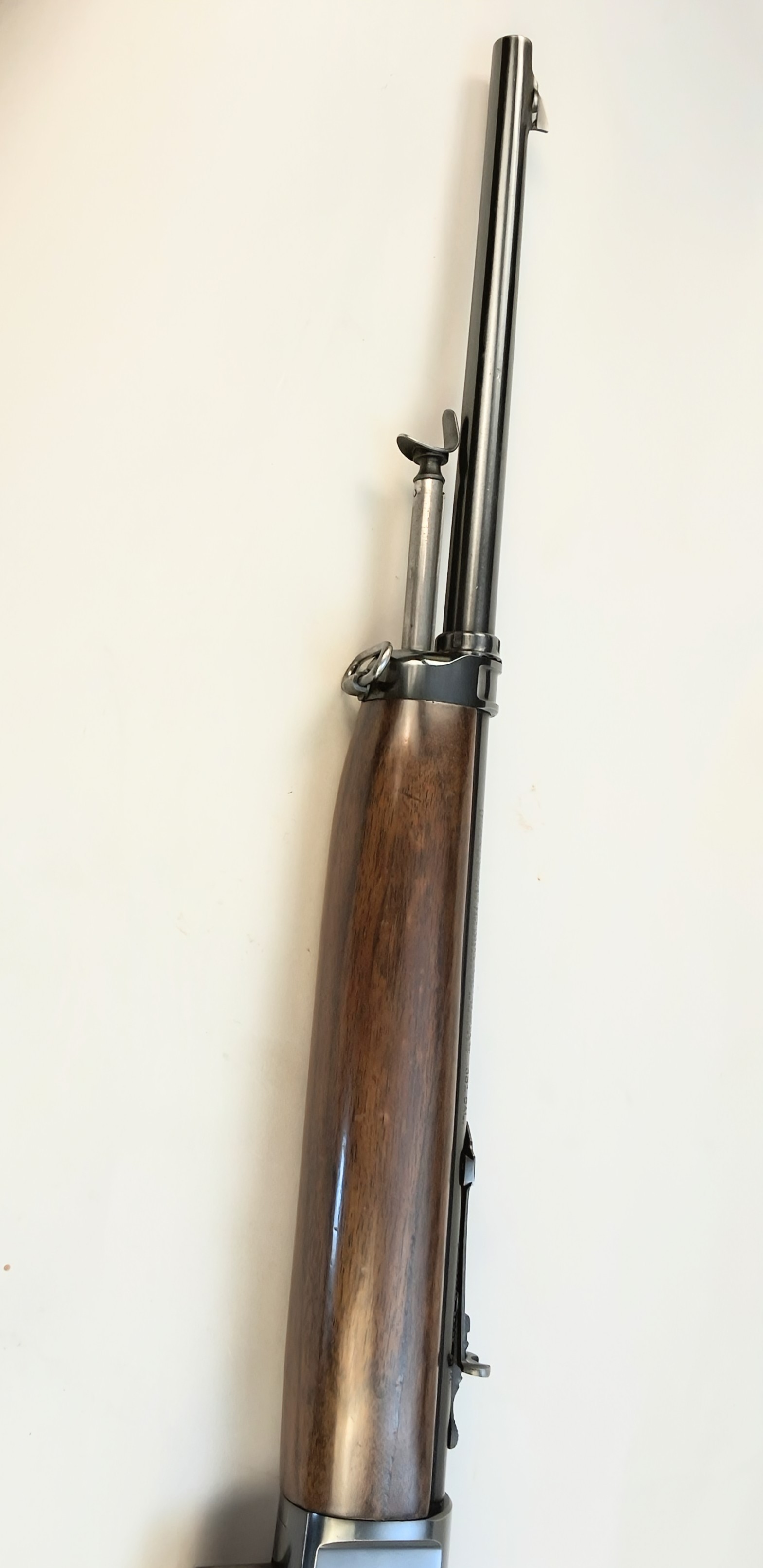

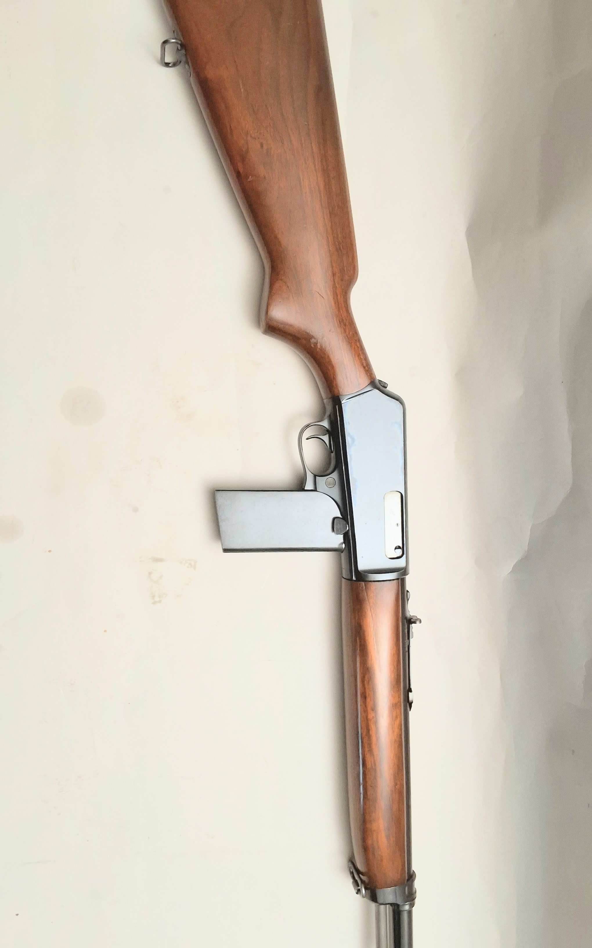

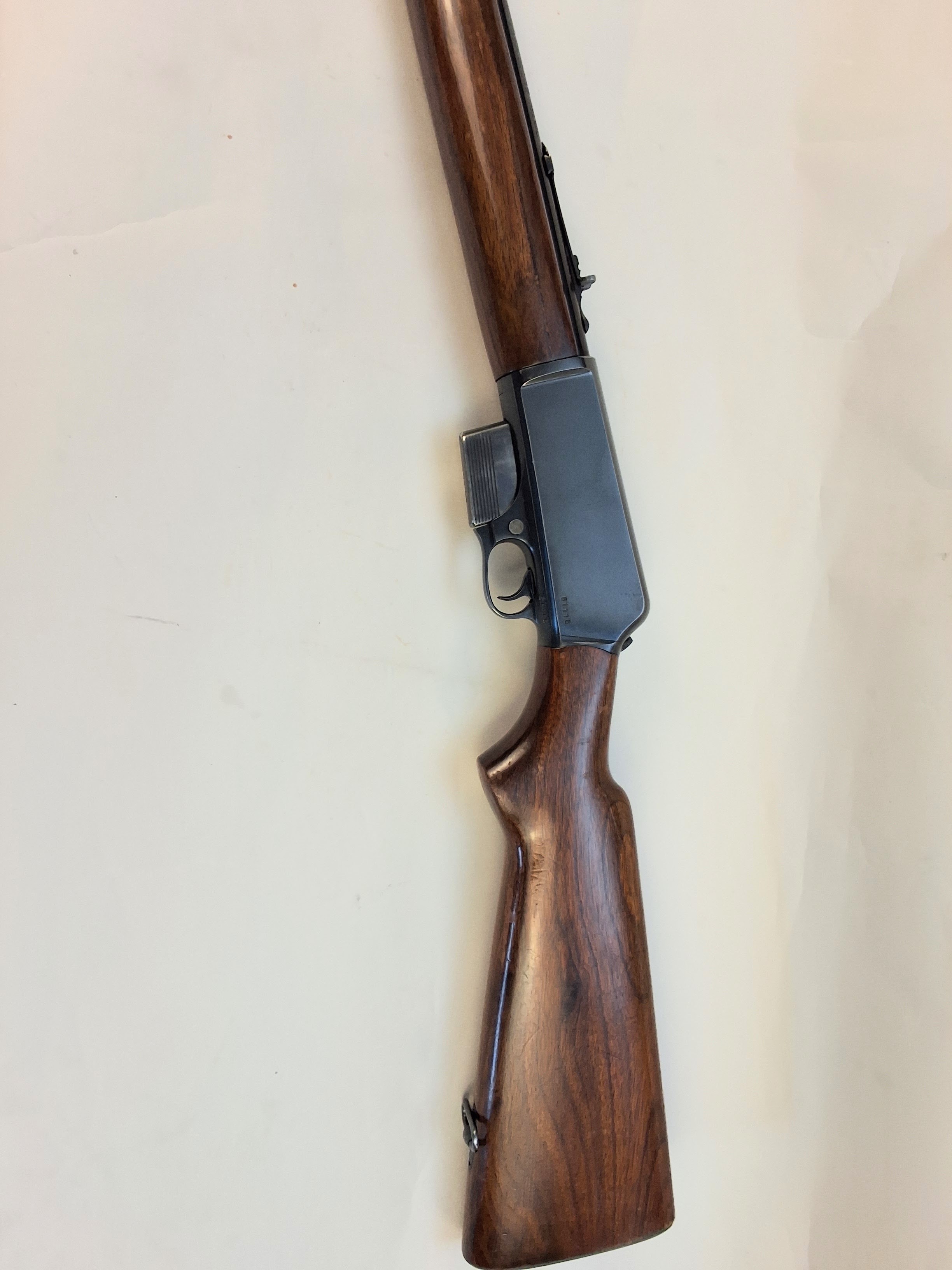

Great to see another interested in the 1907 .351. Having done some research on the caliber last fall. Ive tried historical powder suggestions and utilized the bullet from Graf 180 gr bullet. Brass is a whole other issue. I tried several suggestions but without a lathe, I couldn’t use some of them. One involved the 357 maximum. As I recall it needed the base turned to reduce its size. Did a little more exploring and found the 351 is almost identical to the 223 base not the 556 because its a little thicker and harder to work the brass. Here goes what I did and it works perfectly for me.
Using a small chop saw cut the 223 brass at the start or the bottle neck. 1.38 length, lube and run it thru the sizing die. It will not size all the way down but you can prime it, get powder in and get the bullet seated. Firing it will “fire form” the brass and be able to be reused. Ive reloaded some of these brass 7 plus times. I found new 223 brass works best.
Powder I started using 4 powders. The best results came from IMR 4227 and 2400 a distant second. Unique and Reloader did not perform well enough to cycle the action.
IMR 4227 19 grains 1848 fps. Excellent accuracy and feeding/ejecting. 1.90 overall lenght.
These are my worked up loads and should be laddered. I hope some of this you’ll find helpful.
I have 2 1907 .351 made in the early 50s and a 1910 first year made .401 that I found challenging to find brass as well but over came challenges and it shoots great.

Thanks, Jeff.  Particularly for the load information. I had thought the fast pistol powders might not push long enough to overcome the big “bolt extension” .
I do have a concern about using rimless cases because there’s no way to control headspace. The only thing holding the case head within reach of the 07 firing pin and keeping it from sliding down into the chamber leade,  is the grip of the extractor and, possibly, bullet contour. The chamber is cut without a bullet seat, so the cartridge has no way to headspace on the case mouth like the common autopistol rounds do.

I had concern about the whole thing not working but tried a few and expanded on them to get to my final results. With the full power loads I use the empty shells from both throw to 2-3 oclock. About 5 feet that way. Ive reused the same cases multiple times. Mostly to see how they will continue to work or not. Havent had any jam in the chamber or cases slide in farther than they should.
My 1910 .401 throws spent cases to 3 oclock and only about a foot away. 4227 is the best powder there as well. 2400 a distant second. I found some brass but make my own out of 7.62 x 39 brass. After the first firing they are almost identical in every aspect to actual .401 brass. I have to open up the AK brass with a tapered punch and fire form them. Id say the recoil on the .401 is about like a 12 guage. Mine came with an original peep sight on the tang but I removed it. Just use iron sights.
They are fun guns to shoot. I hope you enjoy them as much as I have.
