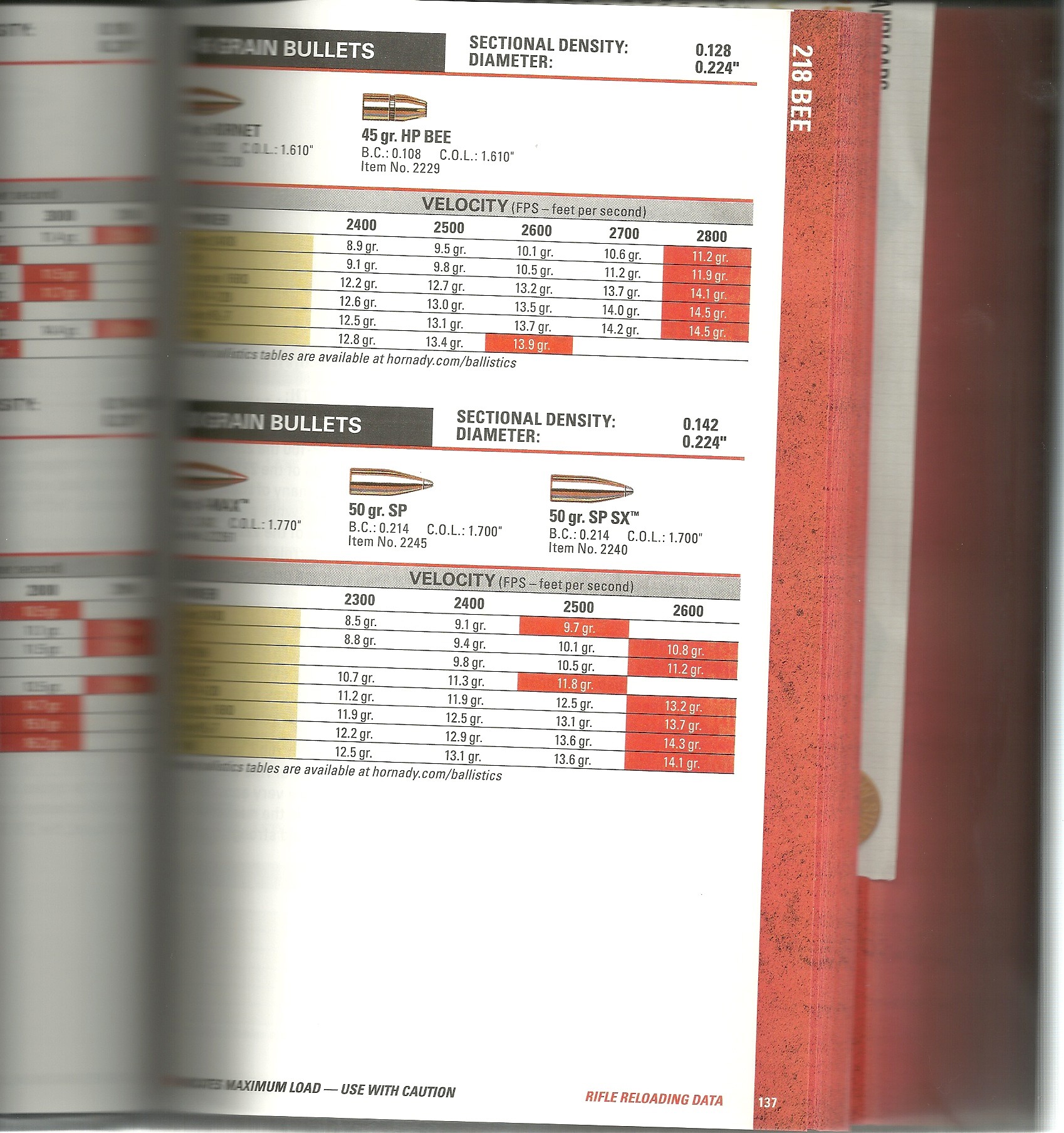

Ok guys I have a favor to ask. I am loading for 218 Bee using Hornady brass and Hornady 2229 bullet in HP Bee .224 diameter. Does anyone have the Hornady reloading book that you could send me a pic of the loading data for this combination I am using.. I think Hornady data differs from the  Lyman book I have.

Steve, I’ve scanned the page into my computer.  Next challenge is to retrieve it!  Timscan0001.jpg
Forum Posts: 1151
September 5, 2025 - 3:50 pm
Steve, due to curvature of the page in the book, powder names are blurred.  Let me recount them here, top to bottom.  Alliant 2400, H110, Accurate 1680, VIHT N-120, Alliant RL-7, H4198.  THUS, Alliant 2400 shows 8.9 gr with speed of 2400 fps.
It was easier than I feared.  May have to try more photos sometime, although I would have preferred a physically SMALLER image!  Tim

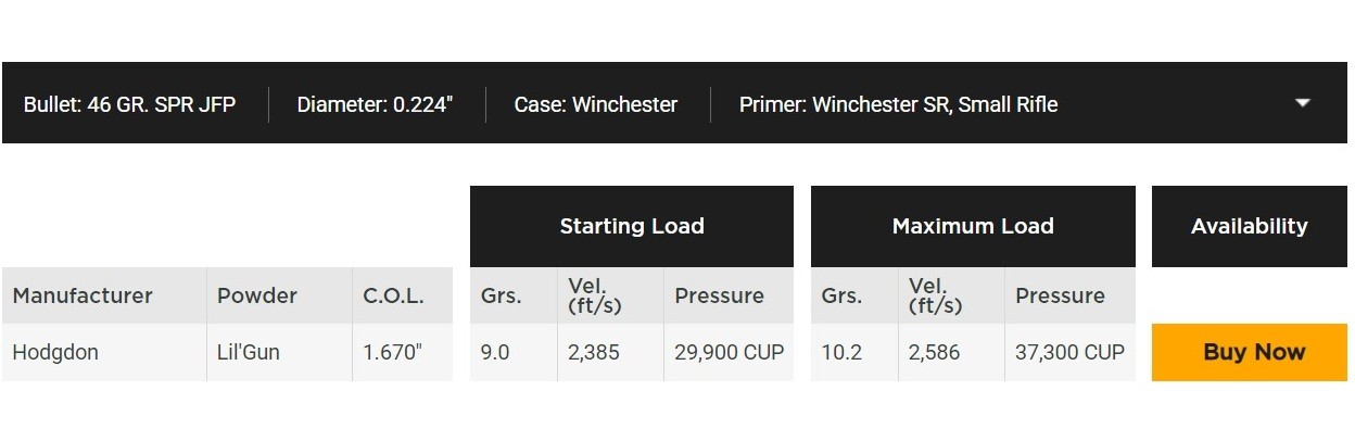

Here is the complete load data from my Hornady manual…
Having posted this, if I were to load for the 218 Bee today, I would use Hodgden’s Lil’Gun powder.
Forum Posts: 14976
September 5, 2025 - 5:12 pm
This is a great online reference for developing loads – Reloading Data Center – Hodgdon Reloading Data Center

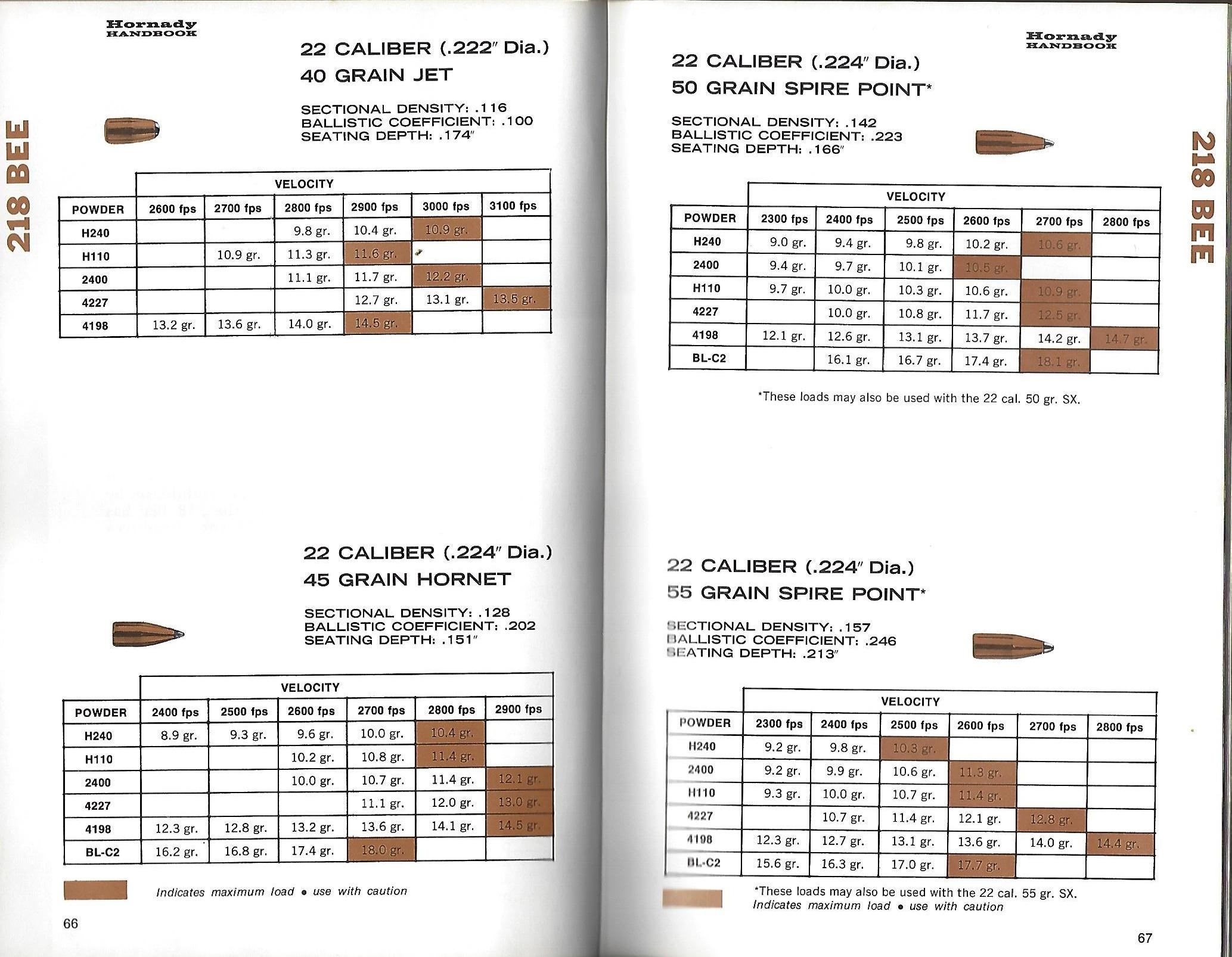

Bert, Steve asked for data for a specific bullet, which is not shown in the older manual, which is why I showed it on the one page.    Next, how did you get yours to fold so flat?  Of course the new manual is hard backed and the spine doesn’t allow really flat folding.  Tim

Tim does it say anything about IMR4227.
Forum Posts: 6931
September 5, 2025 - 8:03 pm
I have edition 10 so it may not be up to date.  There is a Version 11.  10 shows a load using IMR 4227 but with a longer heavier 50 grain bullet, not a 218 Bee bullet.  10.7 gr for 2300, 11.3 for 2400, 11.8 for MAX at 2500.  Generally using a heavier bullet requires less powder.   If you use this data with the 45 grain bullet you most likely will be a little slow by about 100 fps.   Use a low to middle load and be safe.
Forum Posts: 1151
September 6, 2025 - 6:42 am
Steve, it does not list IMR 4227 with the 45 grain bullet you specified.  The 9th edition (which I used as had your bullet listed)  DOES list IMR 4227 for every other bullet shown, which are 35 gr V MAX, 40 gr V MAX and 40 gr JET, and the 50 gr V MAX, 50 gr SP, and 50 gr SP SX.  In my experience, when a powder is left out of data for one bullet (like in this case) there is likely a good reason.  I WOULD follow their guidance.  Tim
