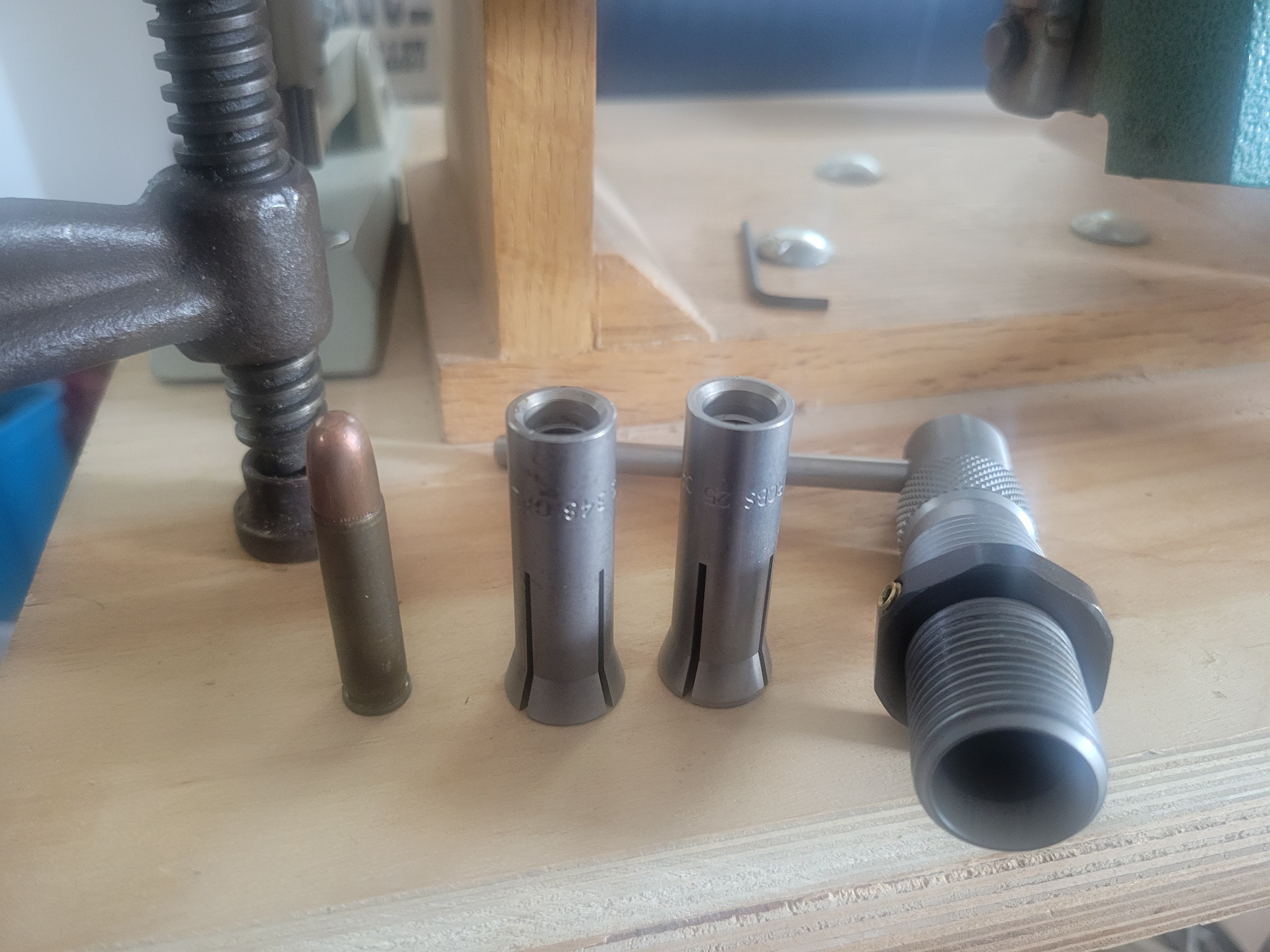

If you ever need to pull a bullet from a live .351 Winchester Self Loading round, here’s a helpful hint.  The RCBS collet puller does not have a specific collet for this caliber. The seemingly correct one is the “35/38” collet. It isn’t.
From long-ago experiences with RCBS, I foolishly thought I could call and learn whether “35” meant “.350” or “358”.   They don’t even answer their telephone.  I ordered the 35/38 anyway, hoping for the best.
The next day, as an afterthought, I decided to ask Gemini about it.  After cogitating maybe 4 seconds, the answer came back. “Don’t get the 35/38 because they mean .358 and it probably can’t get a good enough grip. If it does, it will probably score the bullet.  But RCBS makes a “348” collet that has enough leeway to receive a .351 bullet and it will work just fine.” I’m paraphrasing but that’s what Big Gem advised.
The 348 collet was a little harder to find in stock but Graf had one and I ordered it. It came today, too late to do the job because I had already pulled the bullet with the 35/38 that showed up last Friday.  Of course the 35/38 scored the bullet. Fortunately,   I was only making a dummy to test the functioning of my Model 07 so it didn’t matter.
So get the 348 collet.  And have an extra bowl of Wheaties for breakfast because Western Cartridge crimped those 351 bullets to withstand being slammed into the chamber really hard by the massive breechblock extension of the 07.  The bolt is carrying a lot of energy on the return stroke.
Forget trying to use the RCBS inertial puller “hammer”.  I have one and all you will do is distort its head. I’ve wondered whether Western applied a sealant to the bullet shank. If so, after maybe 65 years it had plenty of time to cure.

Great info, thanks for the tip!  I have destroyed several of the RCBS inertia pullers already but keep buying them because it saves me an expensive visit to the Therapist each month….

On the topic of pulling bullets from live rounds, I have been using the same Lyman kinetic bullet puller for 45+ years with no issues. I believe that I paid $2.50 for it Cool

I’ve used a couple of kinetic pullers, bought the second one when some collet parts came up missing. I’ve worn the paint off the top of a single stage press and one puller with a metal handle has acquired an odd bend. Pencils have erasers and reloaders need bullet pullers. One tip for milsurp ammo that I’ve heard but never tried was grabbing the bullet with pliers and twisting to break the sealer before pulling the bullet. This ruins the bullet, of course.
