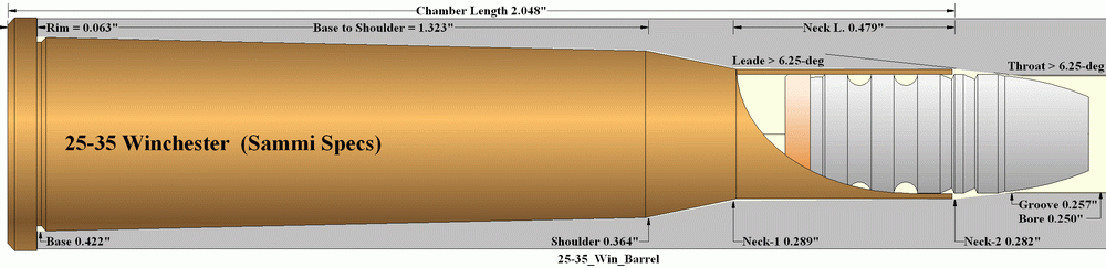

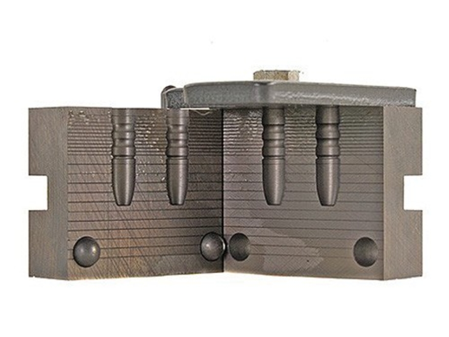

I am now thinking of casting bullet to reduce cost and wear, and the choice is between RCBS .258 100 grains and RCBS .258 120 grains mould, both with gas check.
I like the 120 grains because it is the closest in shape and weight to the original Winchester bullet, and would produce a cartridge of the same length as the manufactured one so a good fit in the chamber and the barrel. It has a long nose for good centering and a long section to catch the groove.  But first problem is it is a soft point not a flat nose, and second problem is it doesn’t have a crimp groove. I have attached a good drawing of it.
The 100 grains is obviously shorter, and would produce a cartidge 0.1 inches shorter than the manufactured one (the length of the nose in front of the crimp groove is 0.4 inch). The shorter nose may not be well introduced inside the barrel when the cartidge is in the chamber. Advantage are it is flat point and it has a crimp groove. I have attached a picture of the mould.
I would very much apreciate your advise on the best choice of cast bullet for best accuracy with this 25-35. I need to take in consideration that cast bullet can’t go as fast as the original 2200 ft/sec, so I worry that a lighter, shorter and slower bullet may not stabilize well in the barrel and its fast 1:8 twist rate.

Yes, I’m a Cast Boolit member and can assure you we have a few members who can help. We even have a few members in France who may be able to give him some hands-on help. I think he’s on the right track with the 100gr RCBS mould but I don’t load the 25-35…yet. The 120 gr bullet looks like it was designed for a bolt gun.

The standard bullet weight for the 25-35 WCF was 117-grains.  I corresponded with Francois and recommended that he try both bullet weights with varying powder types and charges.  My choice would be to start with the 120-grain bullet.

I do not believe that he does.  He indicated that he had manufactured bullets in the two weights previously mentioned.  Of the two, the 120-grain bullet would be my choice, as it is just 3-grains heavier than standard.
