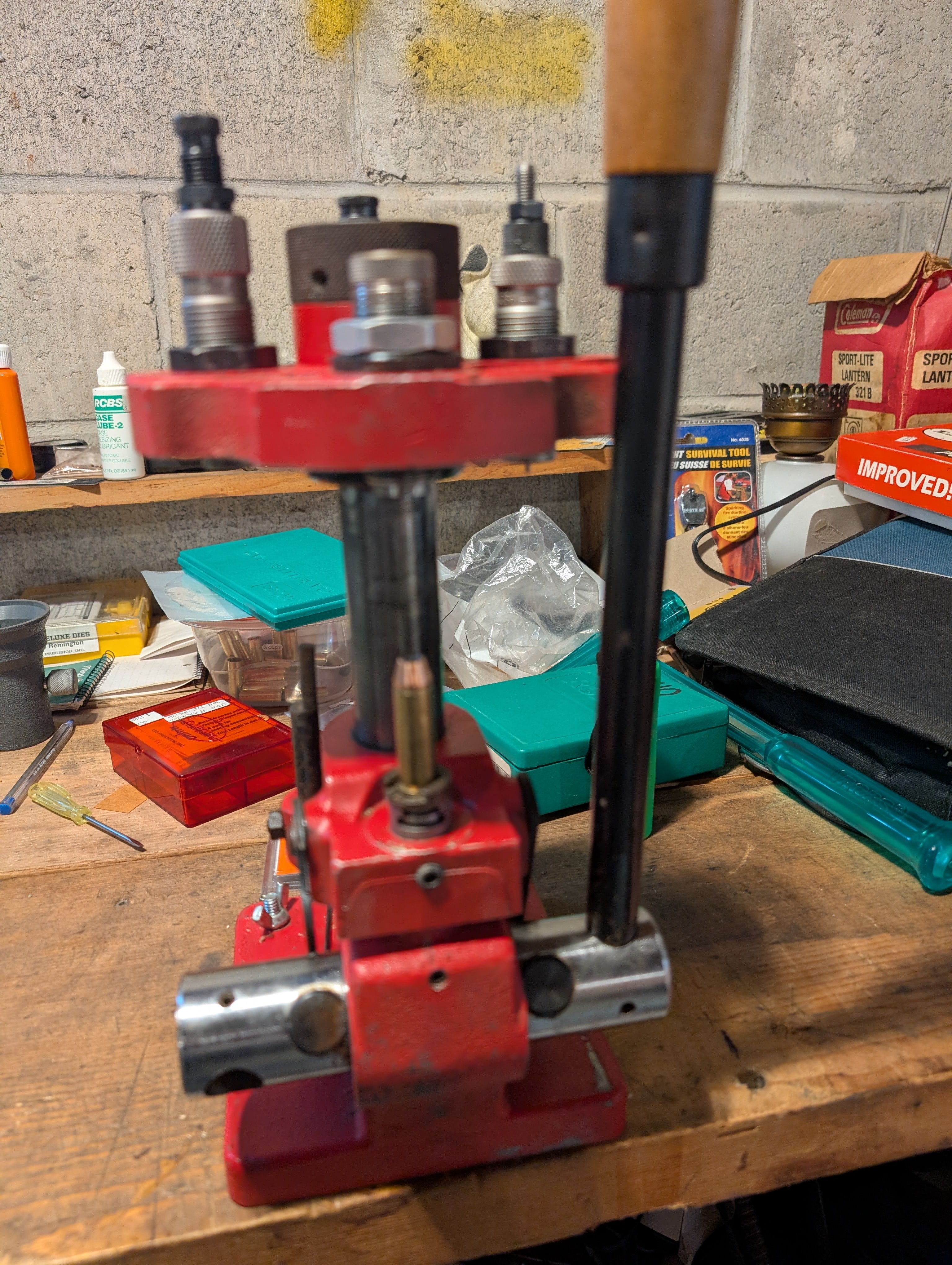

After having this old Lyman American press for about 15 years sitting in a box it was time to get it out and start reloading. 44-40 ammo in Canada is hard to come by but I have lots of brass and bullets. I’m using 17 grains of 5744 powder topped with a 200 grain XTP .430 Dia bullet. I’m getting good patterns out of all my rifles with this load. I have a 1st model 1873 rifle, 3rd model 1873 SRC, a 92 SRC and a Marlin 1889 and just picked up a 94 in 44-40 a week or so ago but haven’t gotten it out shooting yet but will very soon. I’m told this old press is dated back to the 60 or early 70s and fairly collectable now as well. Glad I can save some money reloading for the old girls !

Good job! I’ve been loading over 40 years and I’m pretty sure I haven’t saved a dime yet. All my savings go into equipment upgrades, dies and components for additional types of cartridges and tools you haven’t heard of yet but will someday be on your “must buy” list. That’s OK, it’s been fun! Loading manuals are your best friend, pick a new one up every year or so.
Enjoy!

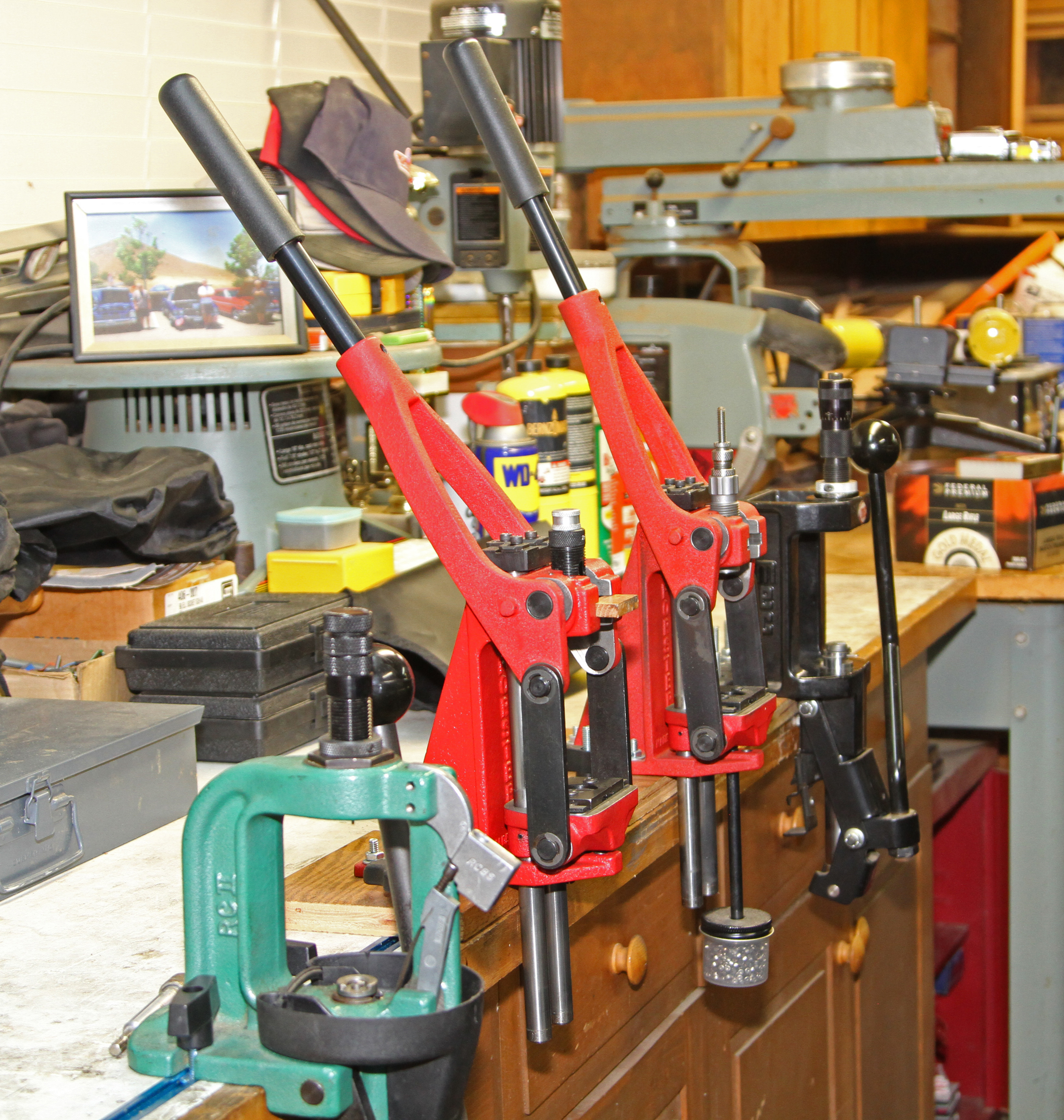

Same here.  I have upgraded my loading equipment many times over the years.  I still have my Rock Crusher but I have 3 other presses now too.

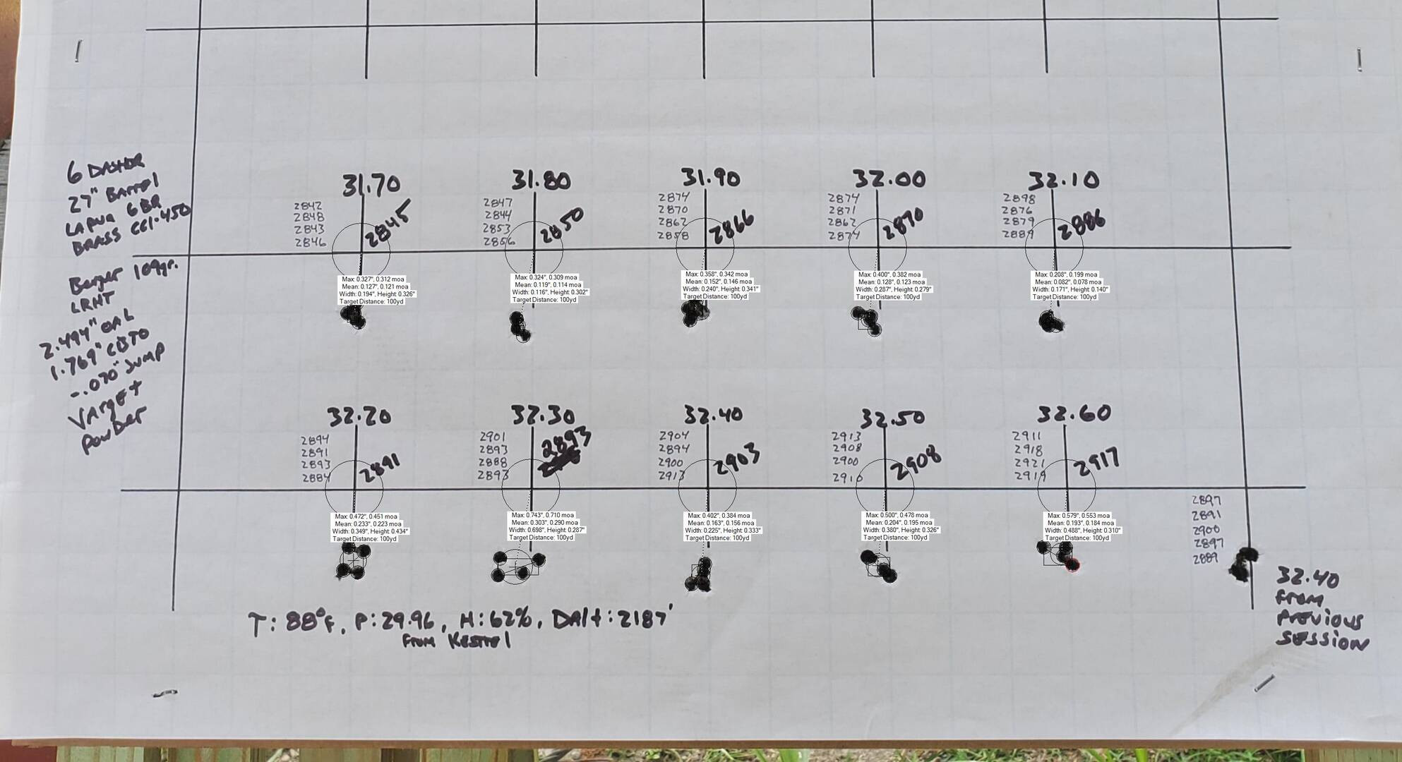

Here is a graph that really doesn’t help much.  He also has 3 more different graphs of the same shots.  I do not believe in this much work especially when you don’t end up with usable data after firing so many shots.  His charges are too close to each other and he doesn’t state the average fps for each group.  The couple things it does show it that on the top line all the groups are hitting in the same area and not bouncing around.  The bottom line went to heck.
31.7 is a good group and so is 32.1 and if the average for each groups is close to the same fps I’d test in the middle at 31.9.  But the math does not work out.
31.7 ave is 2844 and 32.1 is 2885 a difference of  41 fps.  This is too much and won’t produce good groups over time.
31.7 ave is 2844 and 31.9 ave is 2866 a difference of 22 fps.  Still way to much to be a node.
These are nice looking groups but aren’t sustainable.   I’ll look for a better graph.

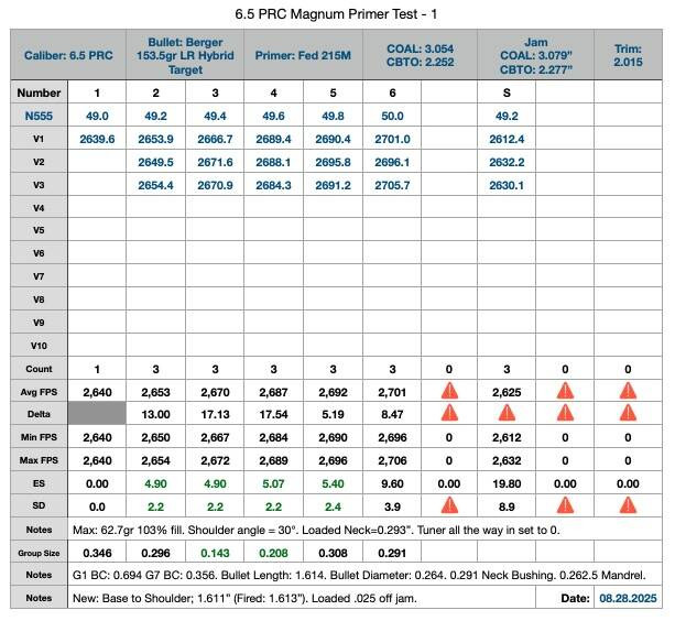

Here is another example.  Better but not perfect.
Look at the fps delta between groups 4 to 5 and 5 to 6.  Less than 10 fps in each case.  Even 4 to 6 is only 14 fps.  Testing these could get you long term performance.
