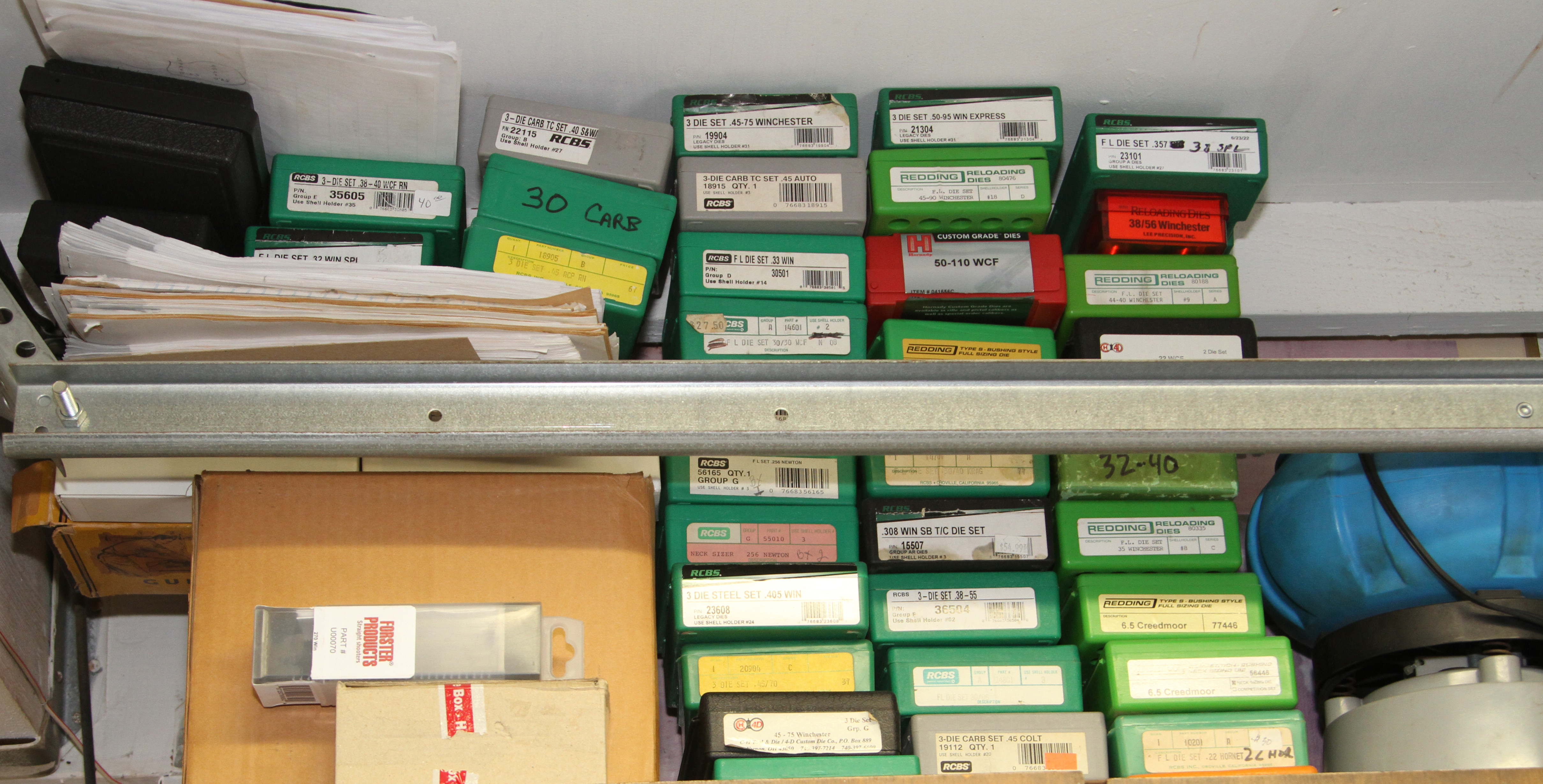

You are right.  Maybe a shim under the top plate edges?  I have no idea if our rimmed cartridges were ever considered when this press was designed?  Most of my older Winchester calibers were loaded with the RCBS Rockchucker before I bought the Co Ax. So I mostly use the RC since the dies are already set up.  Here is a picture of most of my dies and the log books.

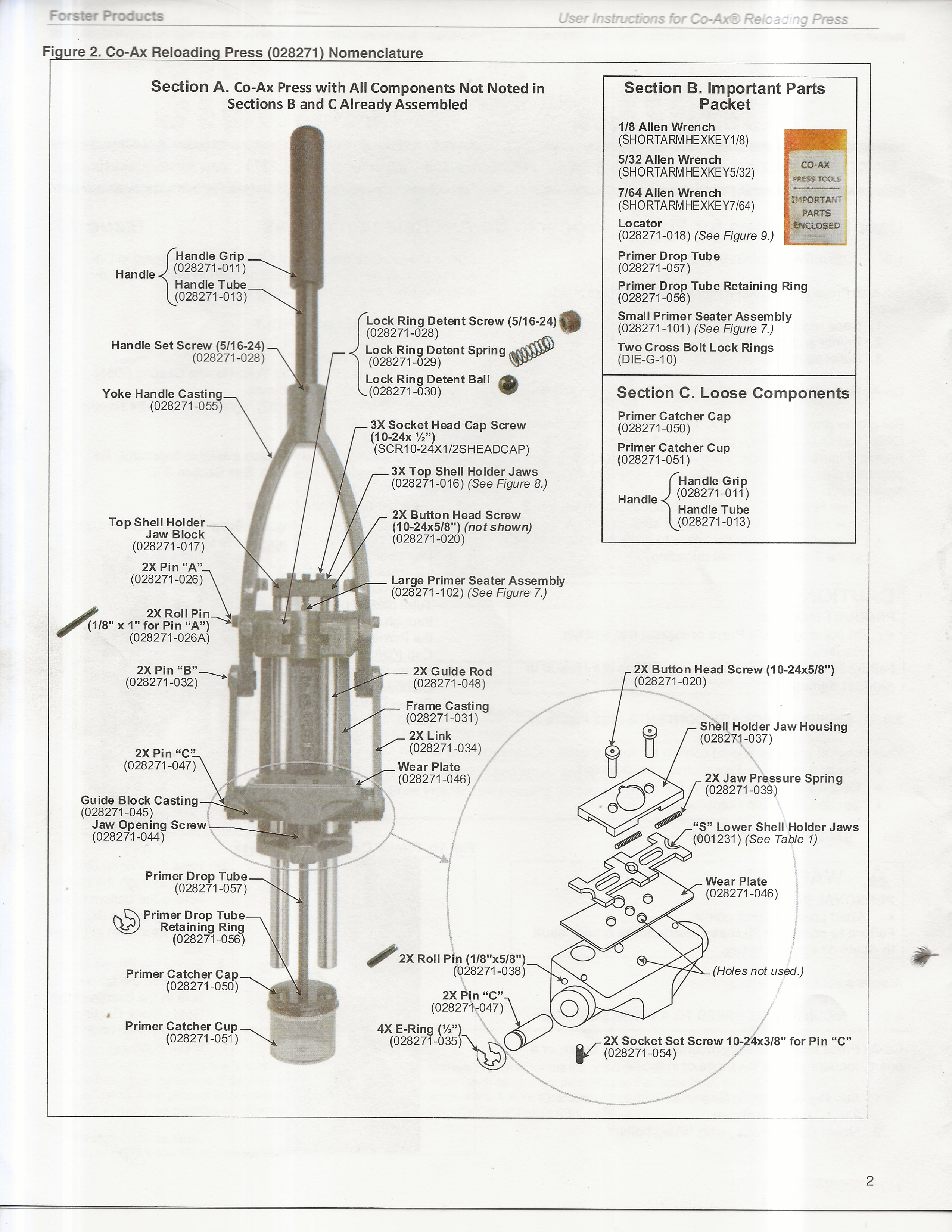

Just out of curiosity when you put your jaws in place do you have the spring side in the front or in the back?? Meaning does the sharp pin open them with springs in the back or front

Without taking one apart I’d just be guessing.  I have 3 different style top plates.  Take a look at this diagram.  It appears the springs go in the front.Forester.jpg
