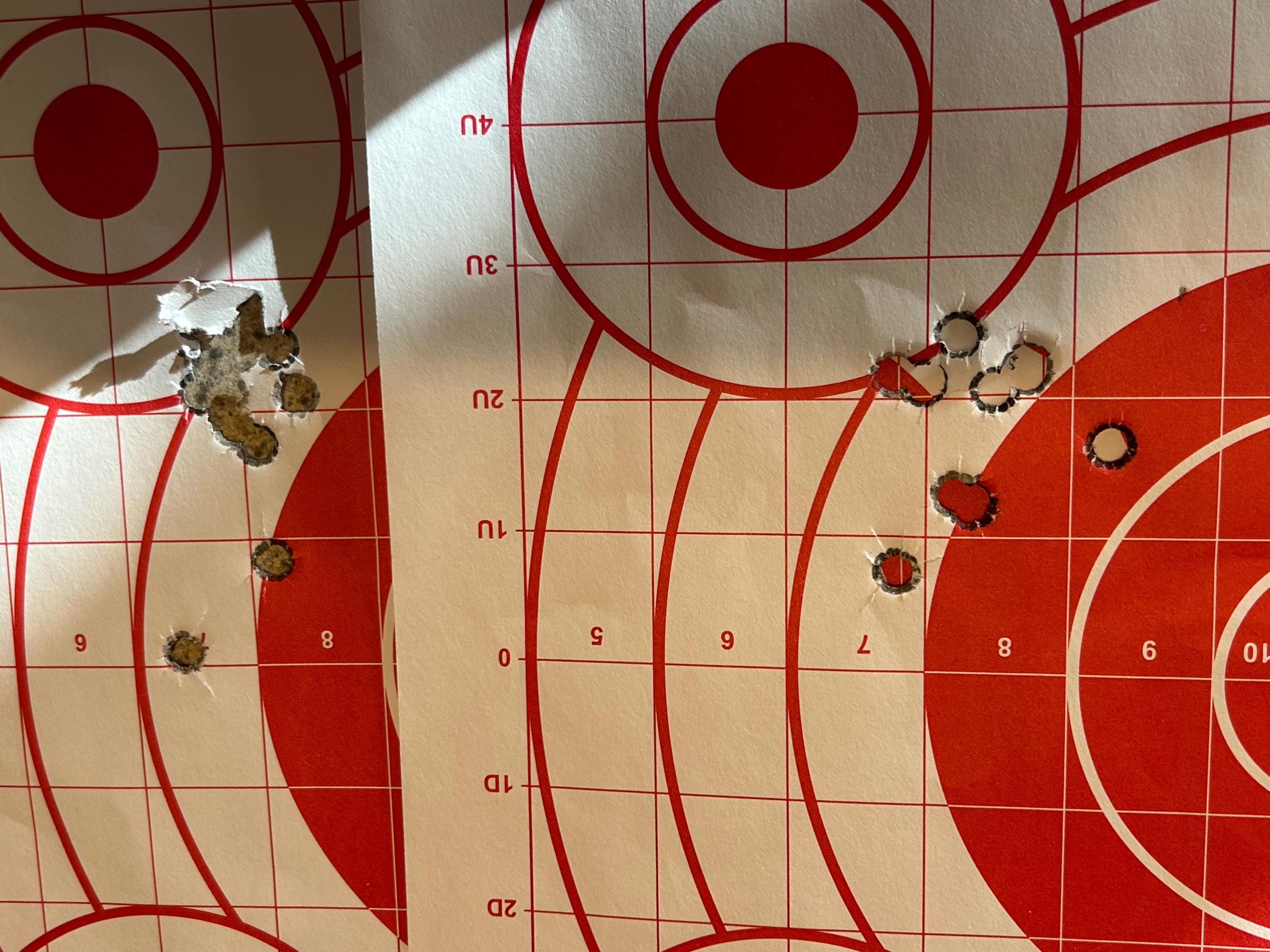

Chuck-
I have some crow to eat but I think I’ll be able to get it down. I felt reloading the 38-55 cartridge did not work-harden the case necks enough to merit annealing. I suppose that was wishful thinking as the last thing I need is another gadget to improve my reloads. I dug out some new Hornady brass and as it was towards minimum dimensions I fired some jacketed 220gr Hornady bullets and some softer .377 cast Lyman 375449 bulletsintended for the 375 Winchester in my 1894 hoping they would bump up. Big failure, haven’t tumbled a bullet @ 50 in awhile!
This gave me some fire formed once-fired cases and I loaded them with some .380” cast bullets in a couple of loads that showed promise earlier. Long story short, I’m scraping together my nickels and dimes to buy an Anneal-Rite tool 426Crown told me about. I like the somewhat automated Anneal-Ease system but I like the simplicity (and price!) of the Anneal-Right. I have about 100 38-55 cases and a similar number of 30-06 cases that need annealing and I’m pretty sure some 32-40, 32Spl and quite likely a few others could benefit from some propane therapy.
