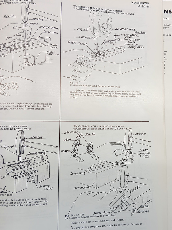

Some examples from the book I mentioned in my last reply:
