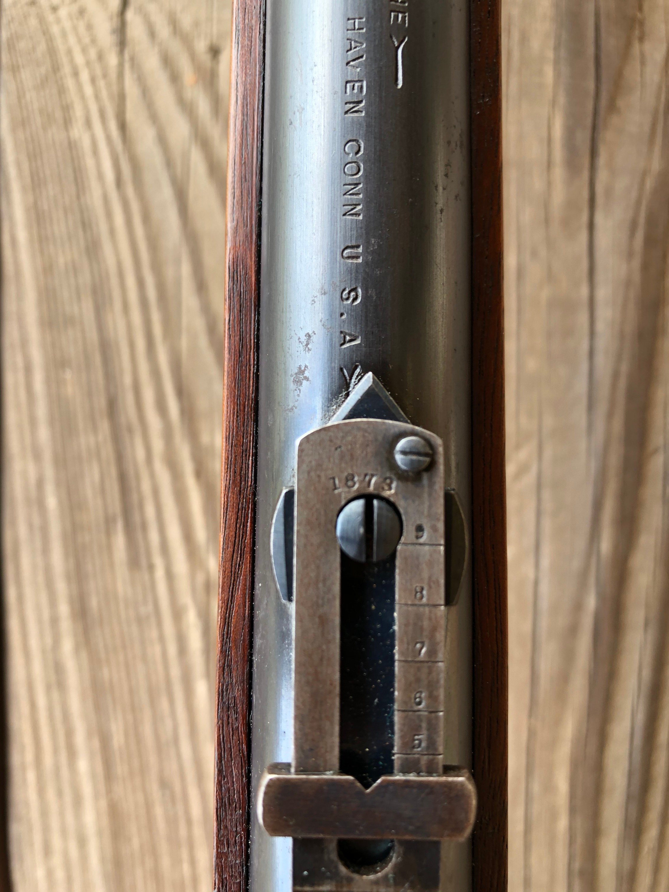

The first image shows the initial effort with 10 rounds. At 50 yards I had to set the green target field just above the front sight pin and hold the front sight VERY low in the notch of the rear sight. It basically equates to a 4 inch “under-hold” if that makes sense. This is consistent with the trajectory for the 44 WCF ammunition (see image). The notch in the sight is set for 100 yards and there is right at 3.5 inches of “rise” at 50 yards so that it is dead on at 100 yards. The rifle grouped very well but shot about 1.5 to 2 inches to the left. You can see the rear sight position relative to the barrel address stamp.
Feeling pretty good, but not wanting to have to compensate for the left deflection I decided to adjust the rear sight a bit and see if I could improve the accuracy. I tapped the sight to the right and headed back to the range area. The first two rounds were too far right (at 2 o’clock) so I tapped the sight a bit to the left and shot a second group. It fell in perfectly above the bull so I dropped my sight picture and the next three rounds were perfect. We are ready for some hogs! You can compare the rear sight position in the photos.

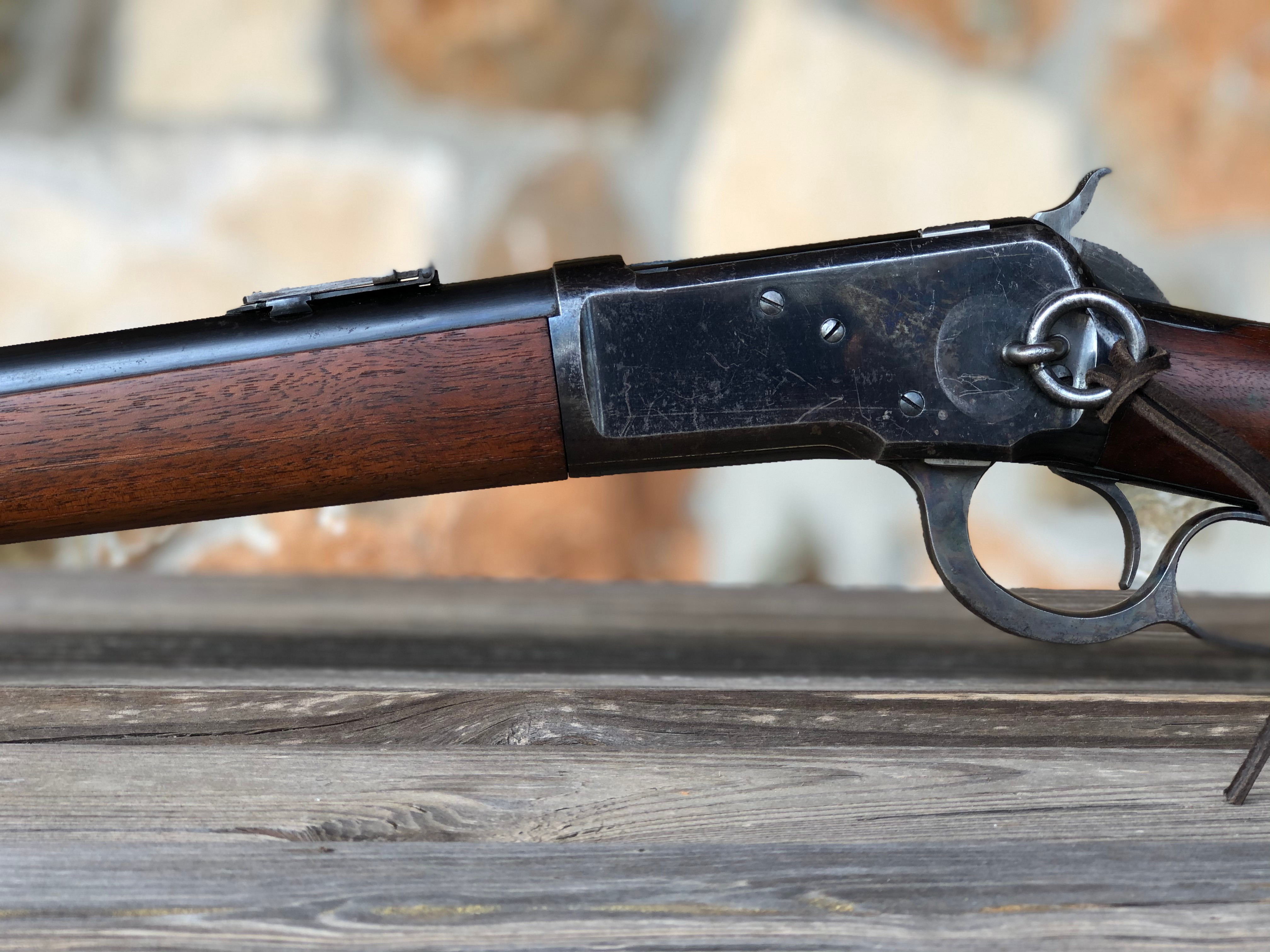

And here are a few pics of the rifle.

Hey twobit, that’s really a nice carbine. I don think many people know how rare it is to see one these ’73/’92 carbines.
Thanks so much. They are special and I am lucky enough to have two of them! SN 2635 and this one SN 6691.
