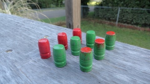

I’ve powder-coated cast bullets for many years (10?) with no different results than using lubed bullets. Very little leading if I have it covered well, and you can have fun with colors or use the colors to indicate different loads of the same cartridge.
