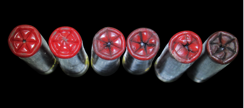

Using a high-quality hull helps.  I’ve settled on Winchester AA because the crimp appearance is always better and case life is always longer.  I won’t even accept cheap empties for free.  They’re not worth the trouble.
I also agree with Tim.  Aligning the crimp starter with the natural crimp of the hull helps.  Another tip is to raise the shell into the crimping die very slowly.

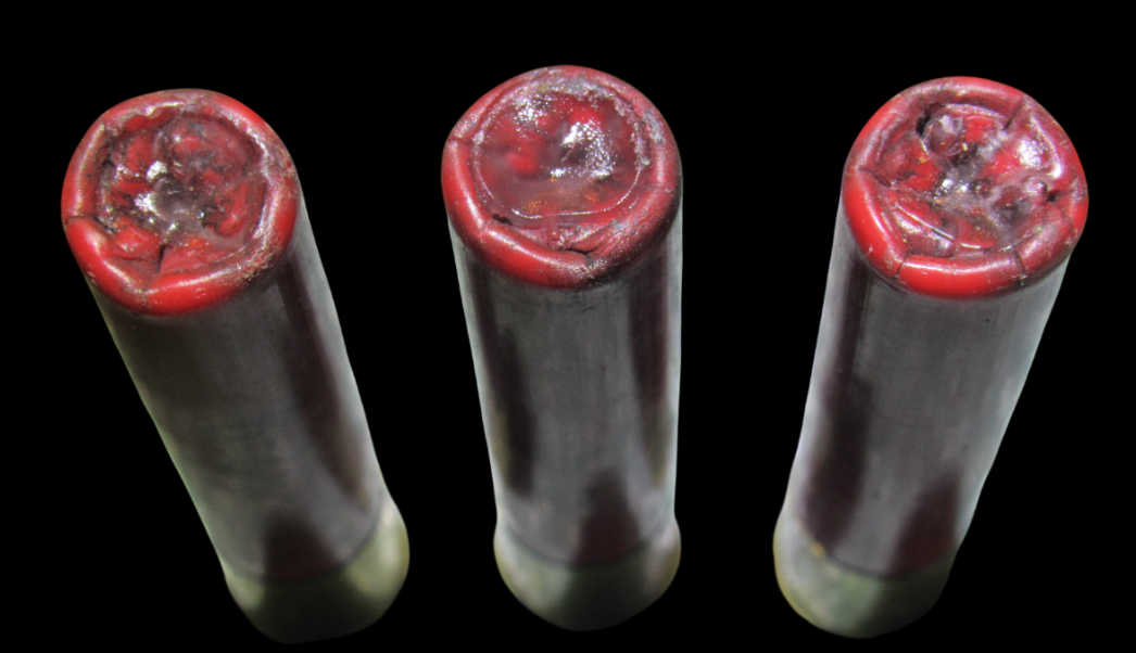

Even so, I only get 4-5 reloads out of a hull before the case mouth becomes burned and brittle.  After that, I simply accept a poor-looking crimp and place a drop of melted candle wax on the crimp to hold things together and keep shot from falling out.  This adds another 3-4 loadings to case life.
I attached a pic of how my crimps turm out.  From left to right, you have a factory load, then a once-fired reload, twice-fired, three times, four times and five.  The second pic shows some reloads with a wax job.  I dunno how many times they’ve been fired.
