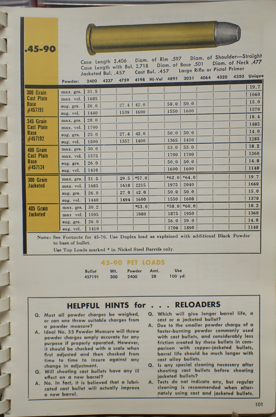

Hi–anyone loading H4895? for 45-90  need a starting load–Thanks Bill
Forum Posts: 2533
June 23, 2026 - 8:13 pm

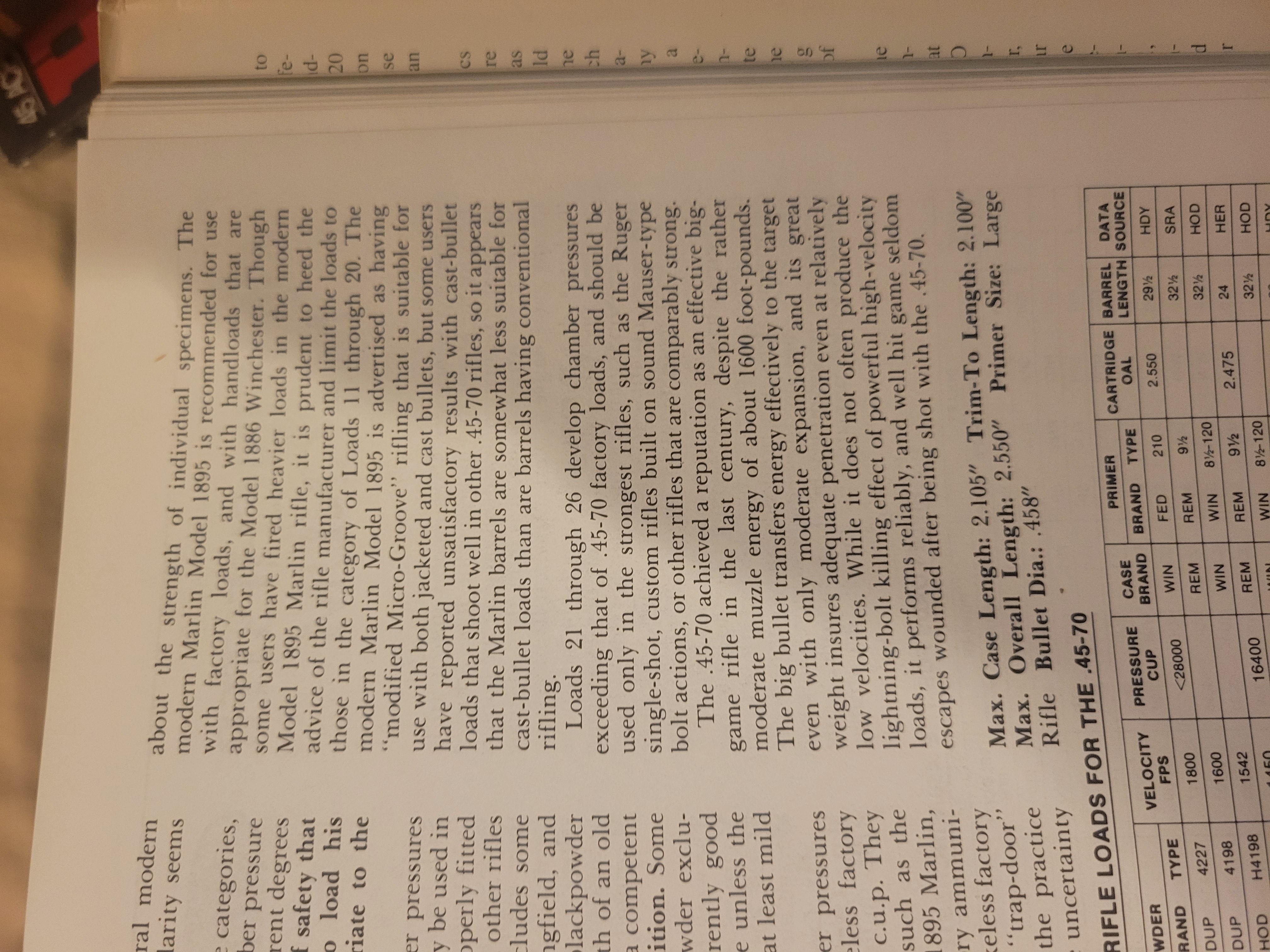

Hey, Bill.  As close as I can get with 4895 so far is a page out of the 1957 edition of the NRA book, Handloading, a copy of which I picked up at Half Price Books on Sunday.

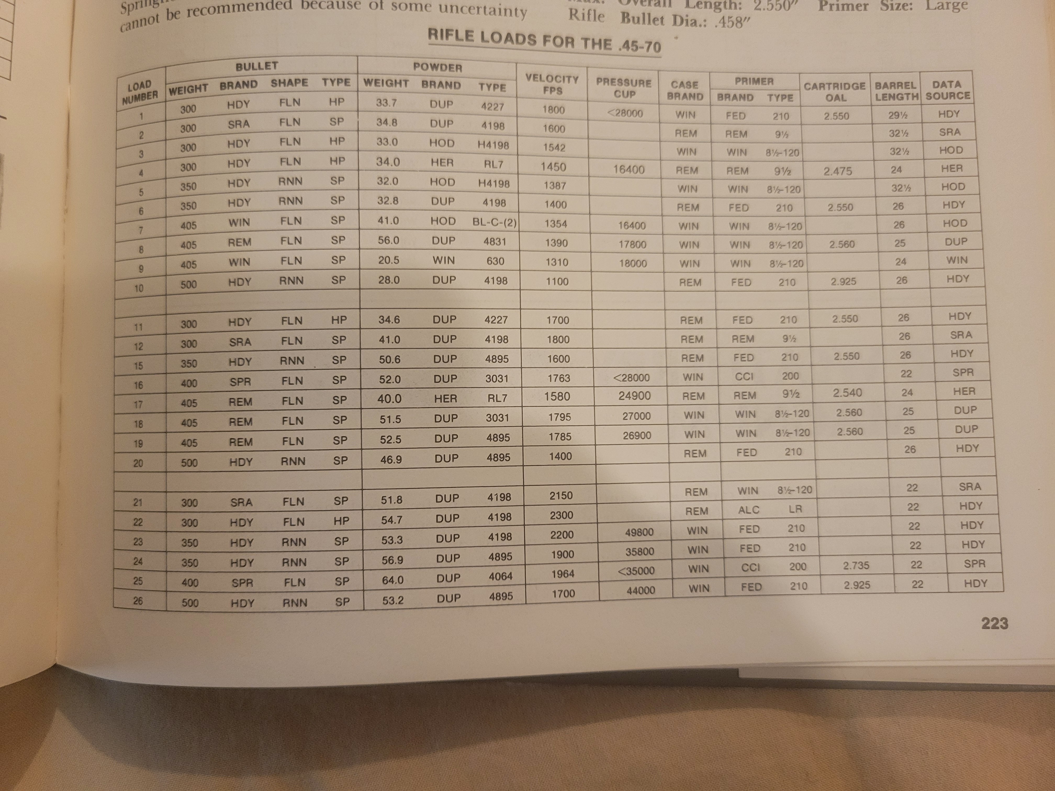

It doesn’t have a section on 45-90 but does have one on 45-70. I’ve attached a copy.
Note that the loads are for Dupont, not Hodgdon. In a minute I’ll check Lyman’s Cast Bullet volume and two of Venturino’s books. If I find anything more, I’ll send it. 20260623_150228.jpg

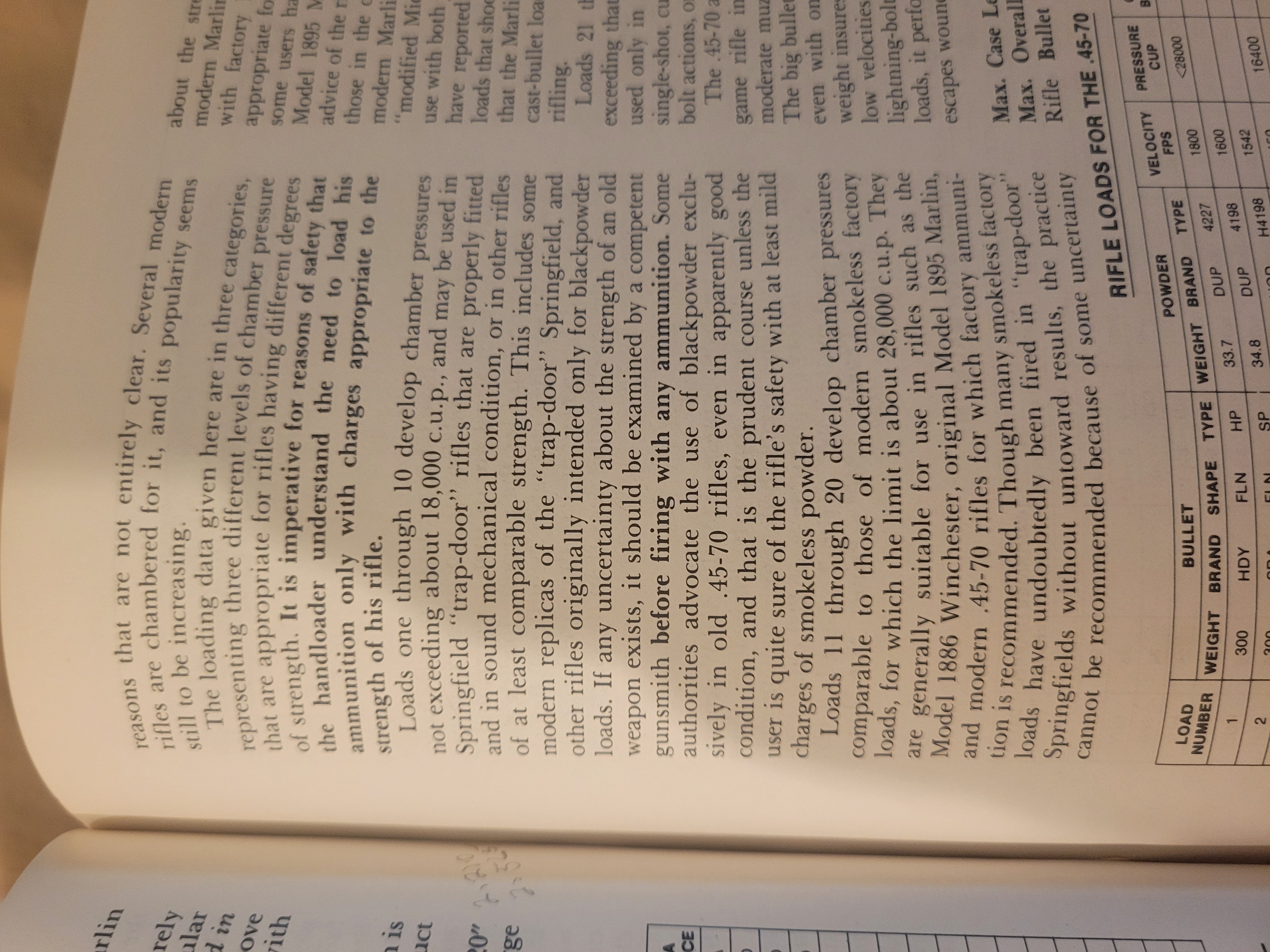

CAUTION –  some of the numbered loads in the NRA chart are too hot for vintage arms. I’ve attached the text that classifies them. The first category is for trapdoors, the second for 1886s in good condition, and the third for intrepid owners of the Ruger #1 etc. 20260623_152132.jpg20260623_152126.jpg

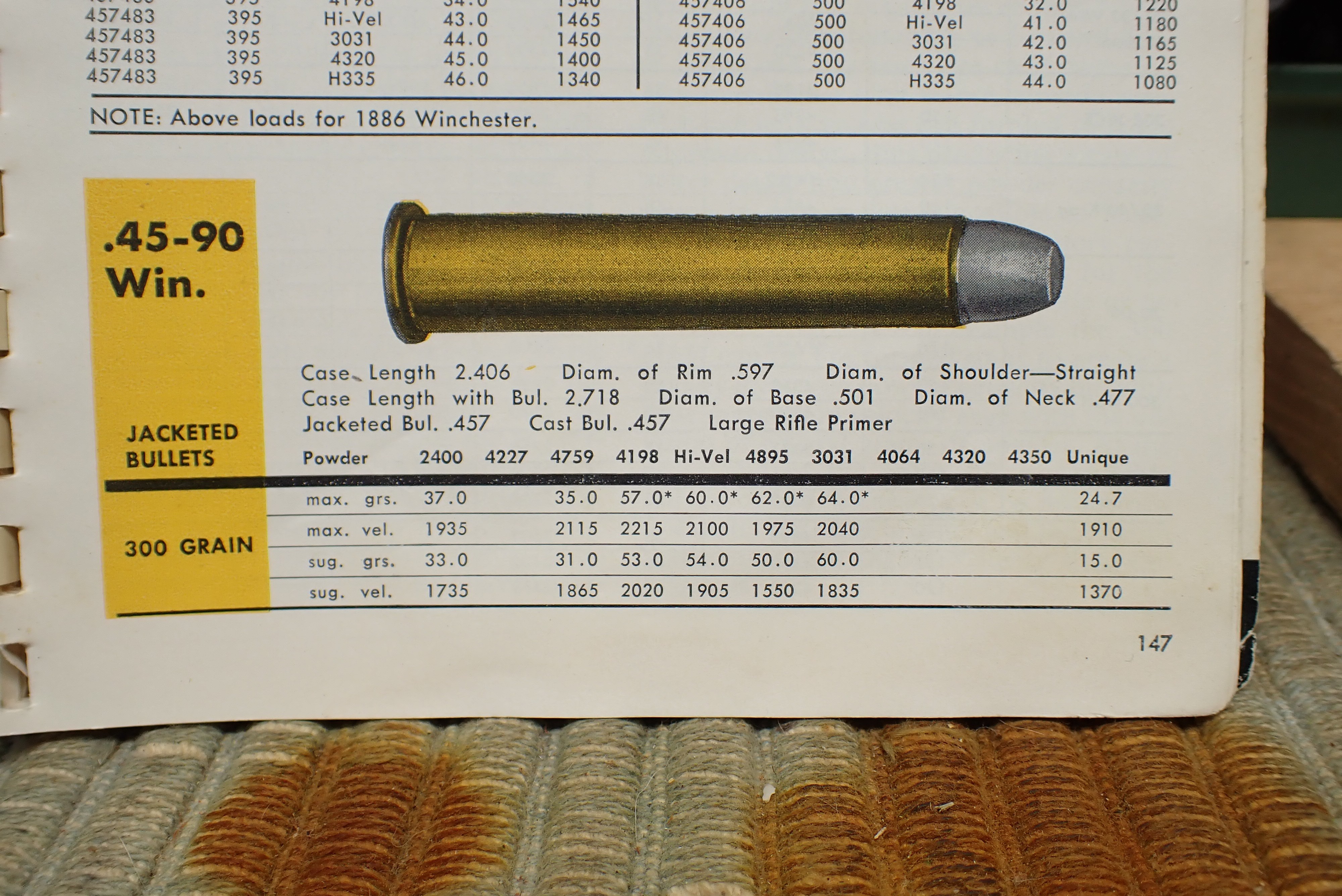

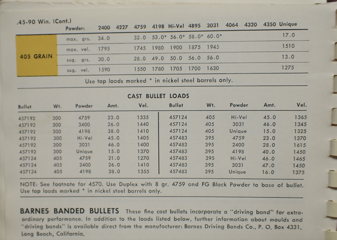

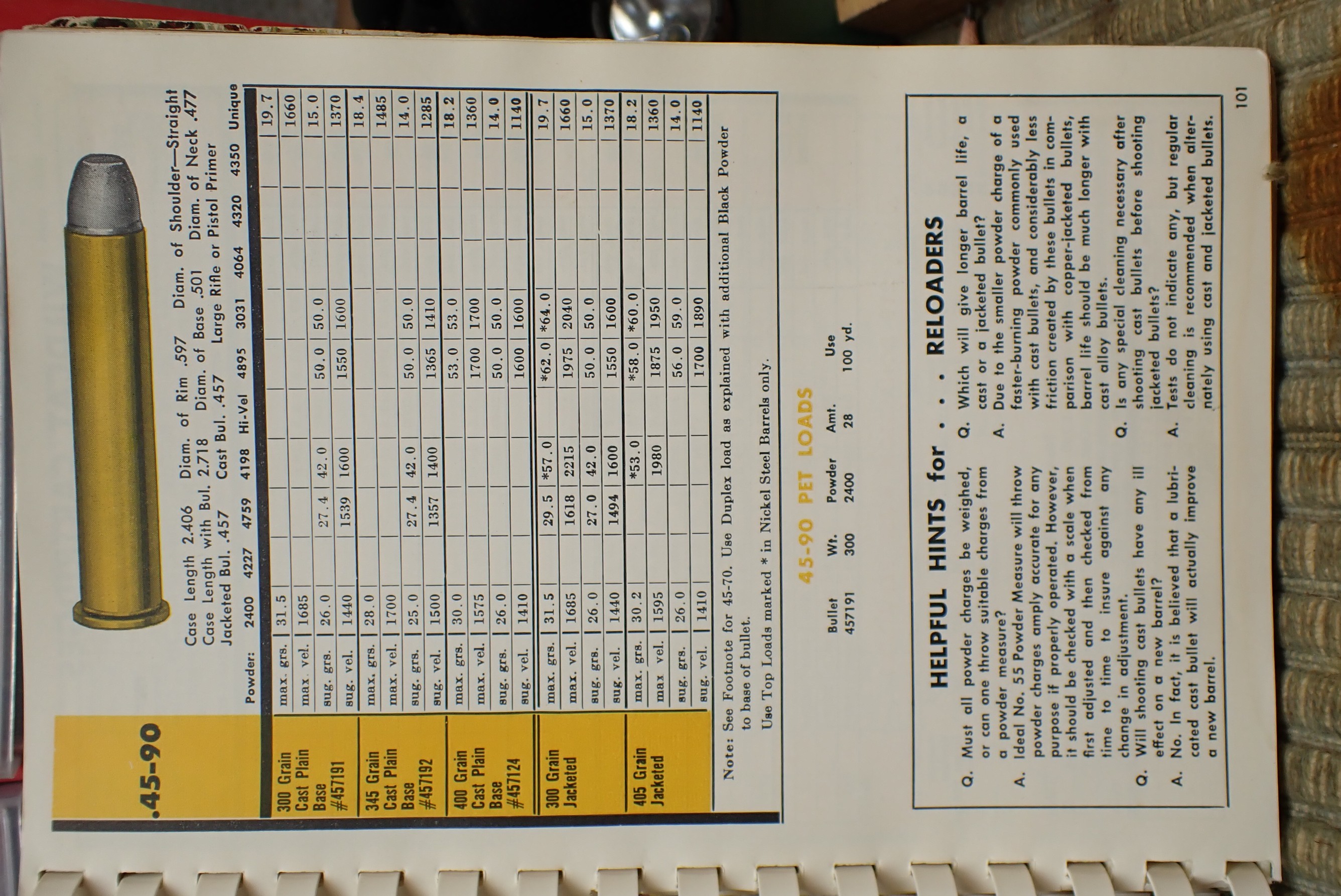

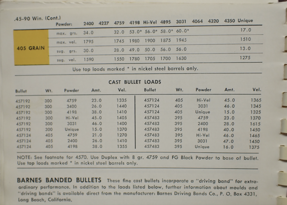

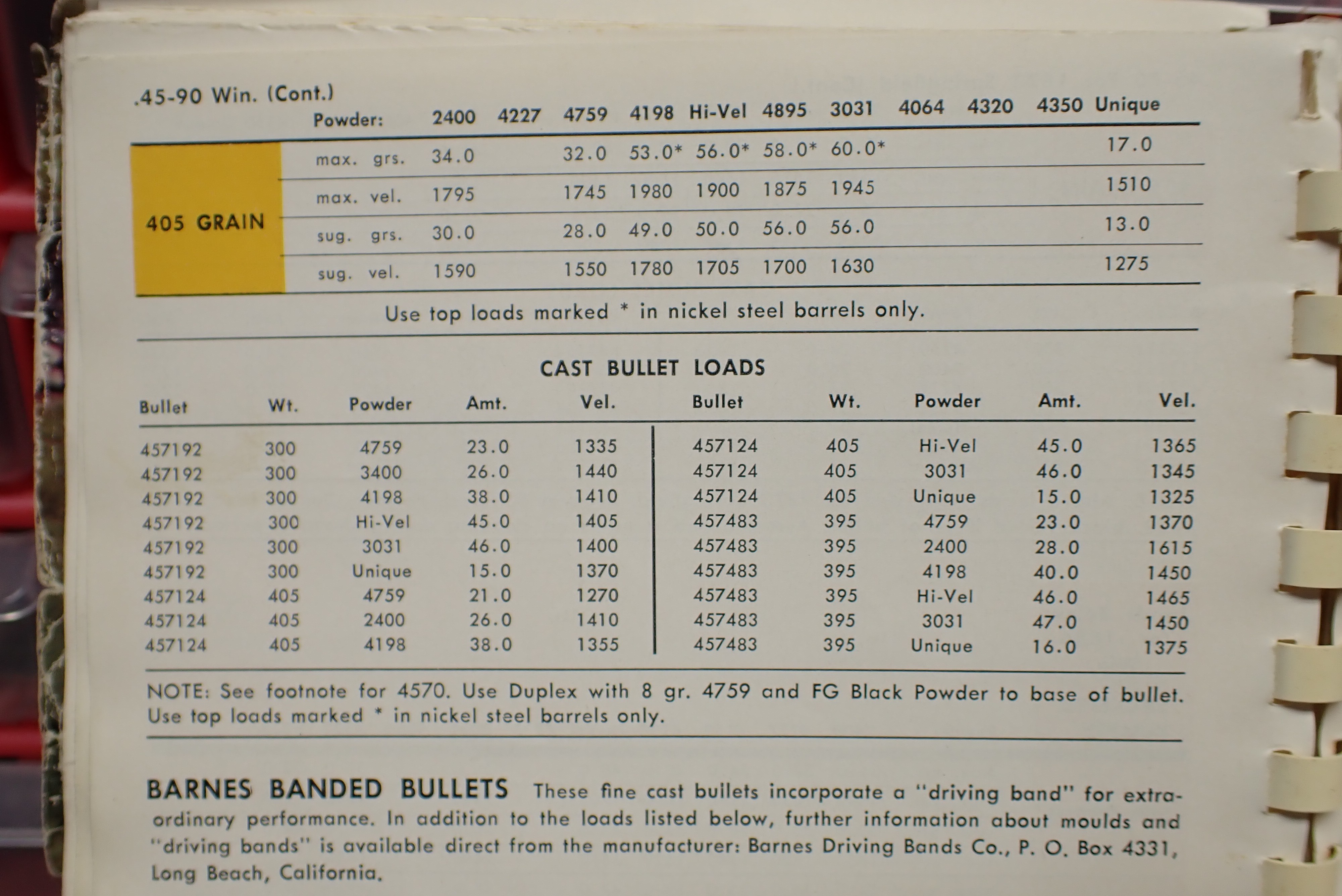

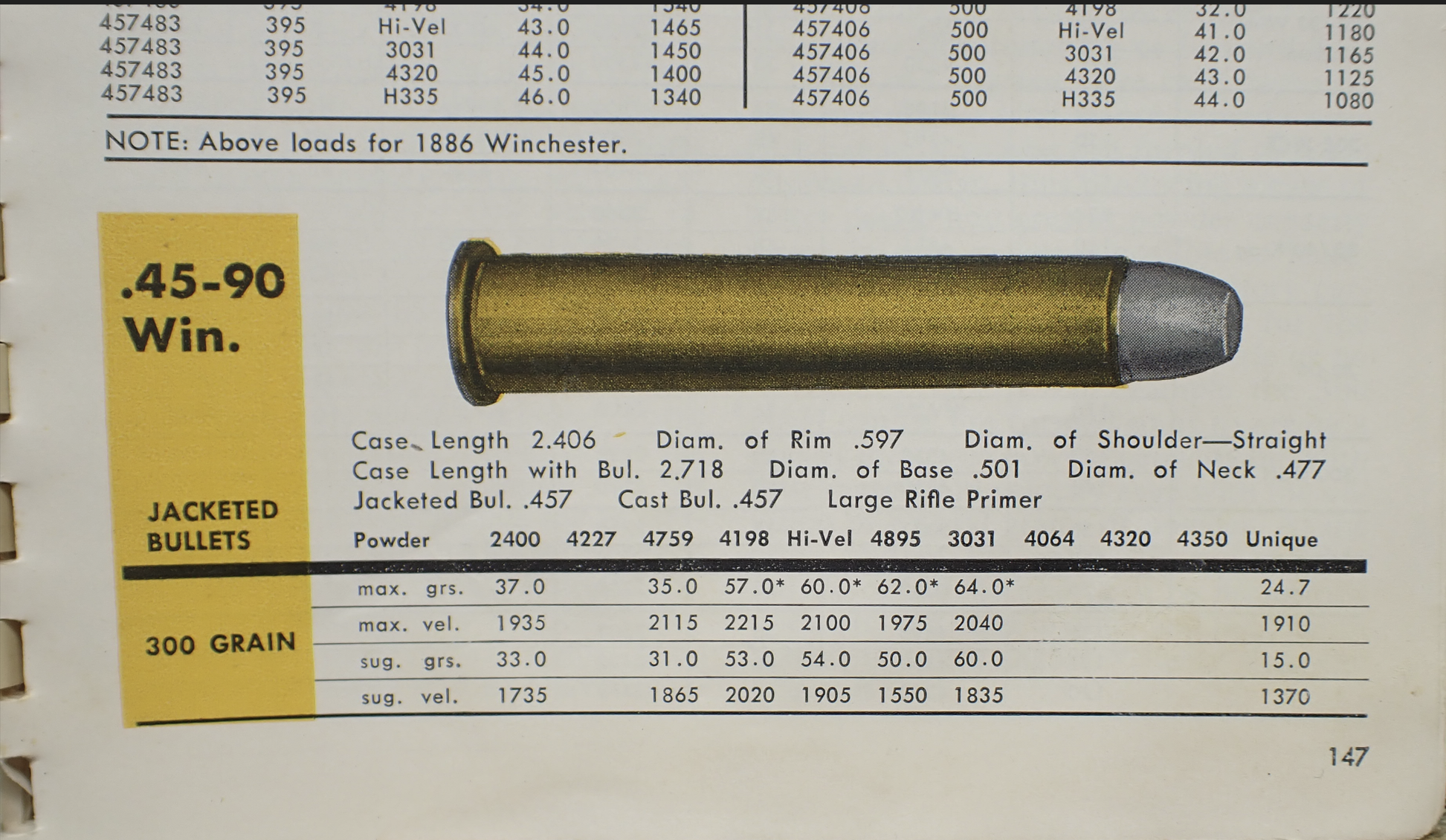

Here is some Lyman data (Catalogue 41/42).  Sorry for the image size, tried to resize with not great results.  The thumbnail feature appears to no longer working.
