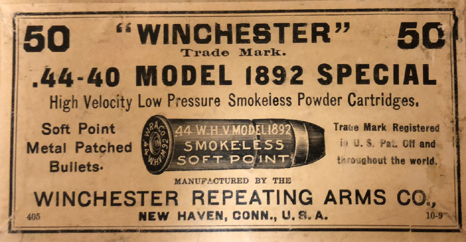

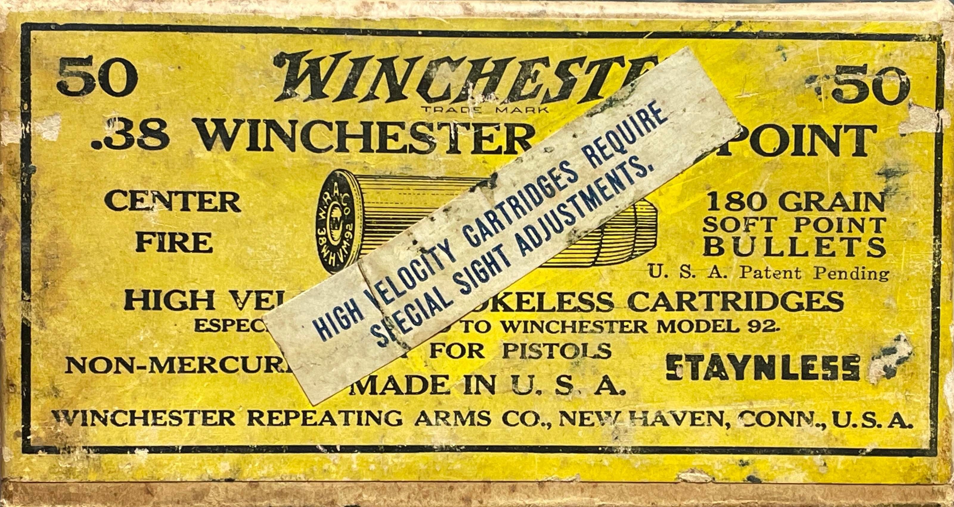

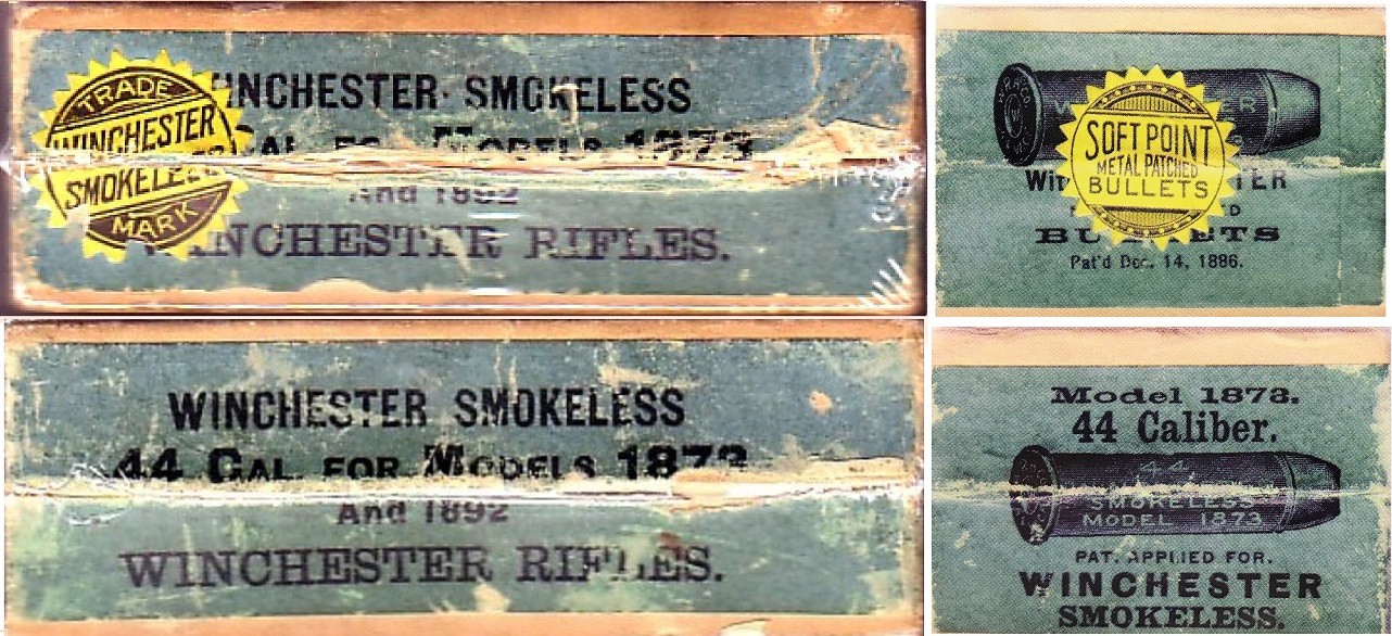

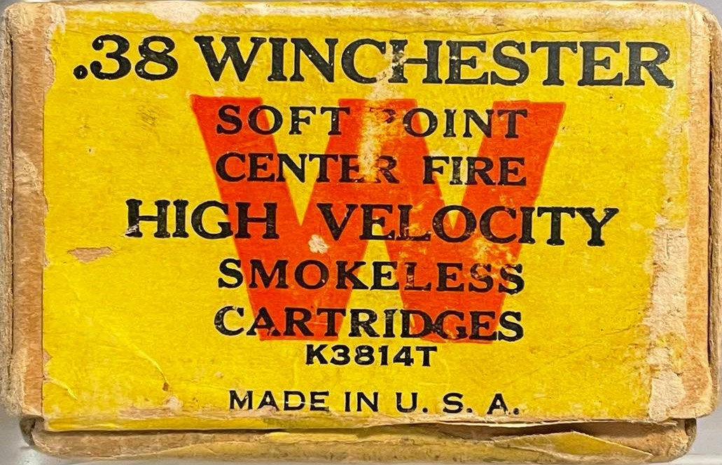

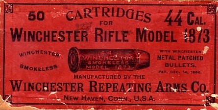

June 9, 2025 - 1:08 am
Julian Brachfeld said
I personally would not use any smokeless in black powder only firearms.
Here we go again! A Model 92 is not a black powder only rifle….geeesh
The Winchester 73′ used smokeless powder by 1895…ALL 73/92 RIFLES…Winchester never said not to use smokeless in older than xxxx dated rifles.
The High Velocity loads were manufactured ESPECIALLY for the Model 92′ rifles, all years!
322676336_717371856677869_761113346653805781_n.jpg322676345_475615494648189_5340814945703496616_n.jpg121011614_390570698778689_3573194418269197475_n.pngSidesEnds.jpg1895-TOP.jpgIMG_3431.JPG
Forum Posts: 2020
June 9, 2025 - 12:23 pm
Once again, a great tutorial, Bryan! Smile
