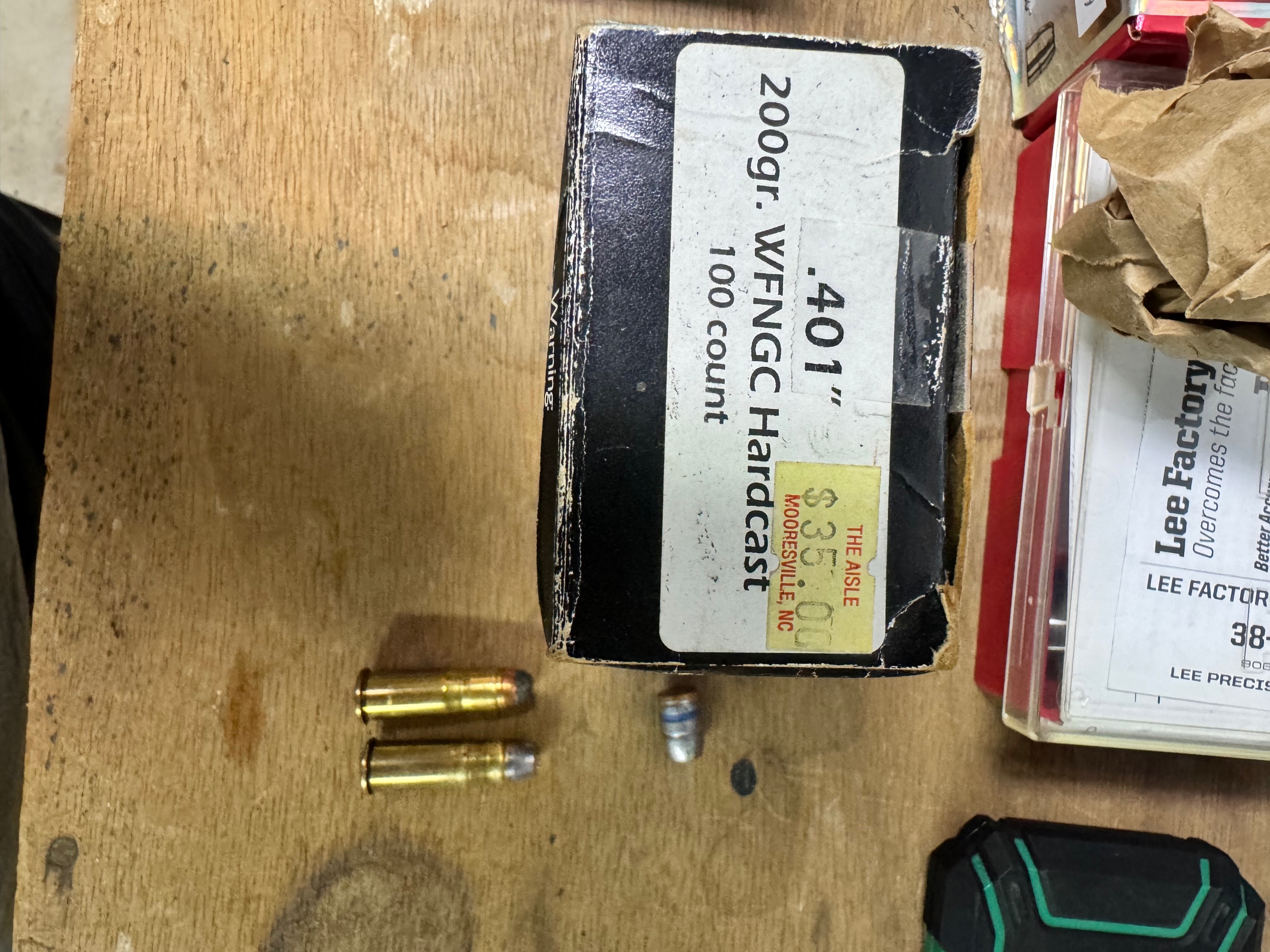

IMG_3462.jpegHave finally got around to reloading some 38-40 rounds for my 73s and 92s. Have reloaded a lot of 44-40 and my favorite powder has been reloader 7. Hard to find but lucked up finding a good bit at a shop with good reloading supplies that was some what local. Have not found much other data from people with reloader 7 for the 38 as a I did the 44 but my general thoughts would be if it works great as a full capacity powder for the 44 it should in the 38 right? Normally loaded my 44-40s around 24-25 grains with a 200 grain projectile, have a good supply of 200 grain hardcast bullets with gas checks and was going to use those as my main projectile.

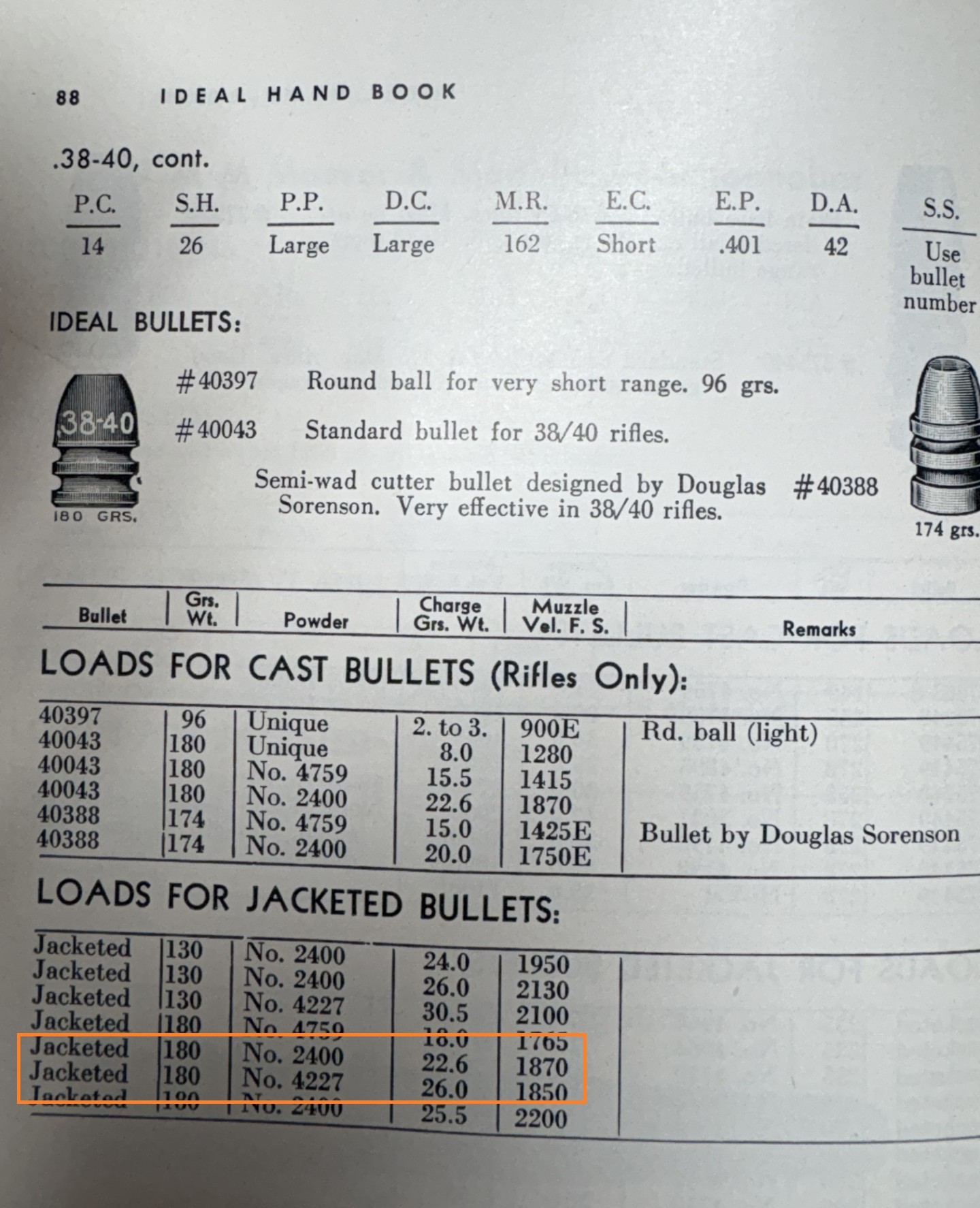

Just a few months ago I loaded up to two 50-round batches of 38 WCF (for my 1917 production Single Shot high-wall rifle).  I chose the Hornady 180-gr XTP bullet, WLP primers and 22.0 grains of A2400 for the first batch, and 26.0 grains of IMR 4227 for the second batch.
Both loads should very closely approximate the original Winchester W.H.V. factory load, but I may see a bit higher velocity out of the 30-inch barrel on my old high-wall rifle.  I chose the loads from the old Ideal Handloading book.

No, they do not have a cannelure.  I simply set my seating die to 1.595″ OAL and a very light crimp (very little crimp is required in a Single Shot rifle).

I suspect that my loads are way too hot for a Model 1873 (or an old Colt revolver), but they would be perfectly fine in a Model 1892, especially a 1920 production Model 92.

I suspect the RL7 is a bit slow for optimal burn in the 38WCF but you may be onto something. A quick check of a few likely manuals didn’t turn up a load for RL7 in the 38WCF. Since the nominal bullet weight for the 38WCF is 180 I’d back off a bit from your 44WCF loads for the 200gr bullets. If you have any Unique lying about that is my go-to powder for the 38WCF, I load my 180br cast over 8grs so I’d back off a grain for a heavier 200gr bullet. I don’t push my 38WCF loads as hard as Bert does, my old 1892 is in good shape but I only dabble around with paper targets @ 50 yards. I really like the RL-7 in the 375 Winchester and a few other medium rifle loads but I think it has lost out a bit to the newer Leverevolution powder.
