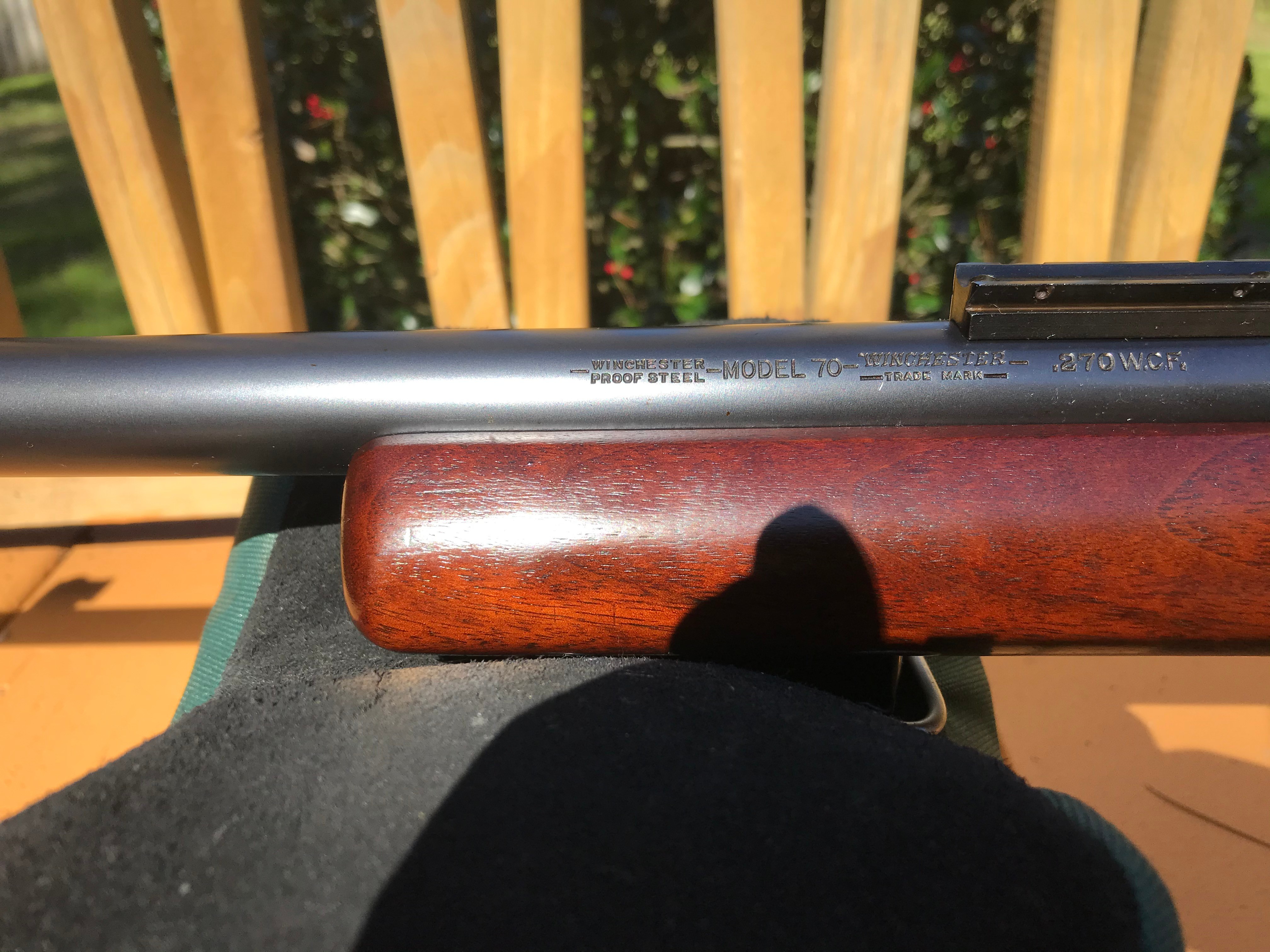

I don’t usually post photos of my recent acquisitions on WACA (probably for fear of ridiculeLaugh) but you got me inspired so I recently found this pre-war M70 target rifle in 270 WCF on GunBroker of all places.  I rarely even look at GB and hadn’t bought anything more than a box of vintage ammo from there in about 5 years.  Anyway, the rifle cleaned up rather well IMHO::
The S/N is 50628, so very close to yours…
Anyway my question…  How’s your target/accuracy load development coming?  I’m afraid my friend Tedk is going to want to give this one a “test drive” so I’d better start working on finding a load that it will like!!!Wink

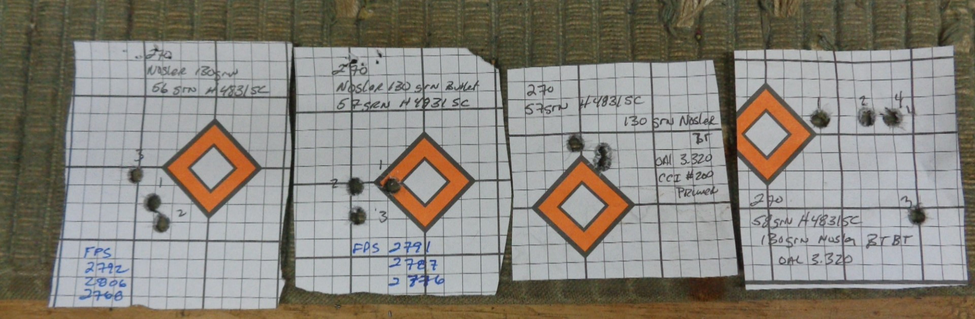

Roger, I cant speak for shooting 270 rounds through a Winchester Model 70 (dont own one yet but its on the list) but I have loaded for my Remington Model 700 in 270 that Ive had for about 40 years now.  It took a while of trial and error and advice from a friend to arrive at a load that worked for the rifle.  I tried 140 grain bullets but got inconsistent groups then switched to the 130 grain bullets and groups tightened considerably.  I tried loads using IMR 4350 and H4831SC finding the H4831SC grouped the best for my rifle.  The targets below where shot at 100 yards and are for different H4831SC loads tried using a CCI large rifle primer (#200) and Nosler 130 grain ballistic tip bullet.  Loaded to 3.320″ OACL.  Maybe give you something to follow up on in the loading data available before you try.  Im a fan of Nosler bullets for all my modern rifle loads for target and game.  Wasnt a fan of their accubond bullets though.  Also, take a look at the Nosler website for load data to accompany their bullets to find a fit for your rifle.  Thats where I started for my 270 and 7MM Rem Mag.
