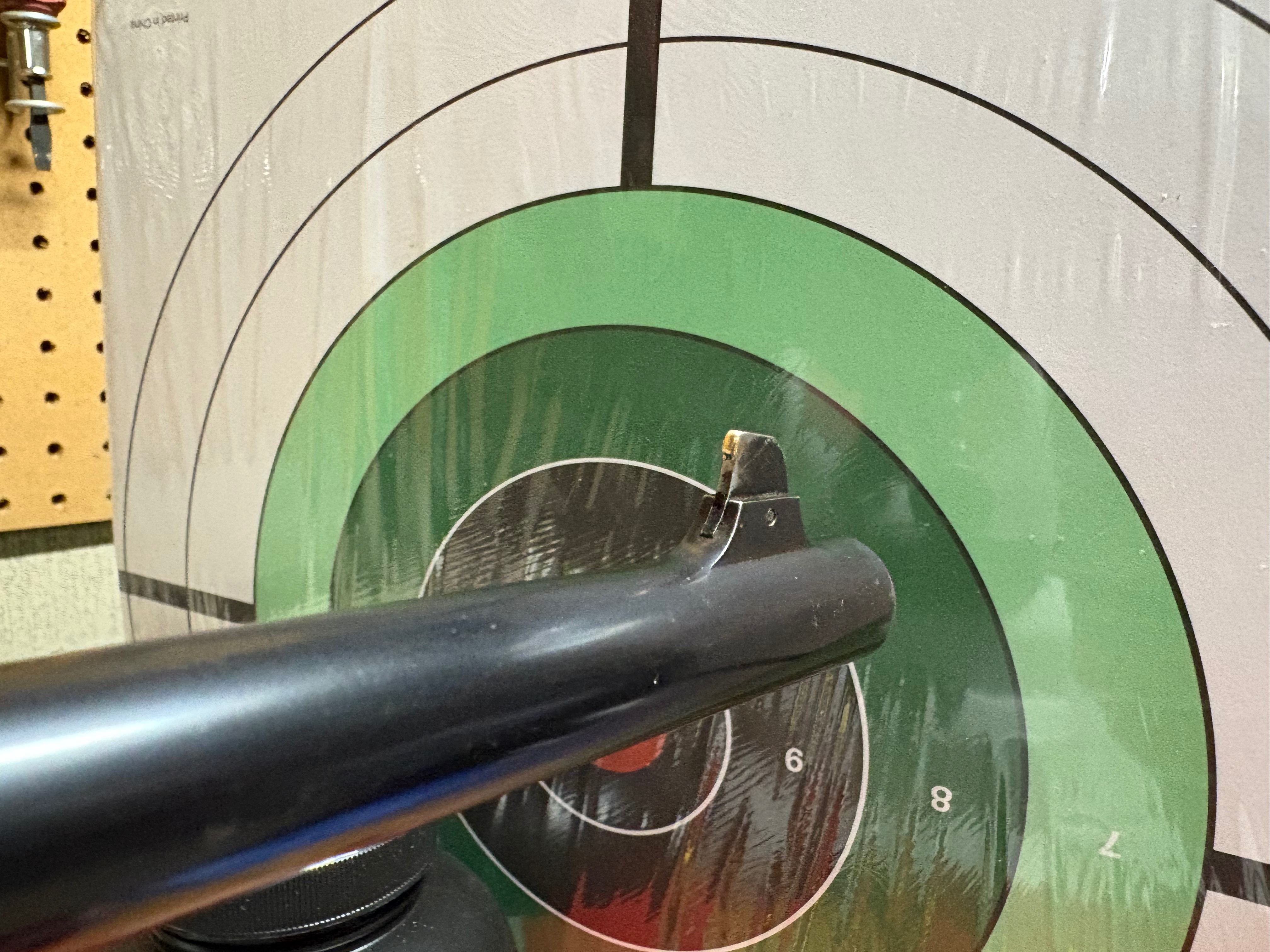

IMG_0215.jpegThe front sight. I’ve been putting the brass in the bottom of vee. With a dead hold hold it’s about 3.5” high

You can experiment by epoxy attaching a section of brass wire on top of the front sight.  A larger gauge of wire will give a bigger bead, so can get some variance there too.  If you like it, it could be left alone.  If not it can be removed, dressed up slightly with a file (done very carefully) and none the worse for wear.  But then you will have a potential height to work with.  Tim

I agree with you, as my father in law gunsmith would do just that for a few customers, and he would use different pieces of copper wire, and fashioned like you said, and after epoxy/gluing it to the sight, would clear coat it, keeping the tip on it shinny, as he would black paint the rest of it,(middle/front), and it really looked nice and worked out well.

A taller sight blade would be easy to fabricate for that set-up. You could also build up the blade with a black hot glue stick to figure out the height needed.
