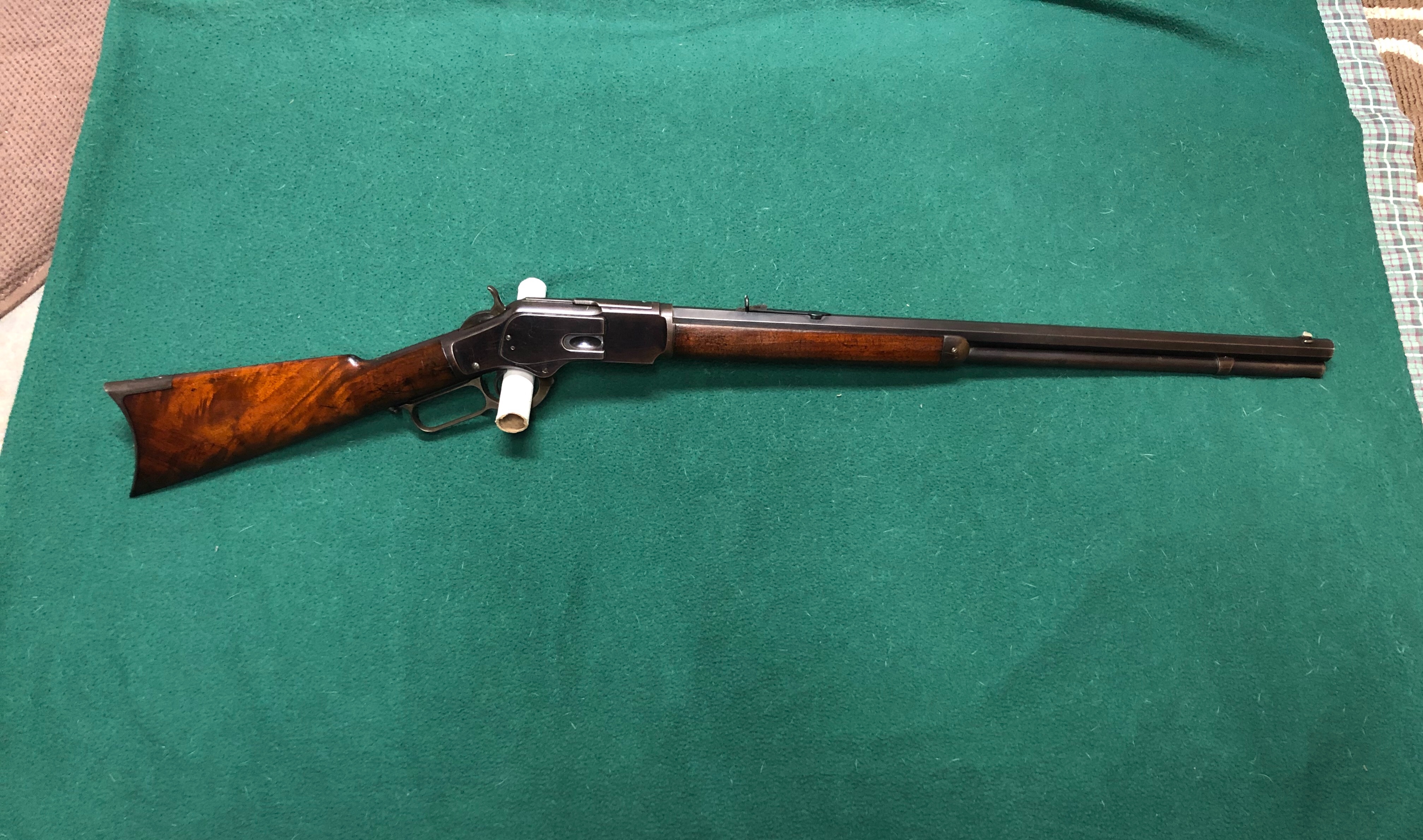

Haha Mike yes that would bring a few raised eyebrows using an empty cartridge case but whatever works. I started with two cowboy loads(800 fps) lead bullets & the next four cartridges were factory Winchester 1160fps jacketed rds. Here’s a pic.
Rick
Forum Posts: 7779
November 11, 2020 - 1:46 am
Rick-
Thanks for posting the pics, love a great piece of wood. Nice rifle, congrats!
