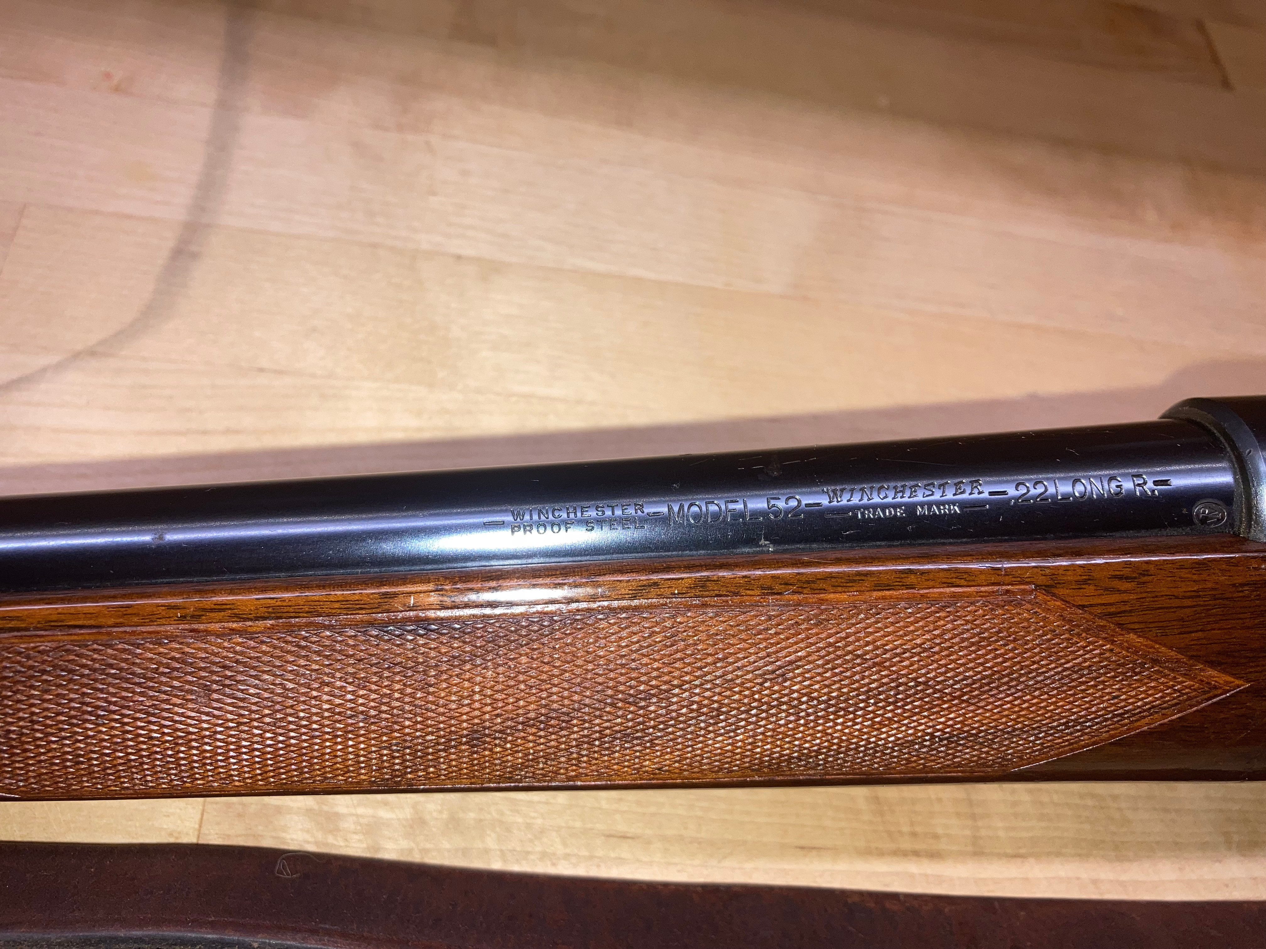

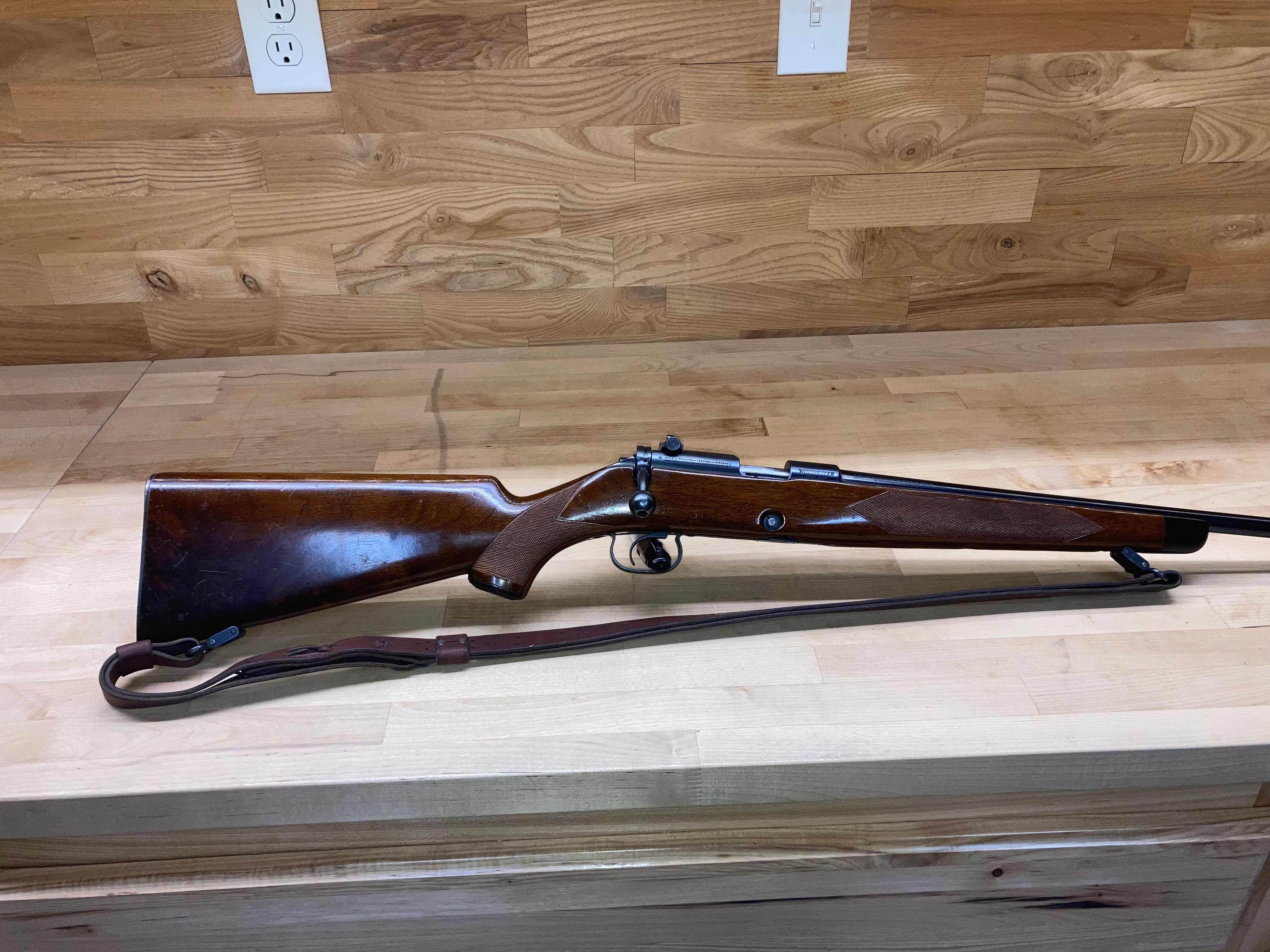

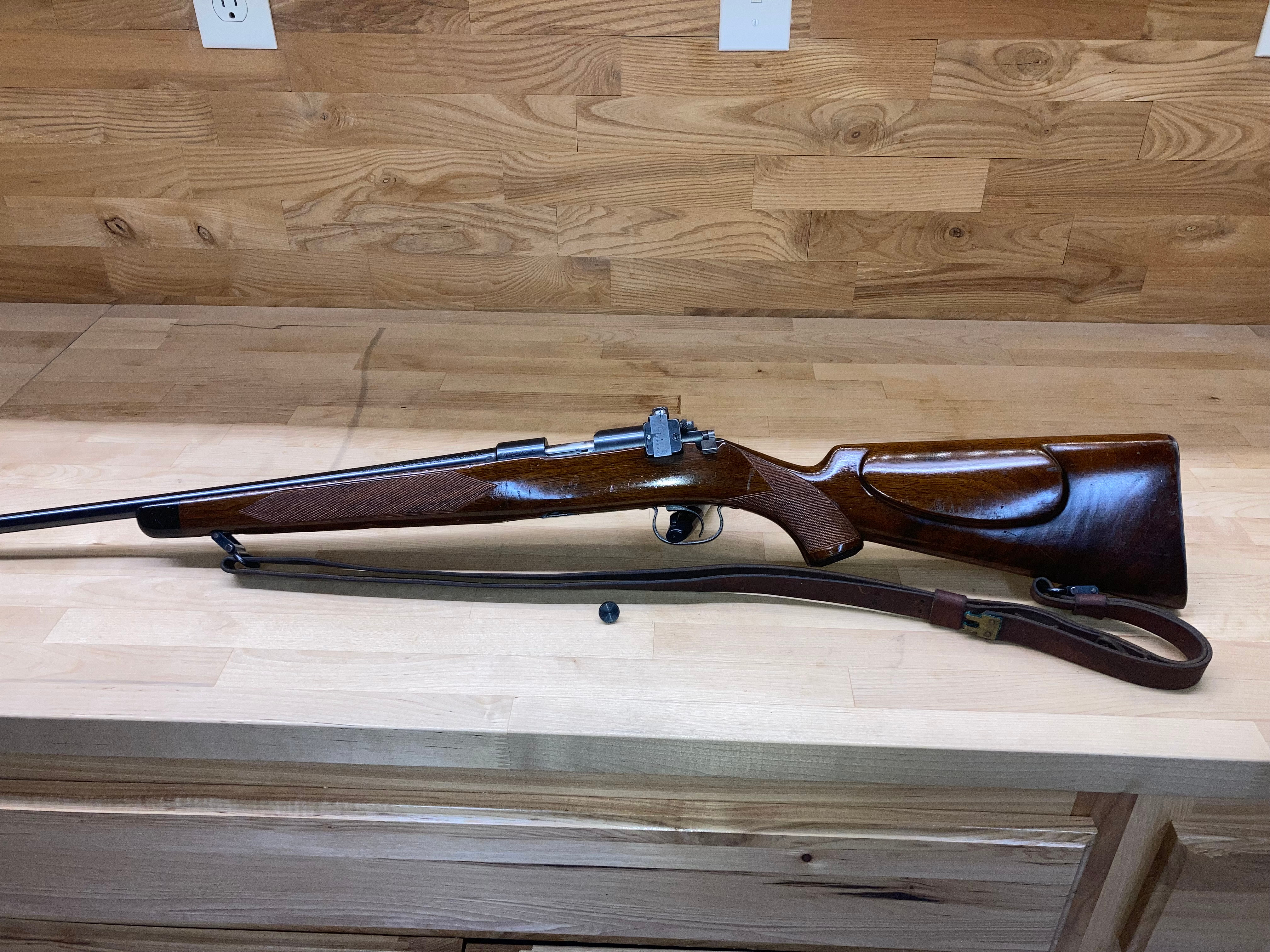

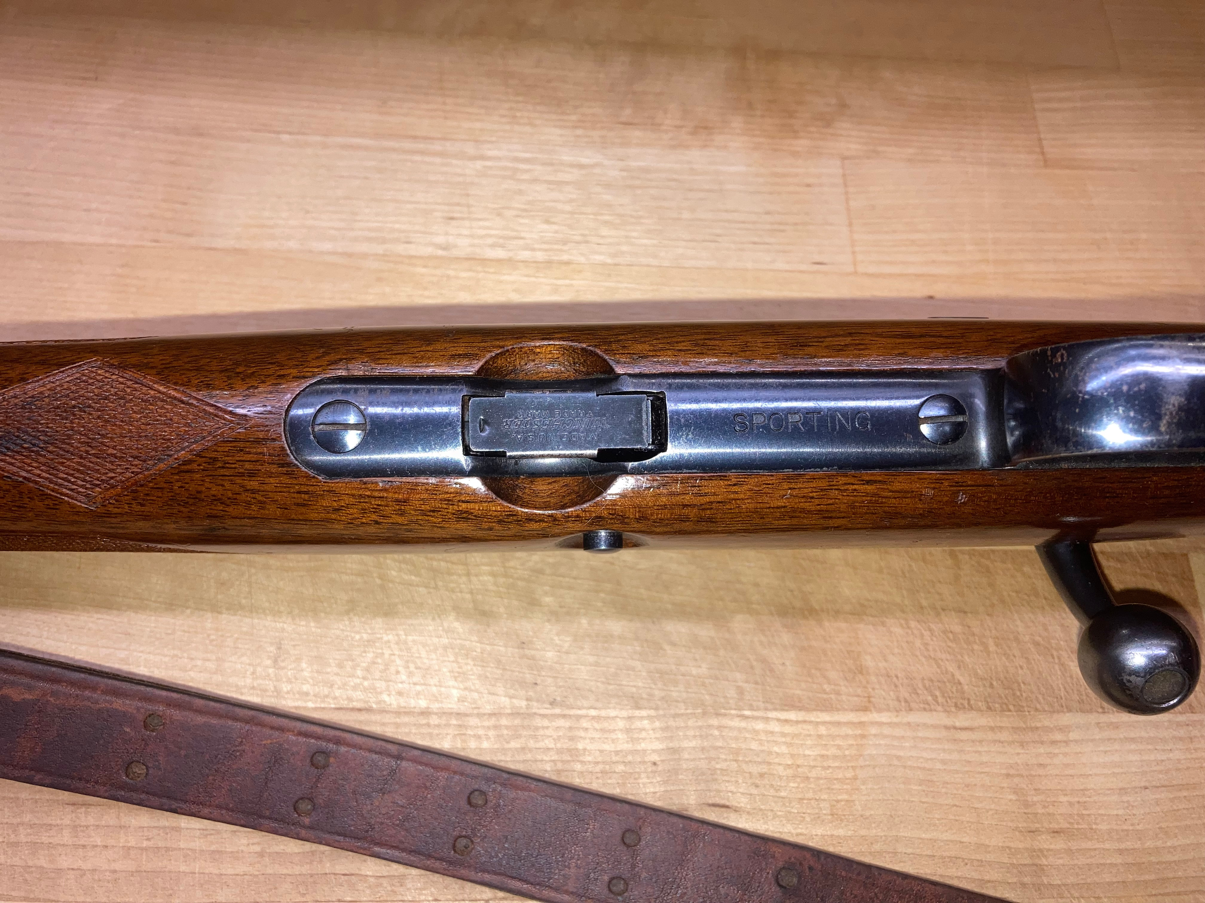

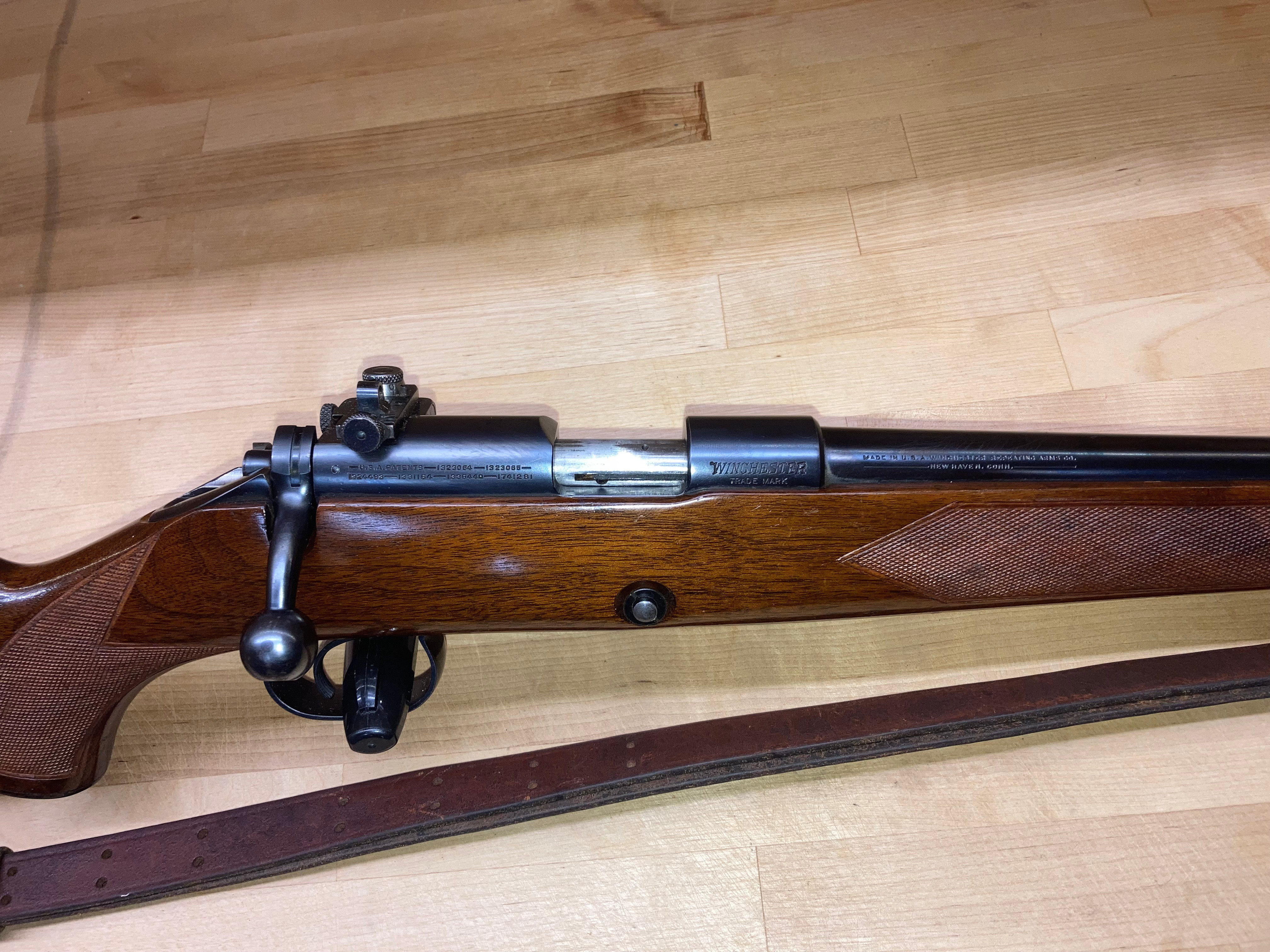

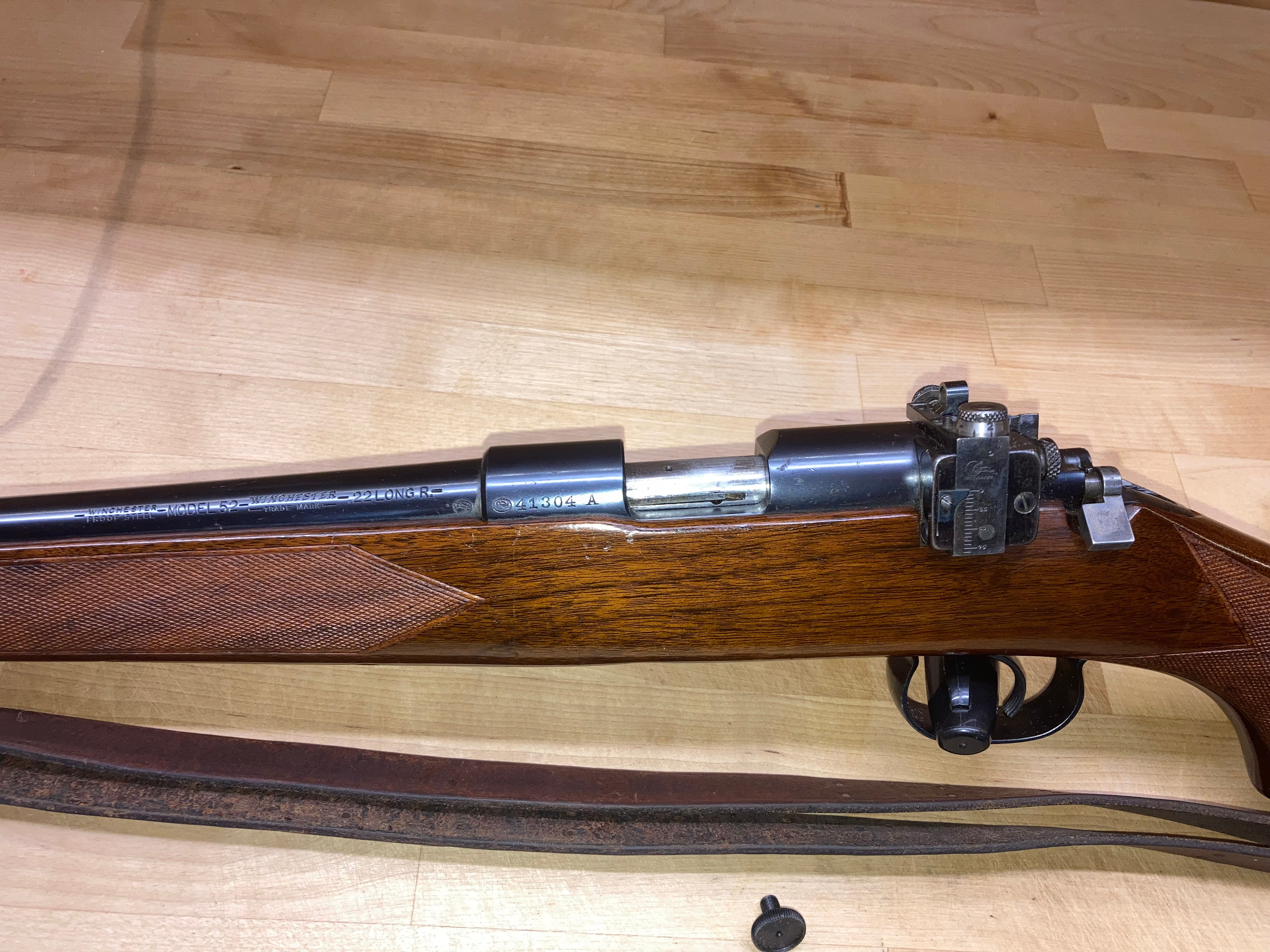

Thought I’d share this nice Winchester model 52 A Sporting Rifle.
A very clean and nice specimen, with a good bore to boot. All numbers are correct, and matching properly.
Correct sights. Bolt, magazine, and with the correct crown on the barrel muzzle, and original sling and swivels.
No cracks or splits in the wood, with a few handling marks, and evidence of cared for use, over the years.
Steve, (seewin), gave it his blessing a while back! In his words, “The, “A’, suffix designation, is Icing on the cake”!
According to his survey, the serial number, #41304 A, falls between, #40592-#41406, for, “A”, Sporters!
Serial number #41304 A, mfg, in late April-early May, 1936, according to Herbert Houze model 52 book.
A Thanks to Steve, as a gentleman, and a wealth of knowledge on these masterpieces. If him and JWA, ever decide to do a book on the Winchester model 52, we will all be appreciative, as I not only feel it’s needed, but the wealth of knowledge between these two gentlemen is astounding! Smile

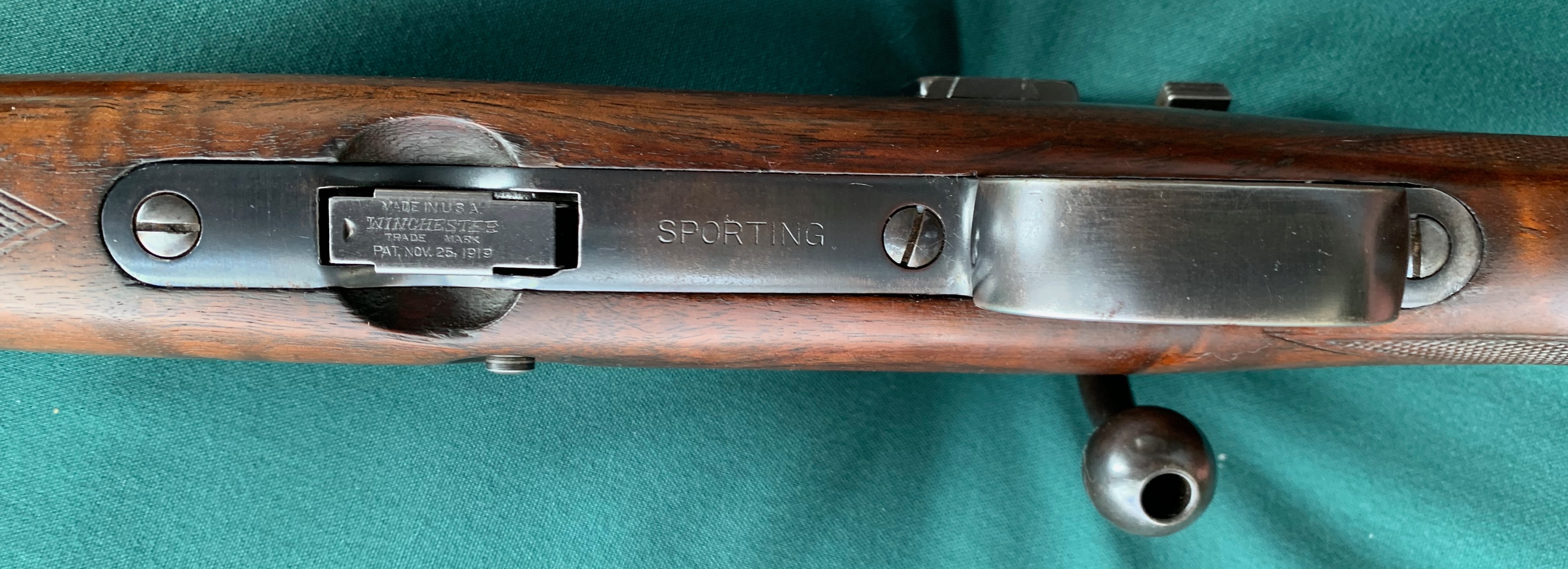

Anthony,
That is a nice looking rifle, and the “A” Models are the hardest 52 Sporting rifles to find.
A small point; the magazine in your rifle is of later (post war) manufacture.  The magazine that your rifle was originally equipped with would have had the 1919 patent date, and looked like this: IMG_3378.jpeg
BRP
Forum Posts: 2010
June 18, 2025 - 6:16 pm
BRP,
I did not know that, and will be on the lookout for one!
I do appreciate the picture, that you posted, as it will help me to try to find one! Smile

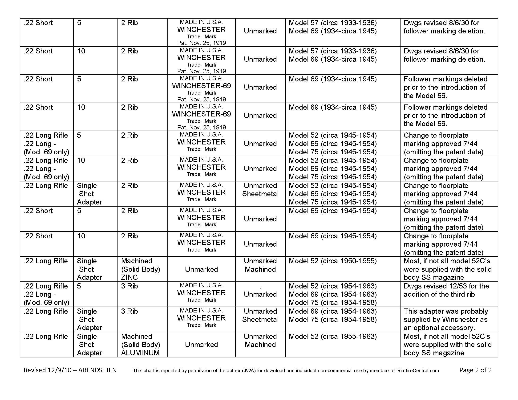

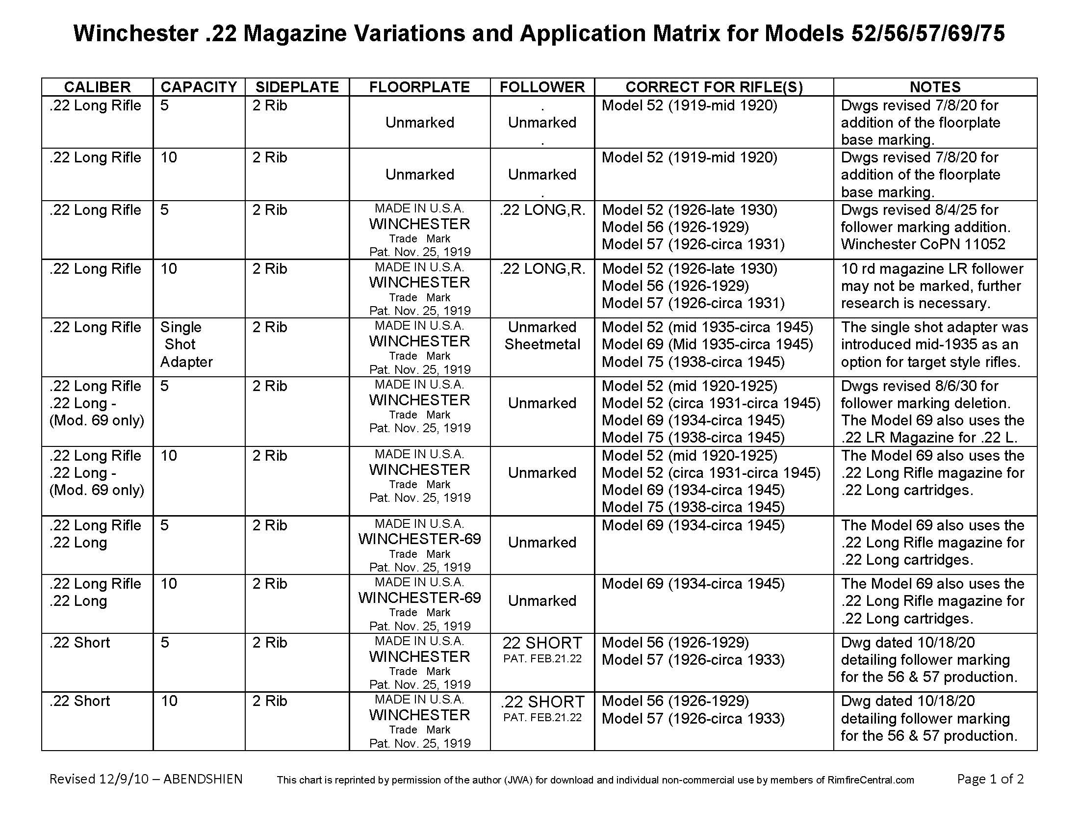

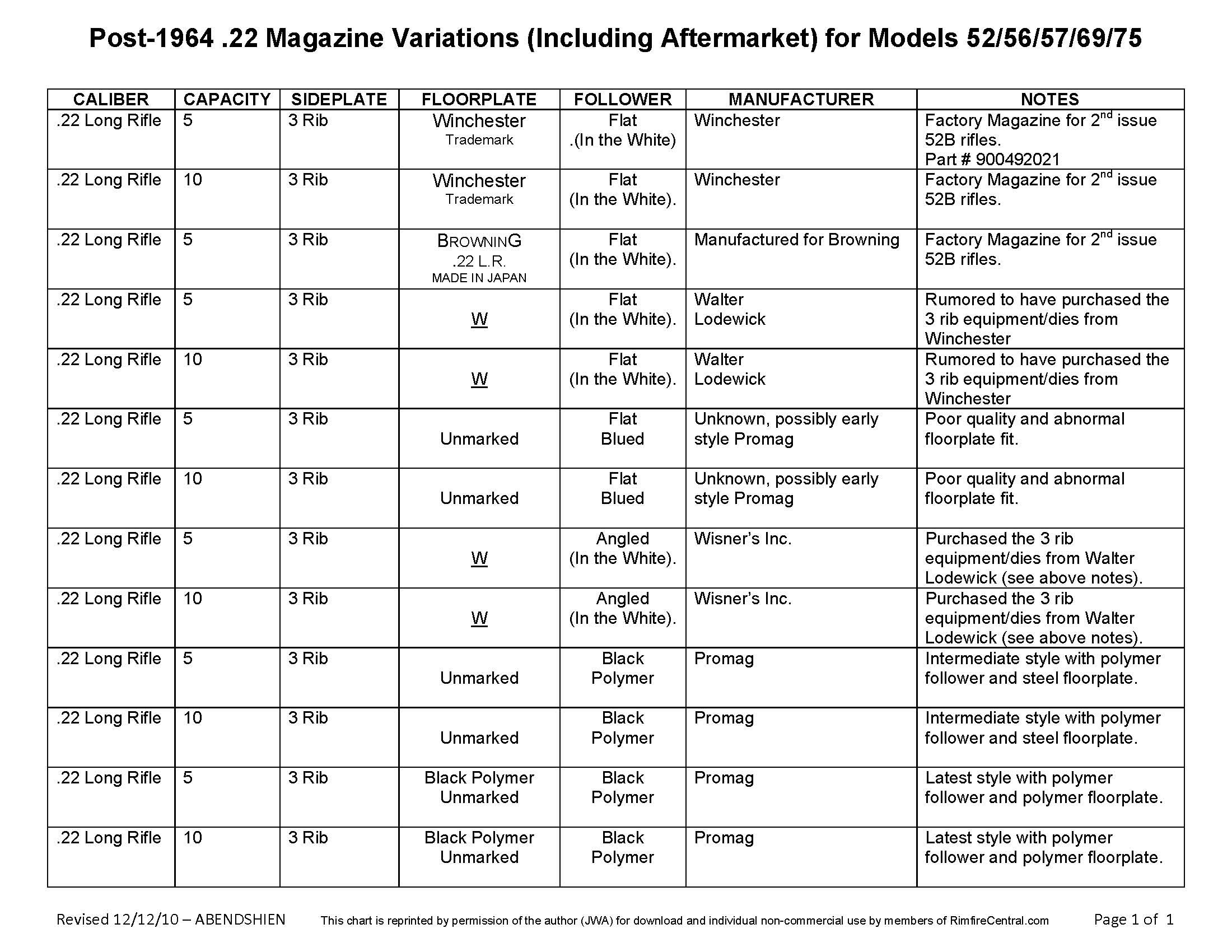

Forum Posts: 2847
June 18, 2025 - 11:02 pm
Hi Anthony,
Maybe this chart will help…….
It is 15 years old and I need to update the solid single shot adapter to include the Zinc version but otherwise it is fairly accurate.
Forum Posts: 2010
June 18, 2025 - 11:48 pm
Guy’s that information and those charts help out tremendously!
I can’t thank you guy’s enough for that!Smile
