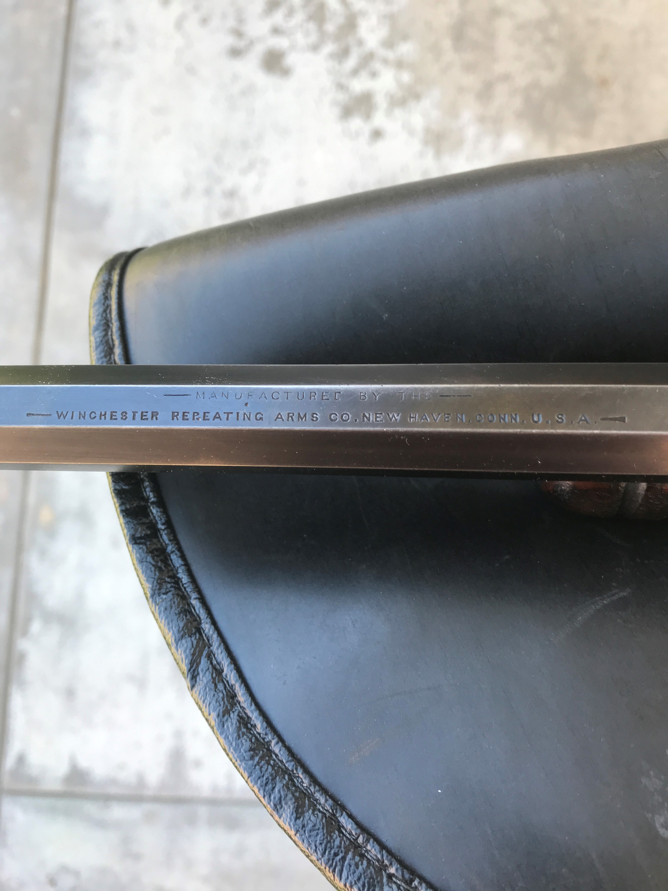

Don’t need to see it.  I have had several 1st models.1890-bbl-address.JPG1890-bbl-lenghts.JPG1890-receiver-2.jpg

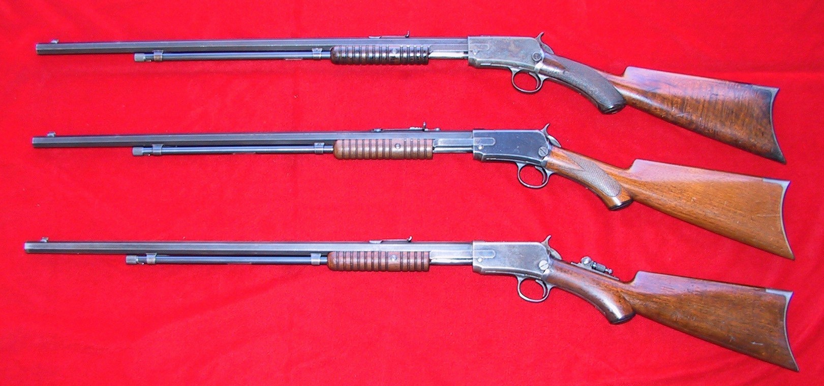

Here is a picture of 3 pistol grips.  The plain pistol grip and the semi deluxe pistol grip are both WRF.  As was the third model in my previous postPistol-Grip-1890s.jpg
Erin, after reading my post, I have to apologize.  I didn’t mean to be smart.  I appreciate your info.  I just meant to say that I have had several of these guns and showing that it has the longer barrel, it has the broken D in the address and along with the solid frame I didn’t need to pull the stock.

No problem, With all the counterfeit business going on these days I would still want to make sure somebody didn’t screw an early 2nd model barrel (24 3/8″) onto a first model 22 short  frame and collect the WRF premium on a first model. One never knows….You are going from  1,500-2,000 to a 5-7K rifle.  It did come up in a thread a while back that there were 2 roll stamps used for the first models and one doesn’t have the broken D. I have 5 first models and they all have the broken D. Just saying, for the minimal effort to remove the butt stock, better safe than sorry.
