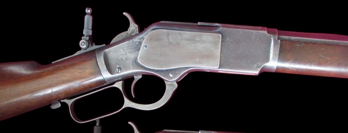

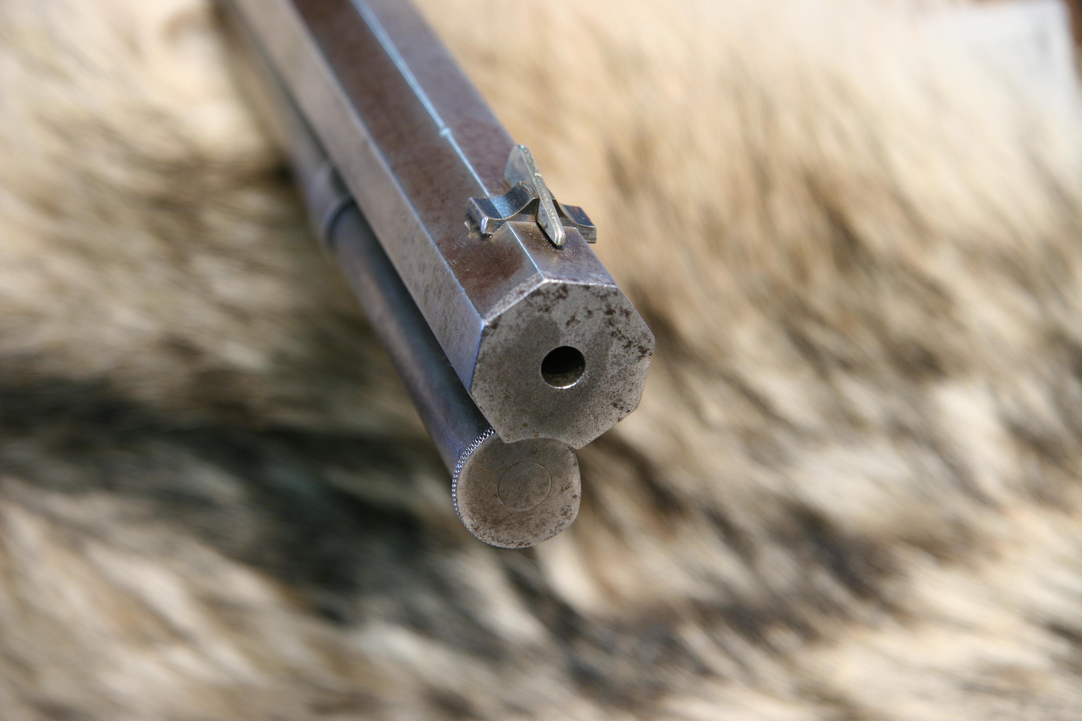

Here’s a pic of my rifle.
Pete Hynard, Ontario, Canada

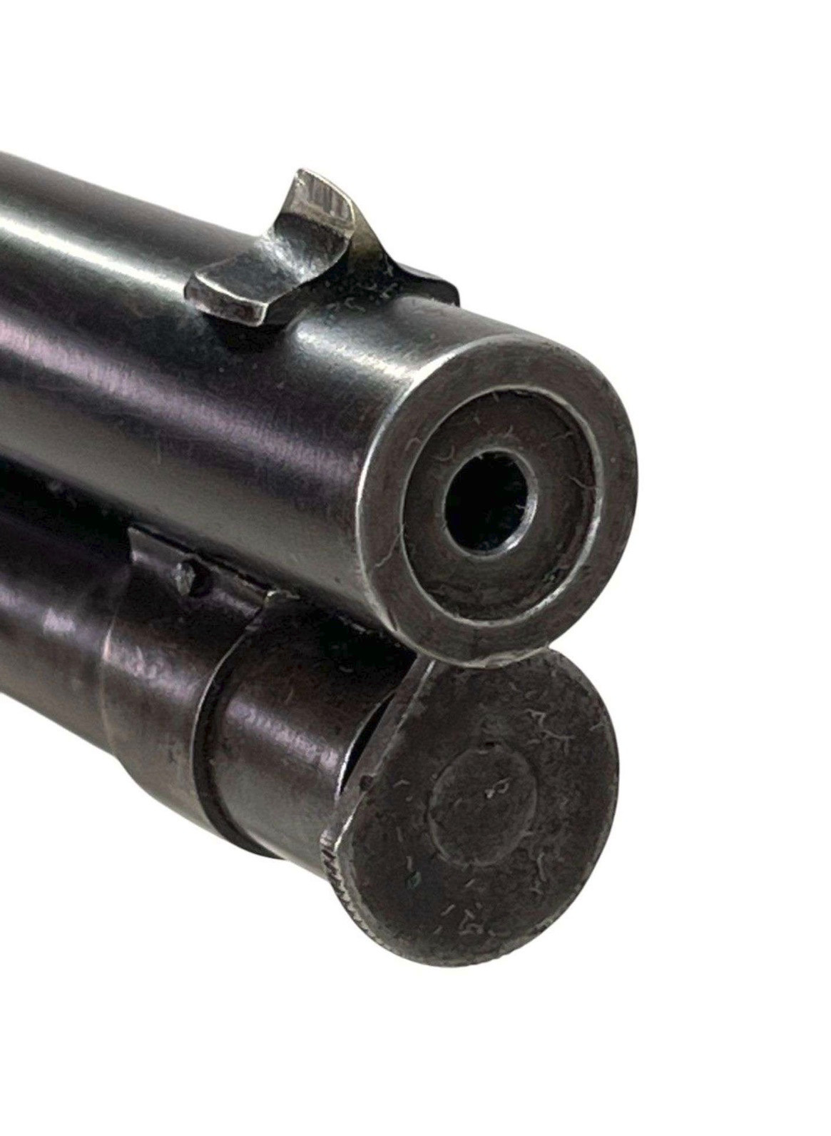

The measurements you mention very strong point towards an aftermarket cut down barrel.  The letter from the CFM you have is correct, and the original barrel length was the standard 24-inches.

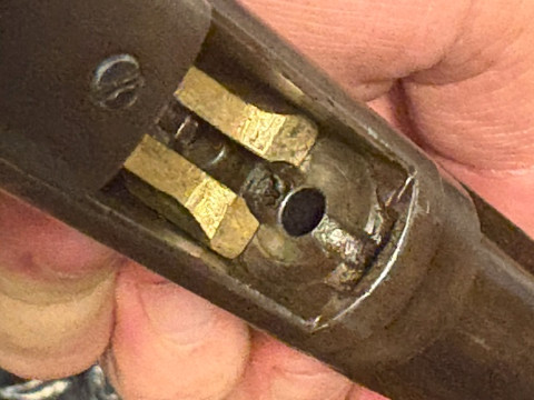

If you could send me several photos of the barrel, magazine tube and inner magazine loading tube I will take a look at them to see if I can shed some light on this. What is the length of the forearm wood? You can send it to my email below. I have documented two 22’s with 22″ barrels in my research.

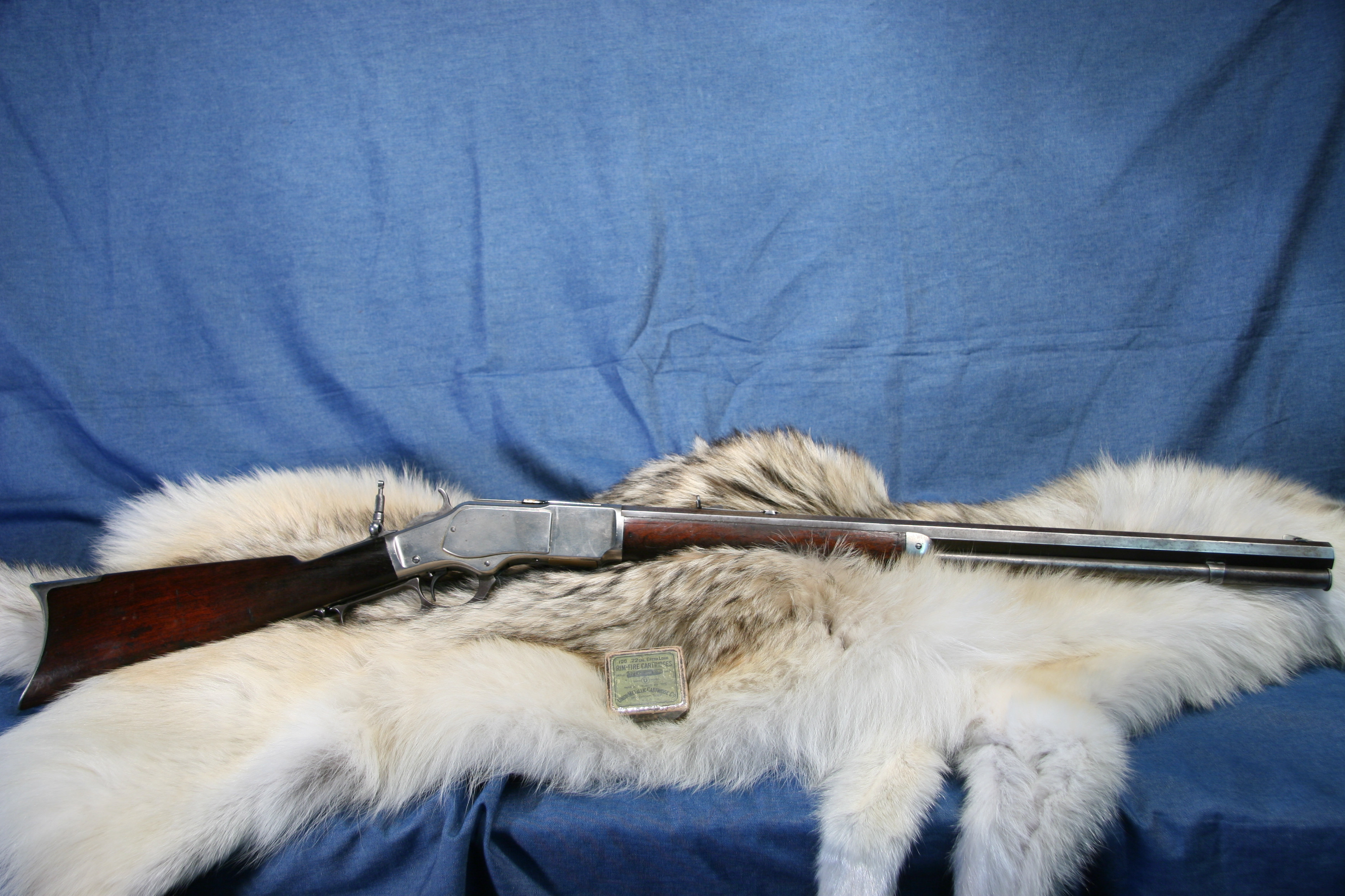

It’s been a few years, and I’ve never actually seen it, but I can’t get that BULL BARREL 1873 .22 out of my head Cool
Forum Posts: 5008
August 5, 2026 - 5:35 pm

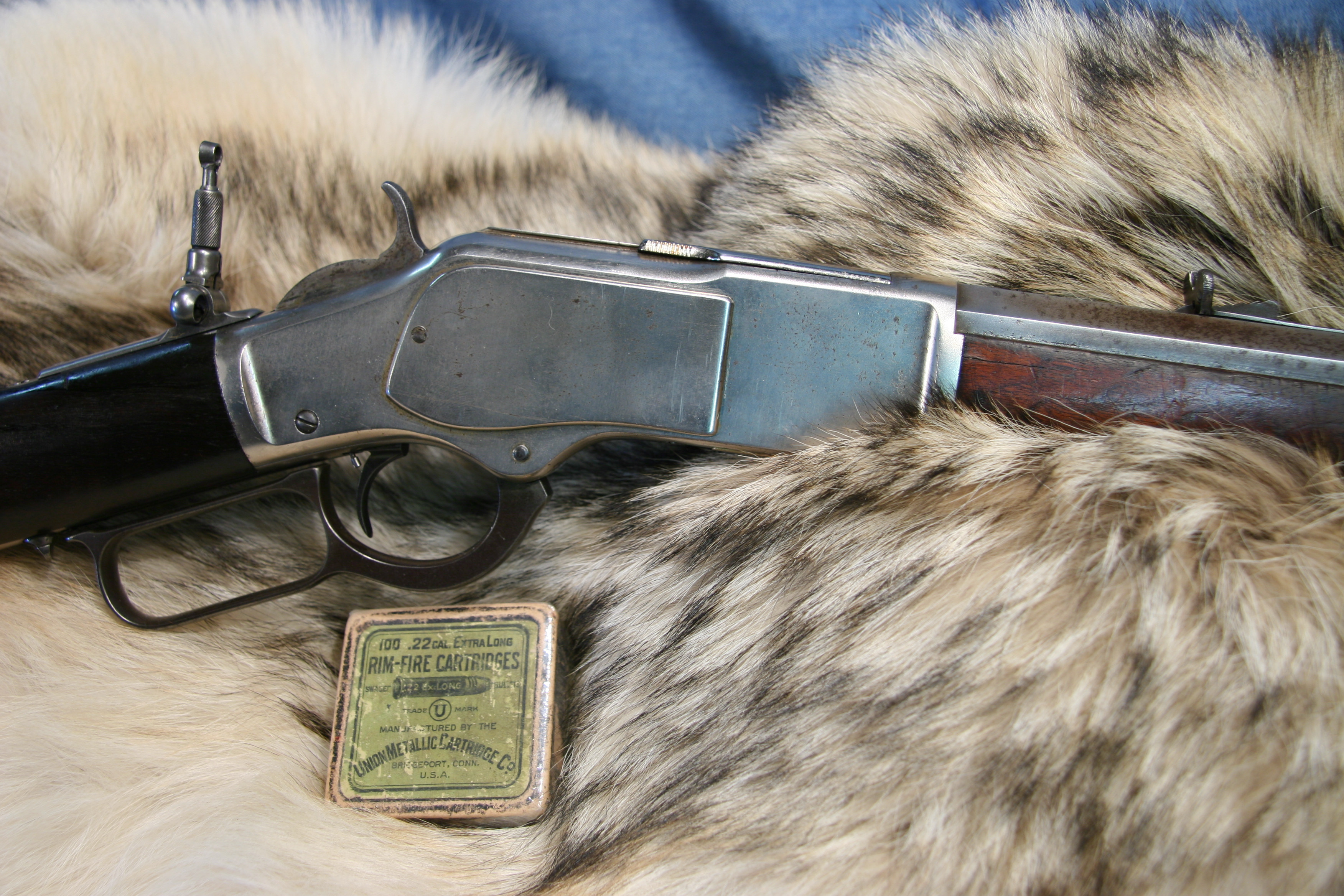

Here it is Steve,
Forum Posts: 1446
August 5, 2026 - 6:15 pm
Wow, Bob I LOVE it. What a hunk of steel! Hadn’t seen it before and wasn’t aware of special order .22s!
Forum Posts: 2092
August 5, 2026 - 6:29 pm
Focusing in on the Heavy barrel at the receiver it’s almost, flush!
I wouldn’t imagine that too many Bull barrel 73/22’s were made!
A neat letter, showing the weight of the gun @ 11 pounds!
Thanks for sharing, Bob!

Looking at the letter one can’t help but wonder if the weight was specified in the order. I like the concave barrel bottom.
Tony-
It looks like the corners are even with the sides of the receiver. Lots of pretty cool features.
Forum Posts: 5008
August 5, 2026 - 7:28 pm
The receivers on extra heavy barreled 73’s are heavier on the front end, wider and taller than the 44 frame. A 22 caliber 73 normally has a step receiver since it was built off the 38 caliber receiver but they had to beef the receiver up to handle the extra mass.  bought this gun at Tulsa when Jim Gordon was still going to the show and he had to see it. He said he looked through the records looking for stuff like this and he never saw it.  Never heard of one before. I think he was looking for extra heavy abbreviation in the ledger and missed the weight of the gun. I have seen other extra heavies listed by weight. I have also seen lightweight 73’s listed by weight.

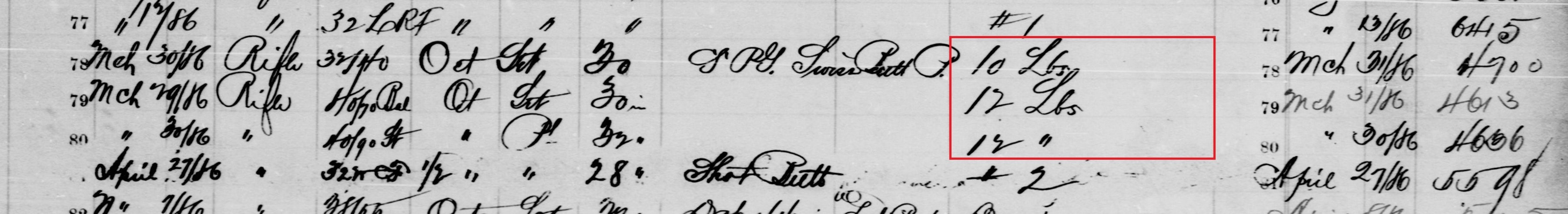

I do not believe that the weight was specified in the order.  Instead, it was simply an observation that was recorded by the person who entered it in the ledger record.  I have found at least a few hundred similar entries in the Single Shot ledger records. The picture below is a copy of the Single Shot ledger page for serial numbers 2278 – 2280.  Note that all three list the weight of the rifle in the Remarks column.

Mark emailed me pictures and the the length of the forearm is 9 3/8″,  barrel relined and barrel bobbed.

This is an example of the desirability of asking questions before purchasing rather than after.  We are here to help.  I think for most any of us that hang out here, just a quick glance at the photo of the muzzle would have yielded a definitive answer.  In the realm of antique and vintage Winchester collector, doing your homework is vital.  Take whatever you are told from a seller with a grain of salt.
Caveat Emptor.
