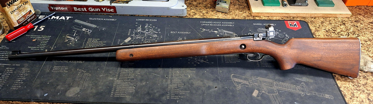

February 5, 2026 - 7:52 pm
See pic for progress so far.  I’m happy with the finish, and butt plate has been contoured to fit the wood. Awaiting front sight and magazine, then off to the range!
John . . .I’m very suspicious that your stock was shortened a bit (Maybe why the buttplate was oversized).
What is the LOP now? (Your REAR sling swivel looks to be much closer to the buttplate than mine.)
My old 75 Target is 13 1/8”.
John D.
Star ID
Forum Posts: 203
March 3, 2020
February 6, 2026 - 9:18 pm
Jim F in CT said
Oh, I’m pretty positive it has been shortened.  Smile
The rear sling swivel screw on the butt plate side was missing….. apparently because the bottom butt plate screw was hitting it, and apparently whoever did the bob-job just removed the screw instead of fixing the issue. Also, as you mentioned – the butt plate toe was too long, and there were other minor fitment issues with it on the sides. Plus, the hand stop rail channel was lengthened back towards the receiver, presumably to accommodate the shorter arms of a junior shooter.
I have addressed issue 1 and 2, and am in the process of making a replacement rail to fit the new, longer slot.  I have not measured the LOP, but it sure feels short.
Between purchase price and parts, I’m into the rifle for about $275.  GPC has replacement stocks and butt plates, but I’m not sure I want to invest any more money in this gun…..  as least, not before I shoot it to see what’s what.
The globe sight arrived today, and I’m now awaiting delivery of the magazine. I will be sure to post a range report when I take it out for a spin.
