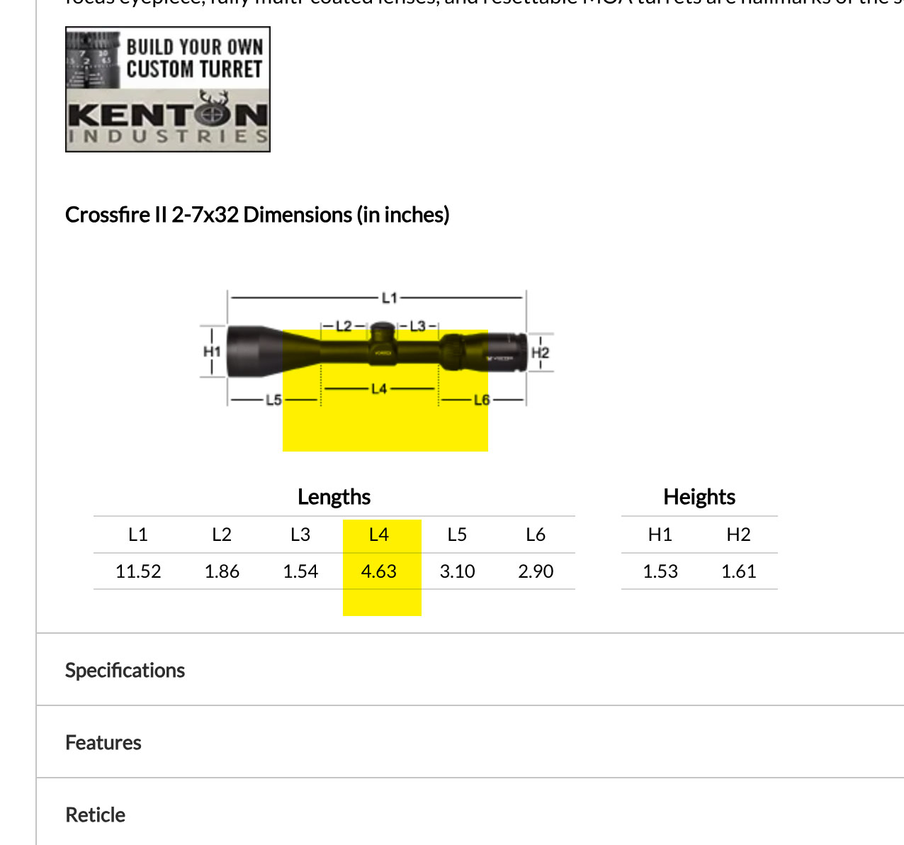

I bought a Vortex Crossfire II 2-7x, but not the rimfire version (how bad is that?)(what SHOULD I get?)
When I took a closer look at the rifle I realized that the scope mounts are about 6-1/2″ apart, while the skinny part of the Vortex is only 4-1/2″ long.

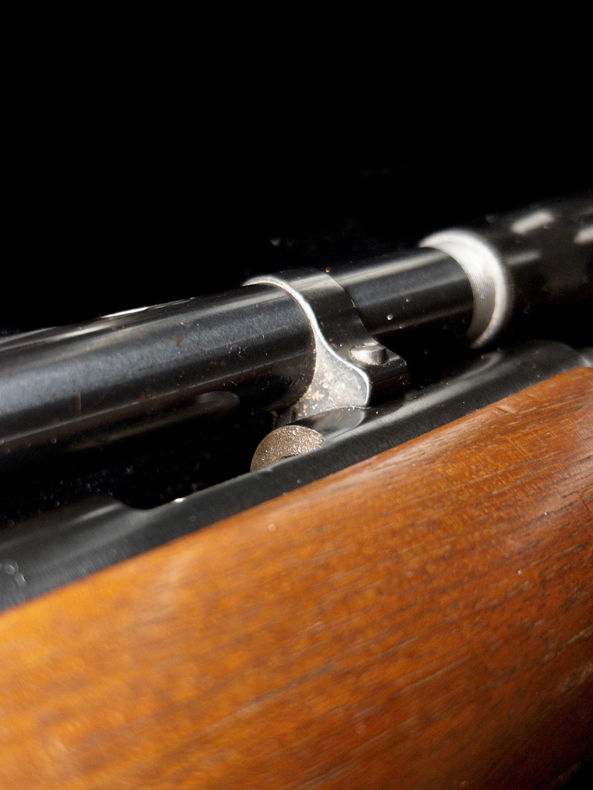

I’m attaching (I think) photos of what I have and what I’d like to mount.
I don’t think it’s TOO hideous, but I know what you mean with the ‘telescope on a derringer’ syndrome.scope
Any ideas?

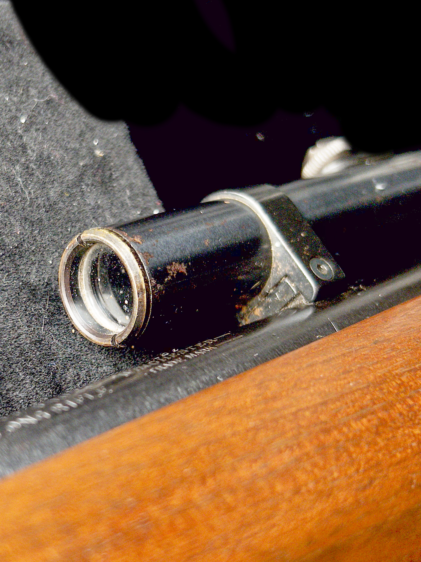

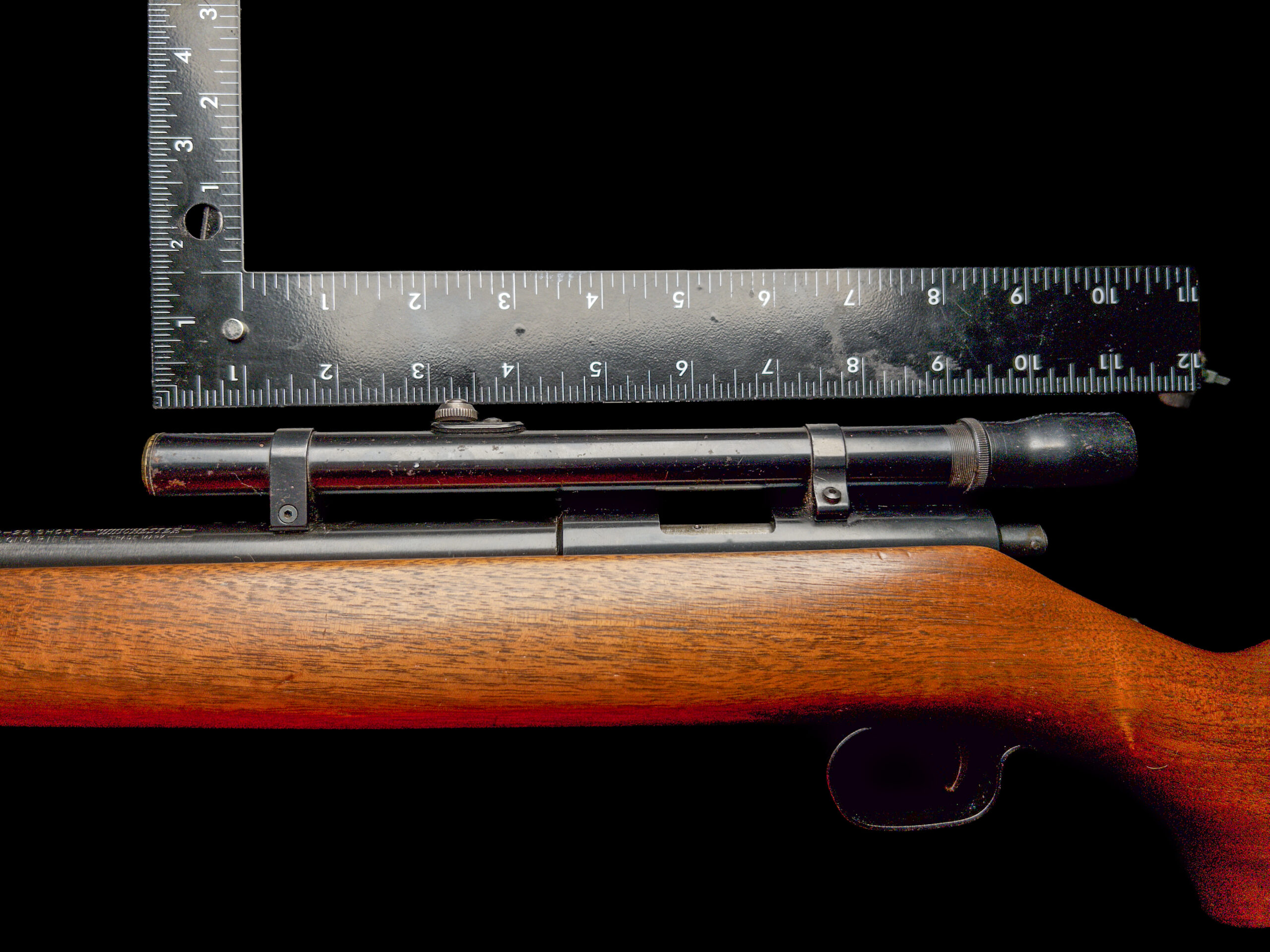

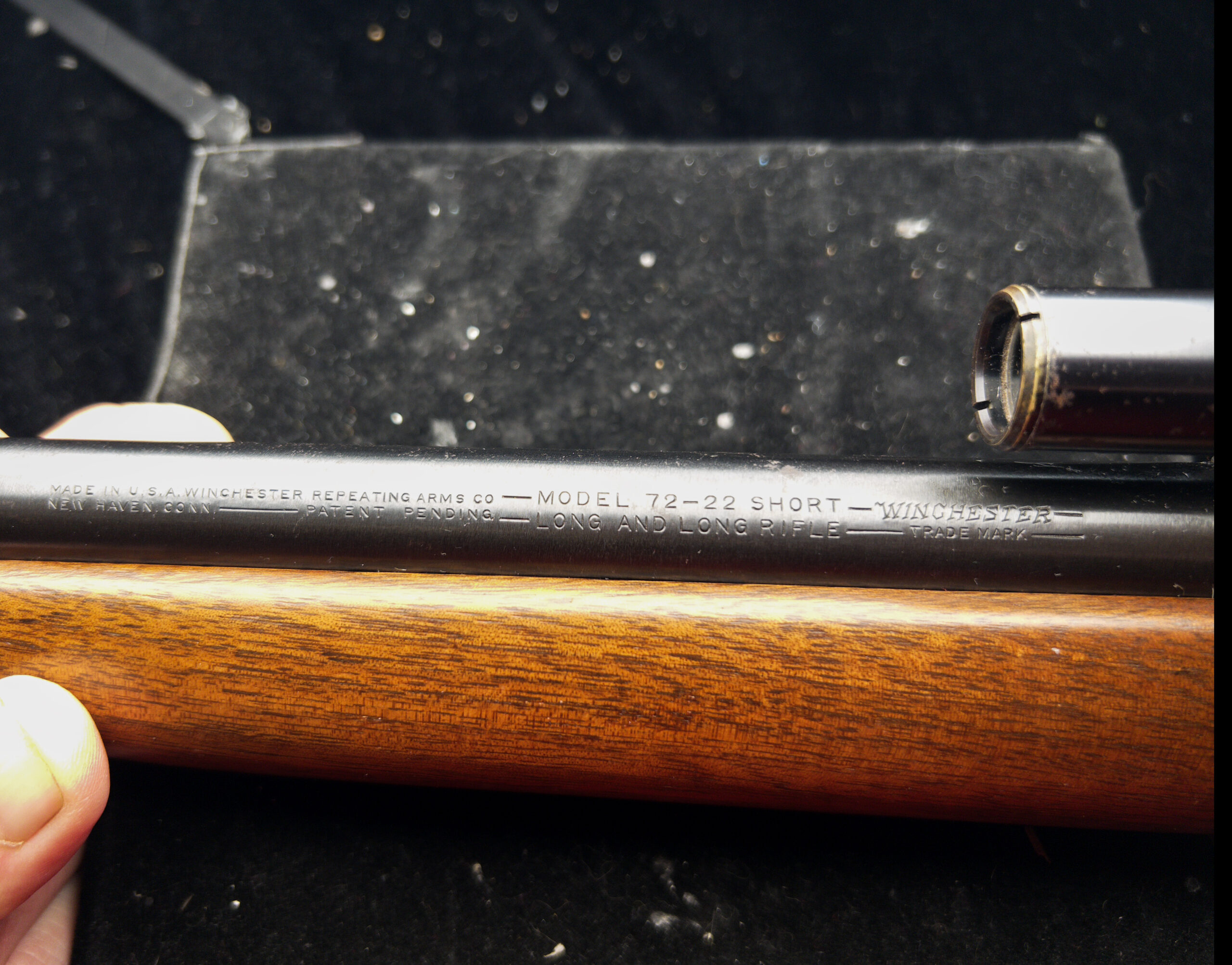

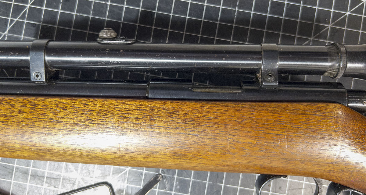

If it helps, here are some photos of the scope that is on it now.
Thanks!

While I wholeheartedly approve of your desire to not modify the rifle, that one is going to be a real challenge without further modification.  As you are probably already aware, the front mount utilizes the existing dovetail for the former rear open sight and the rear mount uses 2 screws angled into the receiver.  While Zebulon’s idea of using a blank picatinny or Weaver rail is normally the easiest answer, that is not the case with your rifle as the rear angled holes are not in the right position to be able to drill the rail to match.
In your unique situation I can only offer one suggestion that has proven effective.  Remove the current scope and mounts and purchase your desired scope and the correct mounts for it.  Attach (basically “glue”) the mounts to the receiver in the appropriate locations using Black Loctite 480 Instant Adhesive.  This process has worked for other people although I have not tried it personally.  If you desire to remove the mounts a heat gun will soften and release the adhesive so it can be cleaned from the bluing.  It sounds like a weird solution but a number of people on the Rimfire Central forum have successfully done it.  Just make sure you completely clean and degrease the area where the mounts are to be affixed and do not get any excess on the stock or other areas.

I hadn’t seen.your photos when I spoke about making up a rail — I wrongly assumed somebody had drilled and tapped the receiver and,possibly, the barrel. It’s really good that’s not the case.and the rifle is unmarked.
Smith, of San Antonio, marketed the “streamline” scope mounts that utilized the holes in the receiver wall intended for a receiver sight, plus the rear sight dovetail, as mounting points for the streamline bases and rings.
I think Mike has the right idea. I myself would stay with the small diameter scope or another, brighter one of the same diameter. There are companies that specialize in bringing vintage scopes up to modern specs amd if a nice Weaver J4 won’t work, consider an improved J4.

To use your current rings you’d have to stick with a J2.5 because they are single split or “solid” rings.  Drilling a Weaver blank base is a possibility as mentioned but I’ve found most gunsmiths don’t care to take on such work.  Glueing a base on sound interesting yet you may find the empty holes from the old mount an eyesore.  Iron Site or Vintage Gun scopes could likely install your rings on one of the “baby” scopes.
