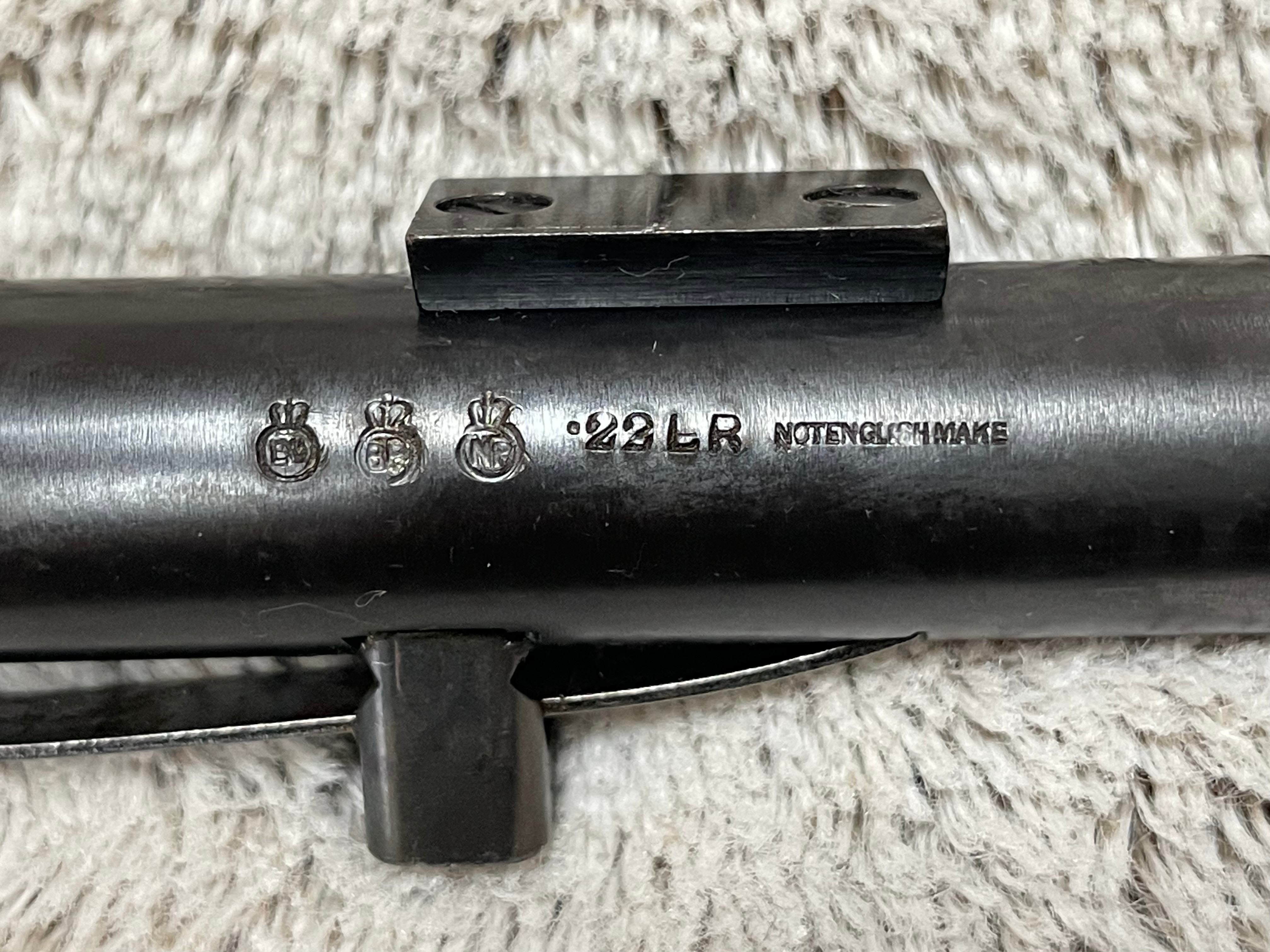

I chose to resurrect this older post, for comparisons and the wealth of information, that was already provided from some knowledgeable members. Even thogh it started in 2020, and the last post was 2022, I still feel it’s worthwhile.
This Winchester model 677, S,L,LR,calibers, is in pretty decent condition, with it’s minor scratches and bruises, and even a few mars or dings in the wood, yet strong bluing on the barrel. I’ll post some pictures, as a decent example without the sights, but the Winchester A-5 scope, as it should have.
This one is interesting with it’s British Proof marks,(possibly Birmingham), and after the three stamps, says,”Not English Make”. I also find it interesting, that between the British proof marks, and the words, “Not English Make”, is the .22 L.R. caliber, markings, as on the barrel address, like a typical model 67, S,L,LR, showing the caliber.
On top of the barrel, under the scope, is an, “N”, with a point, showing direction, (see pics.). The, “N”, has serifs on it, as I’m not sure what that might mean, if anything.
Also, on the right side of the, grooved forearm, walnut butt stock, is an “arrow pointing” up, as I’m not sure what this means or who put it there, as it look like it’s been there awhile. (see pics.)

The 6 th and 7 th pics show some very small marks as I’m still trying to determine what those are, as I think I do see a ,”N”, in the mix. Looks possibly, to be a small scratch or two, on the right top, under the scope, opposite the address.
Any information, on the arrows or the rifle itself would be appreciated.

A Model 677 rifle should not have a Winchester A5 scope.  Lyman purchased the patent for the Winchester scopes (the A5 and the B-series) it in the latter half of the 1920s and then reissued it as a Lyman 5A.
That stated, I believe that the Model 677 and 697 rifles were equipped with scopes that Winchester purchased from somebody other than Lyman.  Hopefully Jeff weighs in and gives us the straight skinny on this.

I just took a peak at the top of the scope, and is is stamped, 5-X.

Bert is correct, it should not have an A5 scope, it should have the later “No. 5” scope (5x) which yours does have.  The 2 suppliers of the scopes to Winchester at that time were Carolyn and Saymon Brown.
That is a nice looking 677 and it has the “N” and broad arrow marking which indicates use by the British Army.  This is the second “N” and broad arrow marking I have seen this week as there is another 677 rifle with the identical marking on the Rimfire Central forum although yours is in MUCH better condition.
Your British proof markings look typical and correct for the rifle. The scope mounting bases also look correct and should have a number stamped on the top or the underside.  The number should be either a 1, 2 or 6 depending upon the location and vintage of the 677.
You don’t show a picture of it but there is also typically a number stamped on the left side of the barrel which mimics a serial number, does yours have a 3-5 digit number stamped anywhere on the barrel?
I also noticed your scope is located fairly far forward in the mounting rings, while this is visually pleasing you will find that when shooting the scope will likely have to be moved rearward to get the proper eye relief on the scope with your cheek in the proper position on the stock.
Thanks for the pictures and let us know if you have any more questions.

You’re information is pleasing to my ears. In today’s collectable world, one never knows. When I get back later this evening, or if too late, Wife’s Birthday, then tomorrow, I can look for that mark you’re talking about. I did notice a plain number 5, stamped on the inside of the wood stock in letting where the barrel, lays. I’ll check the barrel out also.
I had no idea, or didn’t remember, any thing about the broad arrow mark, or the, “N’, also. I find it interesting that another one showed up , and this week yet, on another forum. I’ll have to take a look.
That is a reminder of the scope providers, as I did forget about them also. My bad miss identifying the scope.

I was able to add these other pics this morning. Just as Jeff, JWA, said, under the back scope base, is the number 2 stamped, on the underside. The front base is plain. I found it interesting as the proof mark stamp on the barrel, in front of the breach, is double struck! If you look close, on the left side of the breech is, what looks like a letter, “B’,!  Almost like a number 8, but the left side looks straight like a, “B” . I see no other numbers on the barrel, any where. But I did notice this letter, “J”, under the barrel, @ 6:00 o’clock, beneath the end of the address! I have no idea, what that might mean, or stand for, in all honesty.
