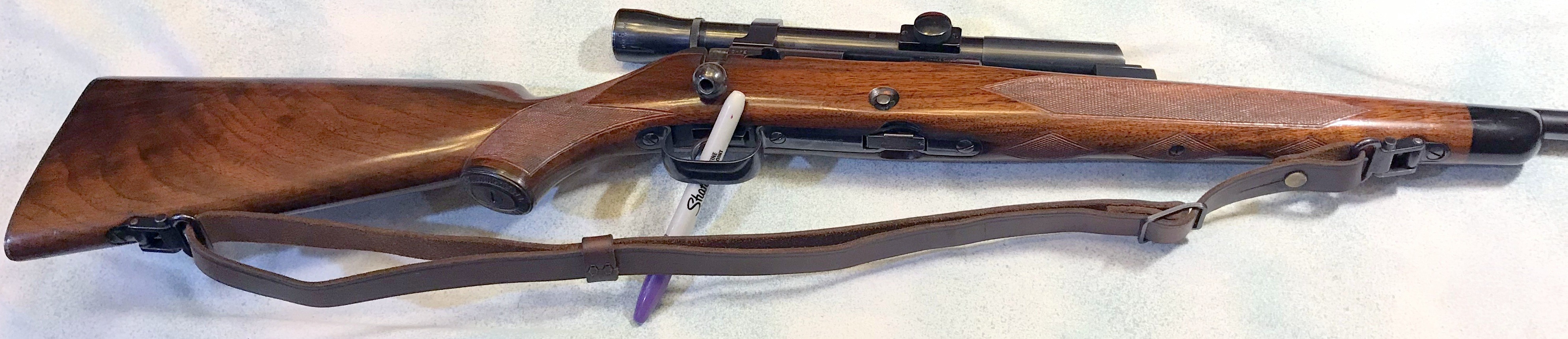

What is your take on this Winchester 52B? Steel grip cap come late on the 52B? Refinished? But plate has a strange look too?
Forum Posts: 2514
October 21, 2026 - 1:33 am
The C Sporting was very late to be put in production and the B Sporting continued to be produced well into the Fifties, as a result. The late ones were furnished with steel grip caps.
The view of the buttplate may be distorted by the camera lens, making the plate appear thicker than in reality. A too-wide angle lens – one of short focal length – can make closer objects appear relatively larger than those in background.
But whether the wood and steel have been refinished is a question hard to answer just by looking at a photograph. I will say the apparent high gloss on the wood is suspicious. The high condition 52 Sporting Rifles I have examined in person have a sprayed lacquer finish but are not buffed to reflect nearly as much light. However, it may just be the photography lighting setup. It really would take a close, hands on inspection to opine.

Good morning! I’m no expert on .22 ‘s by any means but I would like to add a note to this conversation concerning Ralph. I have not met him personally but I have had many, many conversations with him starting several years ago when I bought one of the first Winchesters he started to sell out of his large collection, a 1908, 1894, 30/30. Since then I’ve purchased several model 12’s and recently a model 75 Sporter. He’s not inexpensive but I found these guns to be in pristine condition, not a fingerprint on them. A lifetime of collecting from other collectors and dealers. He sent me those pictures several months ago before he listed it in GI but I’m not a .22 collector at that price. All I can vouch for is he has been very honest with me, I have no regrets in an of my purchases. Anyway just my .22 cents worth, lol.

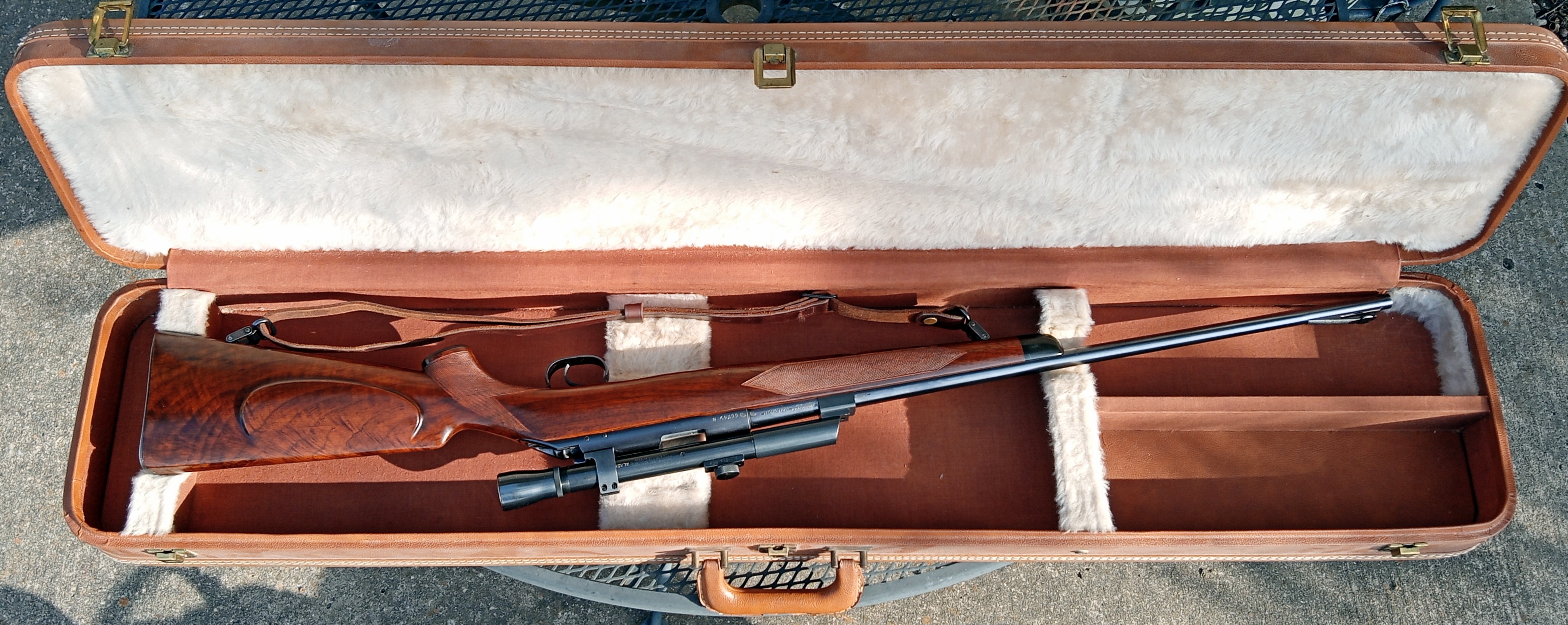

FWIW, here’s a 1939 52B with similar “fancy” wood. Win-52B-Sporter-Stith-Custom-Mount.jpg
Both the metal & the wood on the rifle in question are a bit shiny, but perhaps there was a light oiling prior to photos being taken.  Not sure of differences, if any, between pre-war & post-war finishes.

Those who were willing to go to the effort of making a special order for fancy grade walnut, were also likely to go whole hog and get Winchester “piano finish” also known as French polish treatment. One of my pre-war 52 Sporting rifles has that high gloss finish.  So the high gloss finish on the original rifle in question may indeed be correct.
