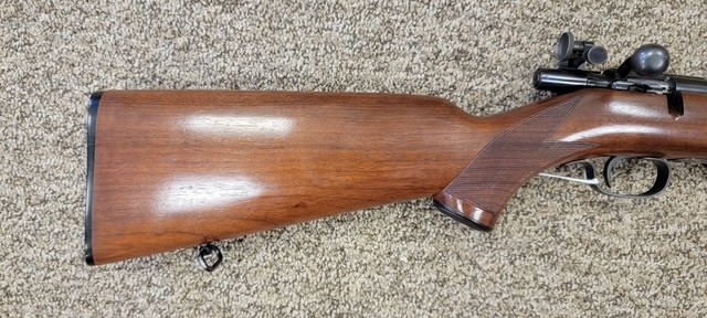

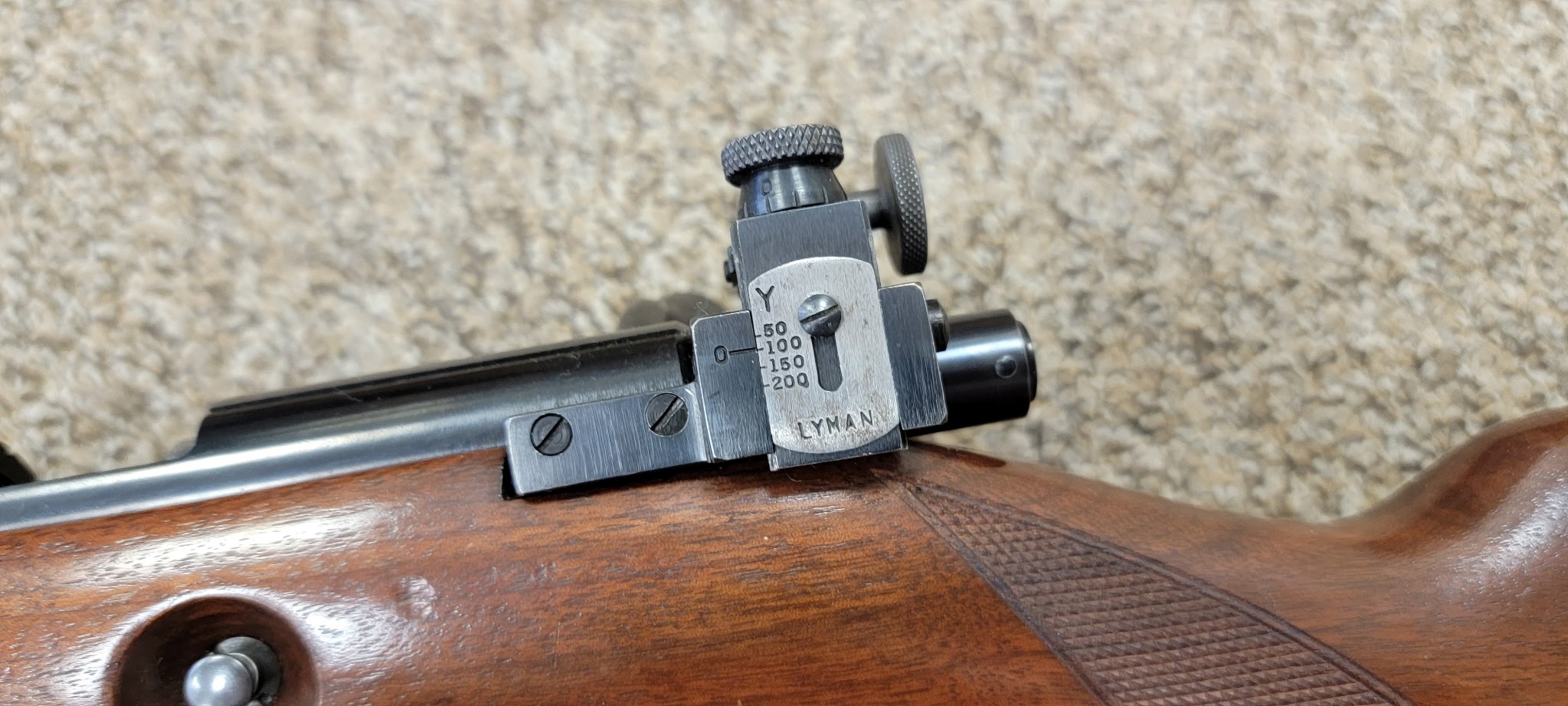

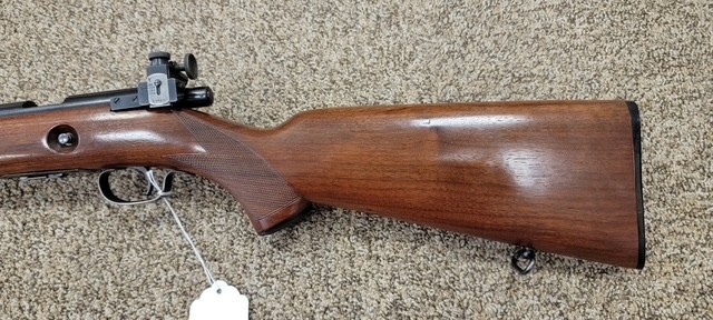

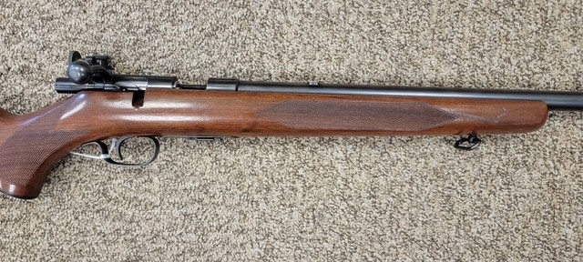

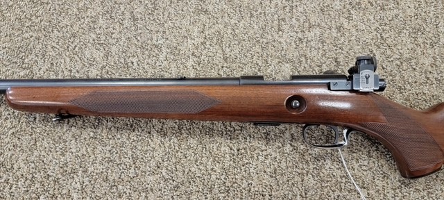

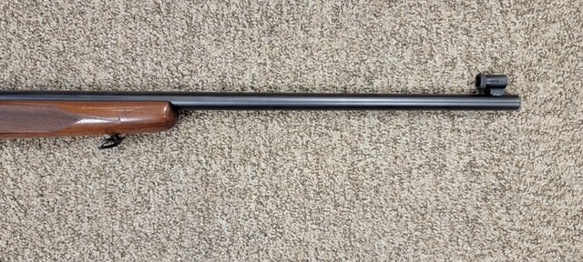

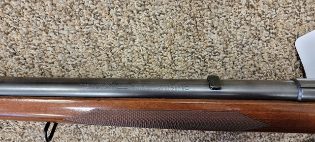

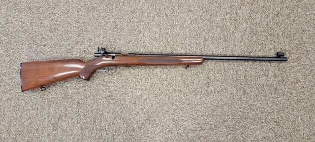

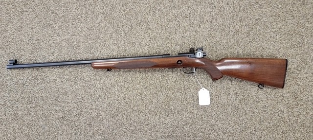

Hi,
I recently ran across a 69A with a Lyman 57EW peep, globe front sight, blank in rear sight. supposedly a “heavy” barrel.. what caught my eye was the Winchester Checkering on the stock.  Was told it was special ordered from the factory.  No serial number and no documentation.  I will try to get pictures and would like any expert advice.  Asking price is $900.00

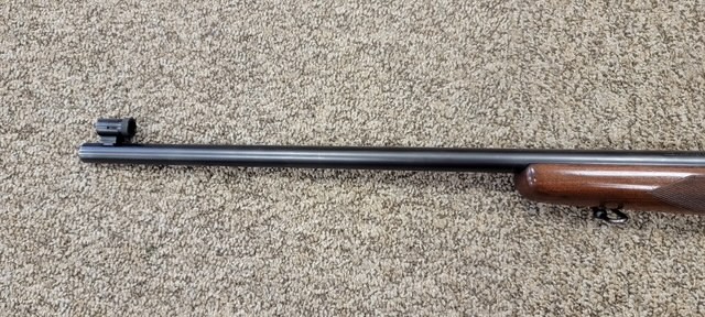

         They depict a Winchester Model G6903R 69A “Junior Target Shooter’s Special”.  This particular rifle has had a rear sling swivel added (not by Winchester) and has had the checkering added (again, not by Winchester).  The front sight should be a 93B “shark fin” sight but the Lyman 17A was offered as an option for the G6903R so it could have come from Winchester with it.
There are no surviving records (yet found) for any special order model 69 rifles so any rifle with what appears to be special features cannot be proven but they CAN be disproven as the case here.  Your instincts are good in that it is the Winchester pattern used on the Model 75 so it would be appropriate for the Model 69 but there are a number of red flags which indicate it is not original to the rifle.  I will not go into those details in public because it just enables the fakers to improve their craft.
Sadly, the G6903R Junior Target Shooter’s Special is a hard to find variant and was actually worth more to a collector ($500-$600) before the post-sale checkering and rear sling swivel was added which detract from the overall collector value.

Jeff,
I can’t thank you enough for the information.  The checking looks (to me) exactly like Winchesters, but the checkering indeed seemed too sharp for the age of the gun.  Always best to seek out the experts!  Thanks again!
