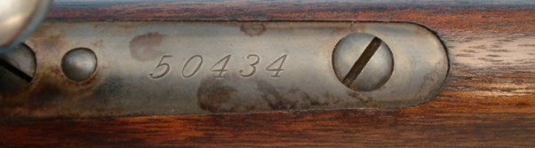

Thanks! And no worries, I knew the gun wasn’t going to pass the purity test when I bought it, but … wow. It’s so far off that I thought maybe I read the serial number wrong. Here it is:
No, it’s definitely 4621. So the next question becomes … Why? Why would someone go to so much trouble to create this gun?
Thanks again!
Dave

Bert, I’m no expert on 85’s but would Winchester stamp a serial number jumping a hole or was there a digit there ? The hole looks to be off center as well.

Dave,
The original serial number was not 4621.  Instead, it was 4?641.  The second digit was completely removed by the added screw hole (no doubt for the set trigger alteration).
Forum Posts: 14826
August 7, 2018 - 9:11 pm
Bob,
No, Winchester would not have stamped a serial number spacing it over a drilled hole.  The screw hole cut the serial number digit completely out.

Dave,
Anyone happen to have an image of a “0” in a serial number of the same vintage? Thanks!
Yes…

I hate to tell you this, but looking at the photo of the lower tang, I think the correct serial number sequence is actually 4?621.
Don,
You are correct, and I should have caught that.
