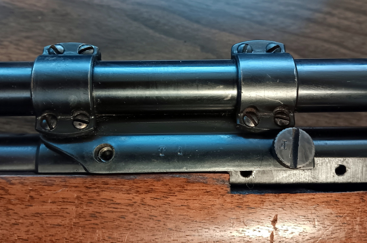

JWA said
Hi John,
If those are the original screws are you sure you need the Weaver T1 base?  All of the ones in my box have a smaller hole size, a 10-32 screw won’t fit through.  Possibly someone enlarged the holes on a T1 base to use the quick detachable screws?
Otherwise, I don’t know of a source for those vintage 10/32 thumbscrews, sorry.
Definitely a T1.  The rifle in question is a Winchester Model 69, and the rifle I pulled the sample screw from is my Winchester Model 72. See the attached pic of my 72:

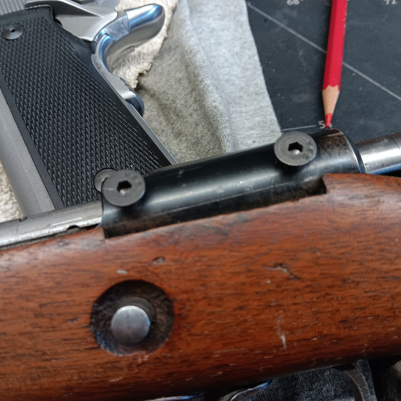

After searching the internet in vain I took a trip to the local Ace hardware.  Lo and behold, tapered shank 10- 32 1/4″ screws for 79 cents each. Not the knurled screws I was hoping for but they work and the price was right. Cool

My local ACE has a gun screw section, but they are limited to the usual size 6 and 8 screws of various descriptions and no knurled ones such as the one I pictured. They did have some black 10-32 x 1/4″ hex drive tapered flat head screws (pictured above) in the regular section that will work.
I was hoping to find a pair of the originals, but will settle for the ones that will work.  🙂

Good old Ace!  Those look good enough for me. It looks like those are star drive heads and the seem neat and unobtrusive.  At that price, you could buy some extras and try knurling the edges with a checkering file, then applying Oxpho blue solution.

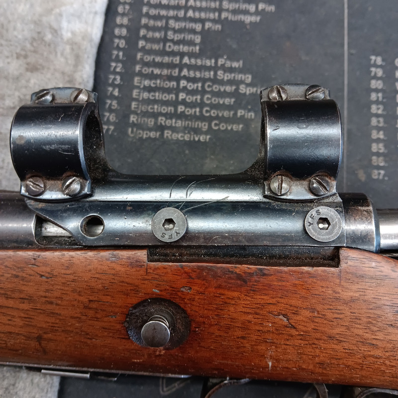

eBay delivers – a T1 mount for $27 delivered. I had to drill a new hole, but the screws procured from ACE did the trick.
Forum Posts: 2813
March 5, 2025 - 11:43 pm
Nice! Looks vintage now.  Thanks for the update.

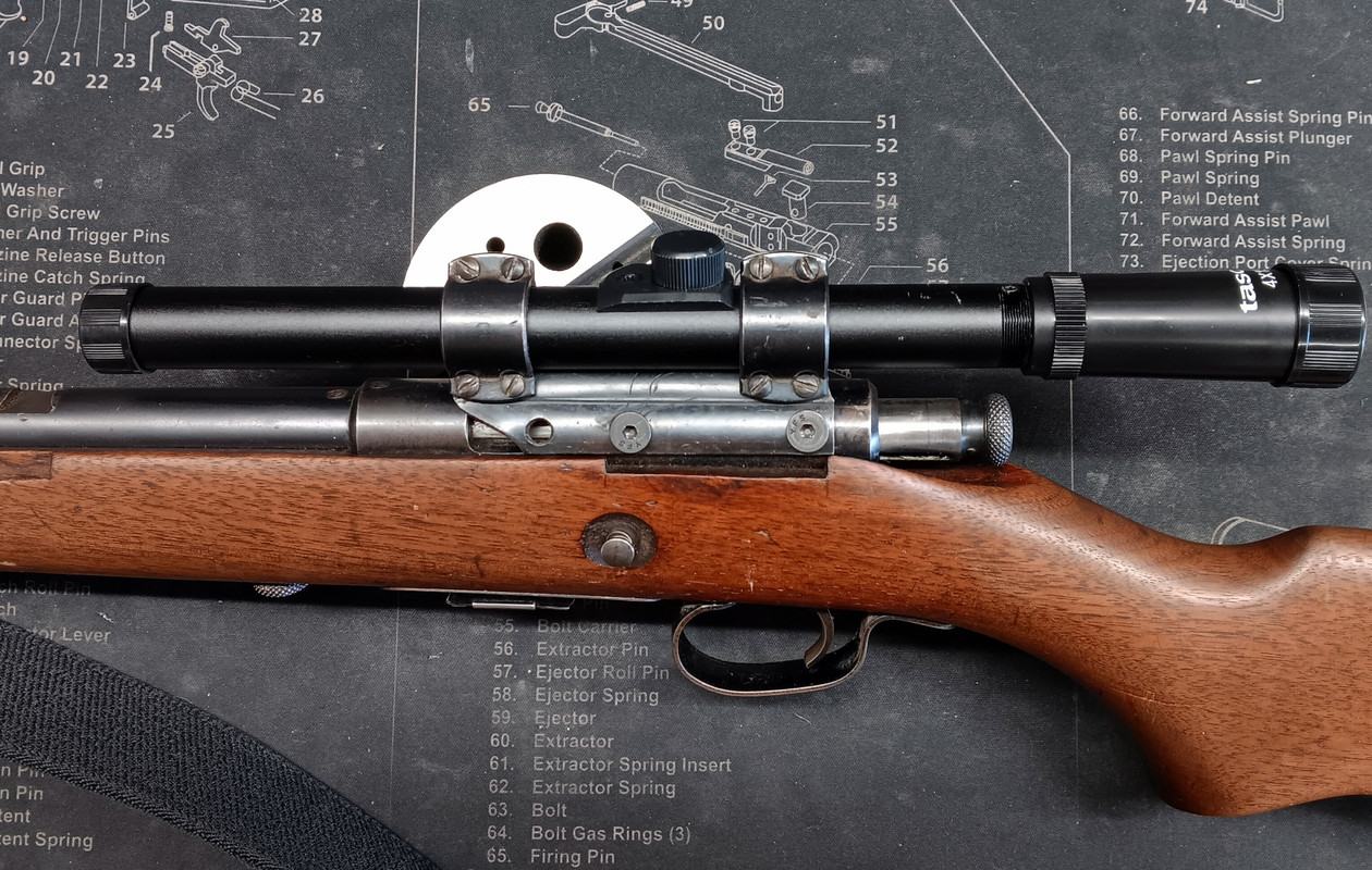

Just to finish up….   my friend brought over a scope, and this small little project is finished. He had originally bought a vintage Weaver Marksman from the auction site, but his wife dropped it and subsequently there were bits rattling around inside. So – he bought a replacement, this time a new Tasco, which I mounted for him.  He left the Weaver with me, and it turns out it was easy to disassemble, fix, and reassemble.
All I have to do now is take it to the range and get it zeroed.

That Tasco on the Winchester makes me cringe, sorry.
John D.
Star ID
Forum Posts: 214
March 3, 2020
April 2, 2025 - 3:33 am
Honestly, me too. But that’s what he wanted so that’s what he got. If it were my gun it would get a vintage 4x Weaver.
