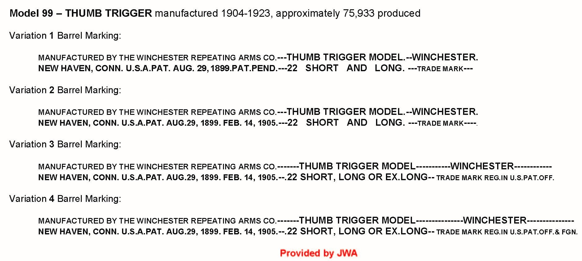

My Thumb Trigger is marked for 3 calibers. I am not sure, but I doubt any were made in Long Rifle. JWA would know for sure. Big Larry
Hi Larry,
No Thumb Triggers were made chambered for .22 Long Rifle.  The TT was dropped from the line prior to the addition of .22 Long Rifle to the low-cost single shot rifles.
Attached are the 4 different Thumb Trigger barrel markings I have (although there may be more?) just in case you are trying to collect all the variations.

My guess is that it is simply an 02-A barrel that has been swapped onto a TT stock since the TT had been discontinued for almost 5 years prior to the 02-A.
The TT and 02-A barrel exterior dimensions are identical so it would be an easy swap.

Not unless I find a real nice one, cheap. Right now it’s M1906’s and 06″s. Got 5 so far. Oh, and S&W’s. Don’t forget the S&W’s. Thanks, Big Larry
