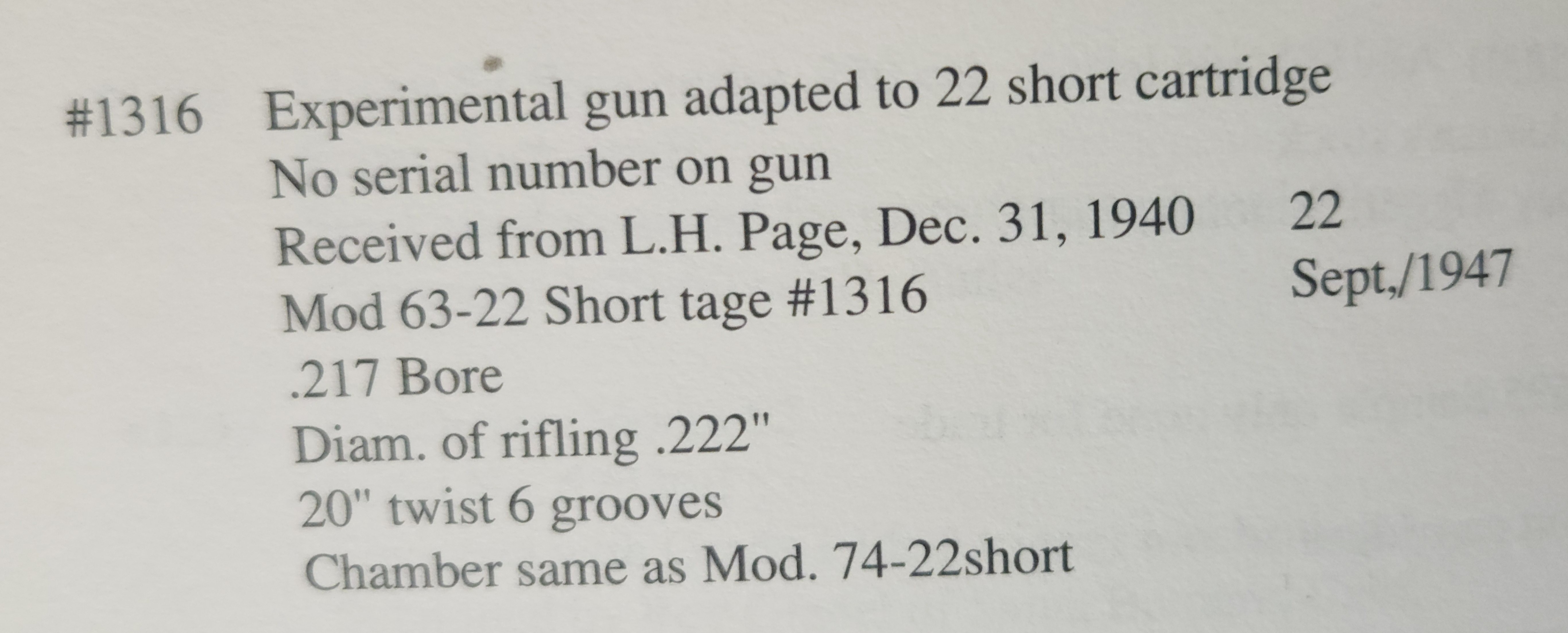

To add to what Bill was mentioning, Winchester DID experiment with the .22 Short cartridge in the Model 63.  There is a gun that was formerly in the Winchester Reference Collection (Tag 1316) that was one of the 63 experimental models in .22 Short and there were likely a few others.  I would have to do some research to see how many but Winchester’s C.G. Swebilius was working hard cranking out a plethora of .22 Short designs at that time and he produced more than a dozen experimental semi-auto rifles in .22 Short in a few months, and these when Winchester already had a “gallery” version .22 Short semi-auto Model 74 in the catalog.
This information in no way provides provenance for the RIA rifle but does keep the door open for possibilities.
