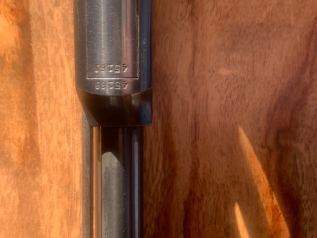

My Routledge is #42169.It was my first m61 and it took me about 5 years to convince my buddy to sell it to me.That was 40 years ago.Time sure does fly by!
I only have one Routledge bore rifle earlier than yours that is SN 41860.  Then yours.  Then 43582.  Then every other RB rifle is in the 45xxx to 48xxx SN range.  Could you please post some photos of your rifle?
Thanks
Kmbr

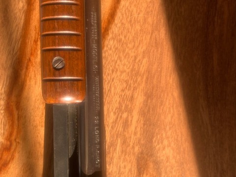

Sorry the correct # is #45169.Here a couple of photos.
That SN makes a big difference!  Thanks.  The photos did not make it.  Can you send them to me at [email protected]  Is there a “W” stamped between the serial number and the trigger guard?

IMG_4100.jpgIMG_4101.jpgHere are the photos.

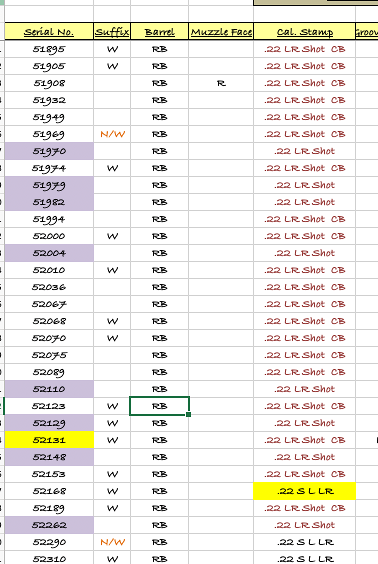

Forum Posts: 2765
38
August 16, 2025 - 11:27 am
rogertherelic said
The 61 I have is marked  “-FOR SHOT ONLY-” ser. no. 52131.  It has the “Winchester Counter Bore”.   RDB
Good morning,
I do have your rifle in my survey already and highlighted in Yellow in the attached image.  The other highlighted serial numbers are rifles that I have seen but were not described as counter bore variations but I highly suspect that they were.  If anyone haas one of these rifle PLEASE contact me to clarify the barrel design.

August 16, 2025 - 3:20 pm
Thank you for the clarification.  RDB
