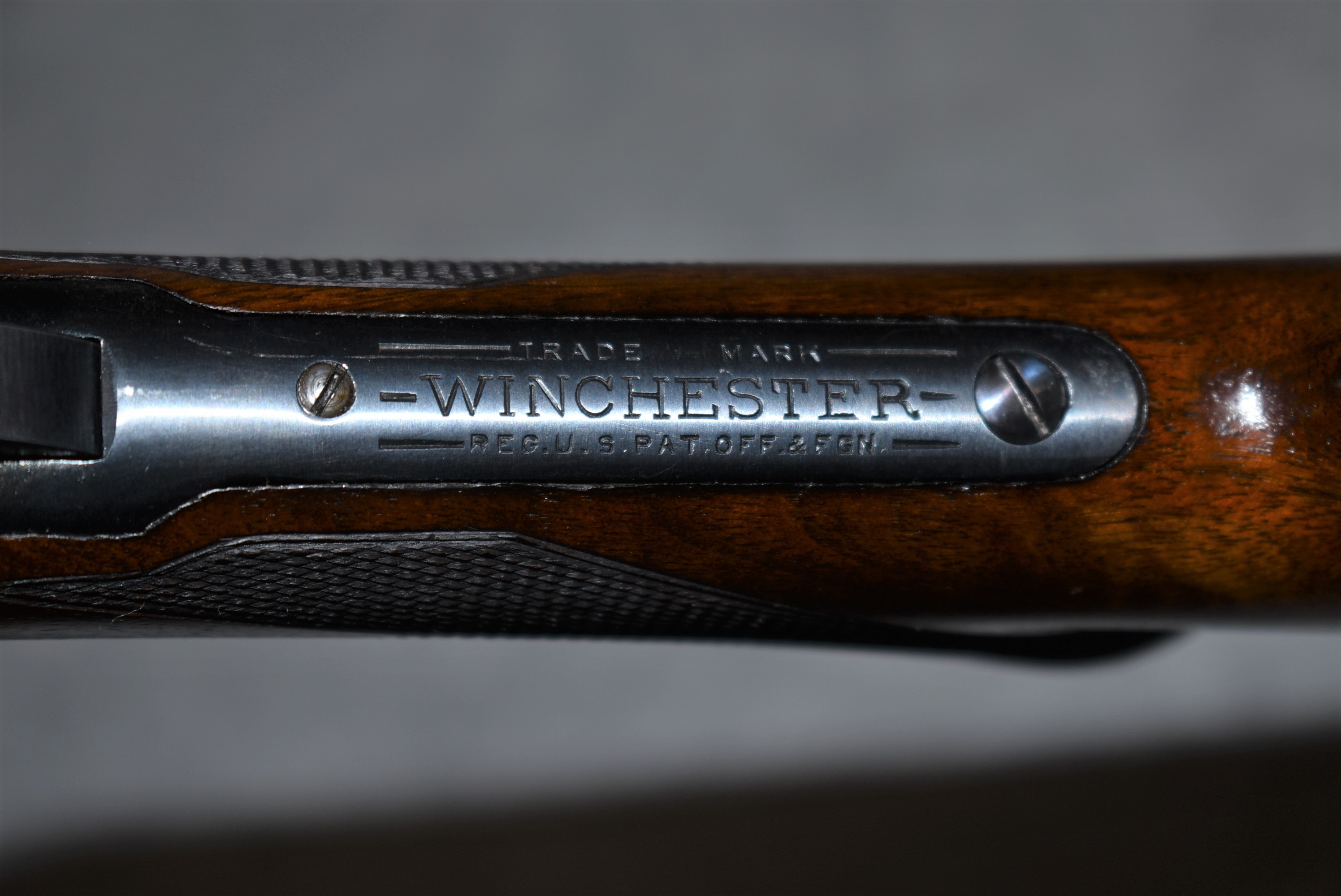

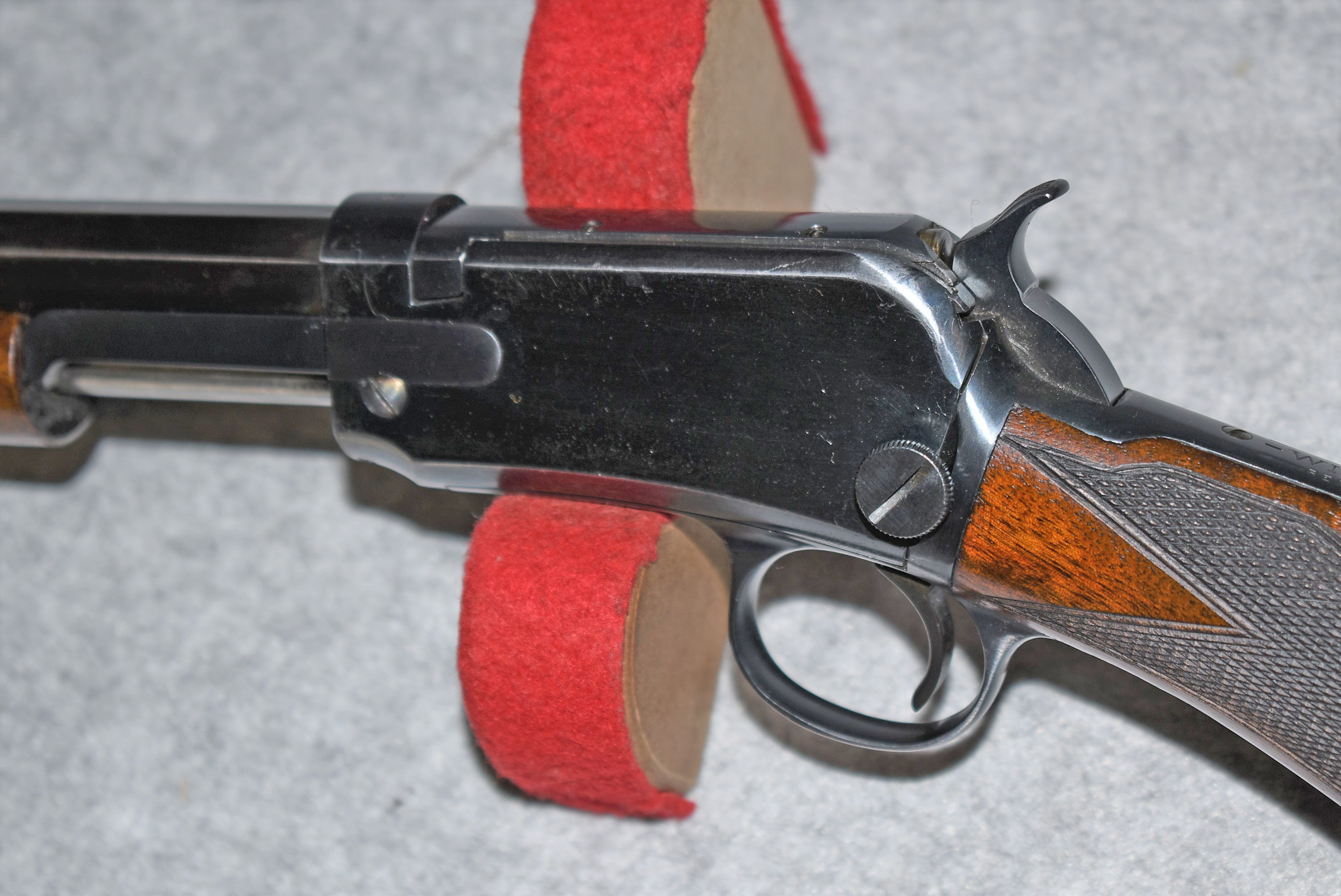

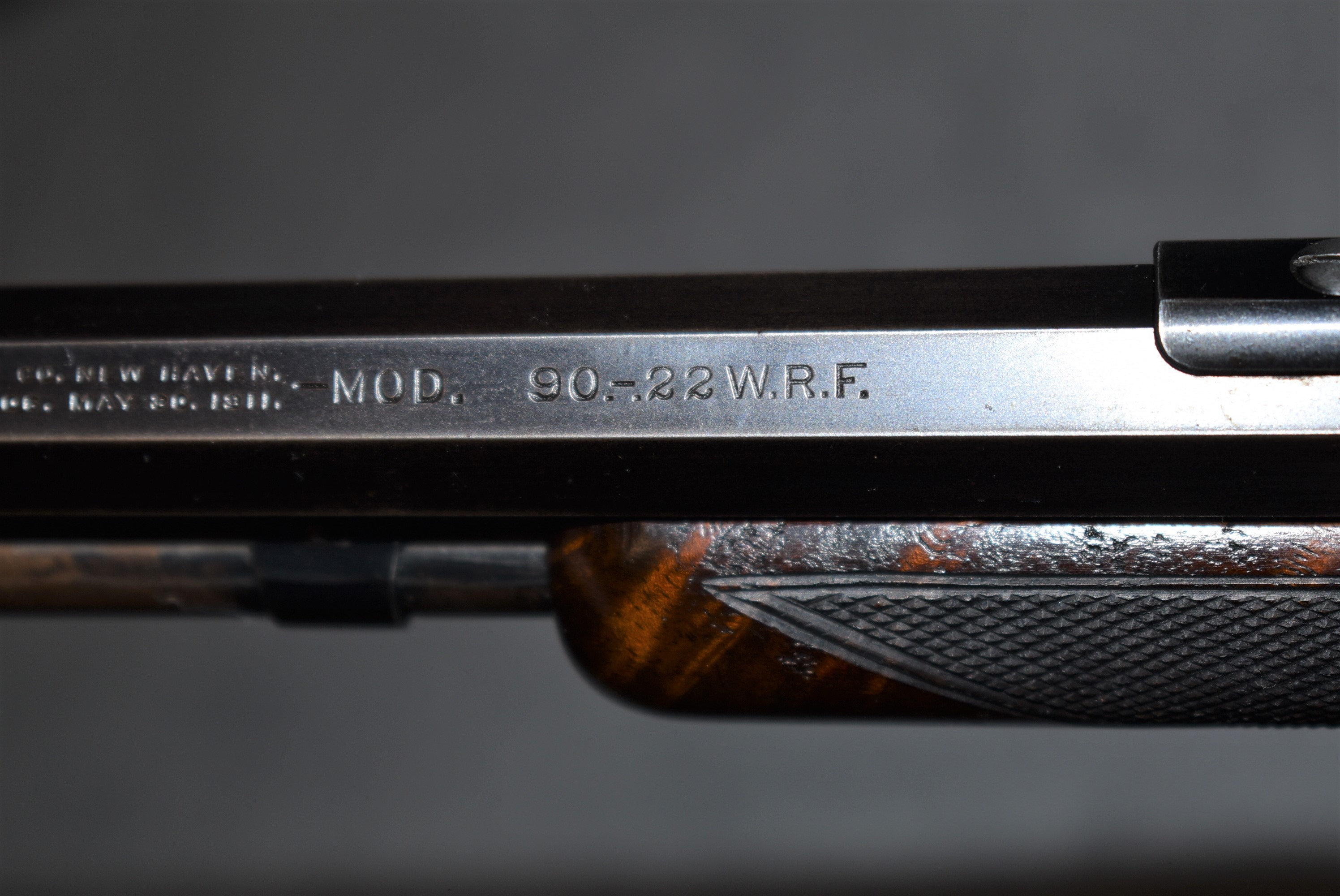

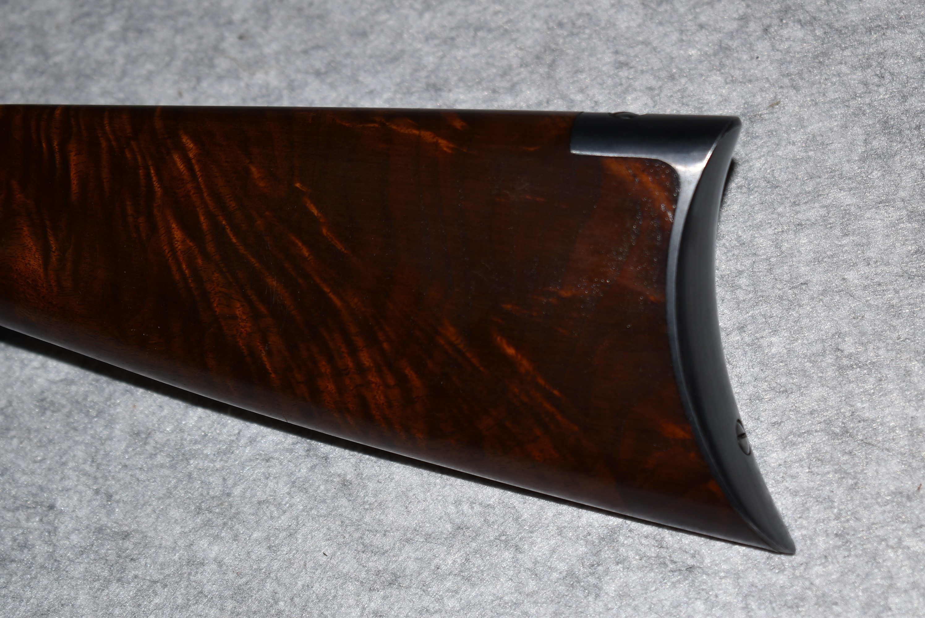

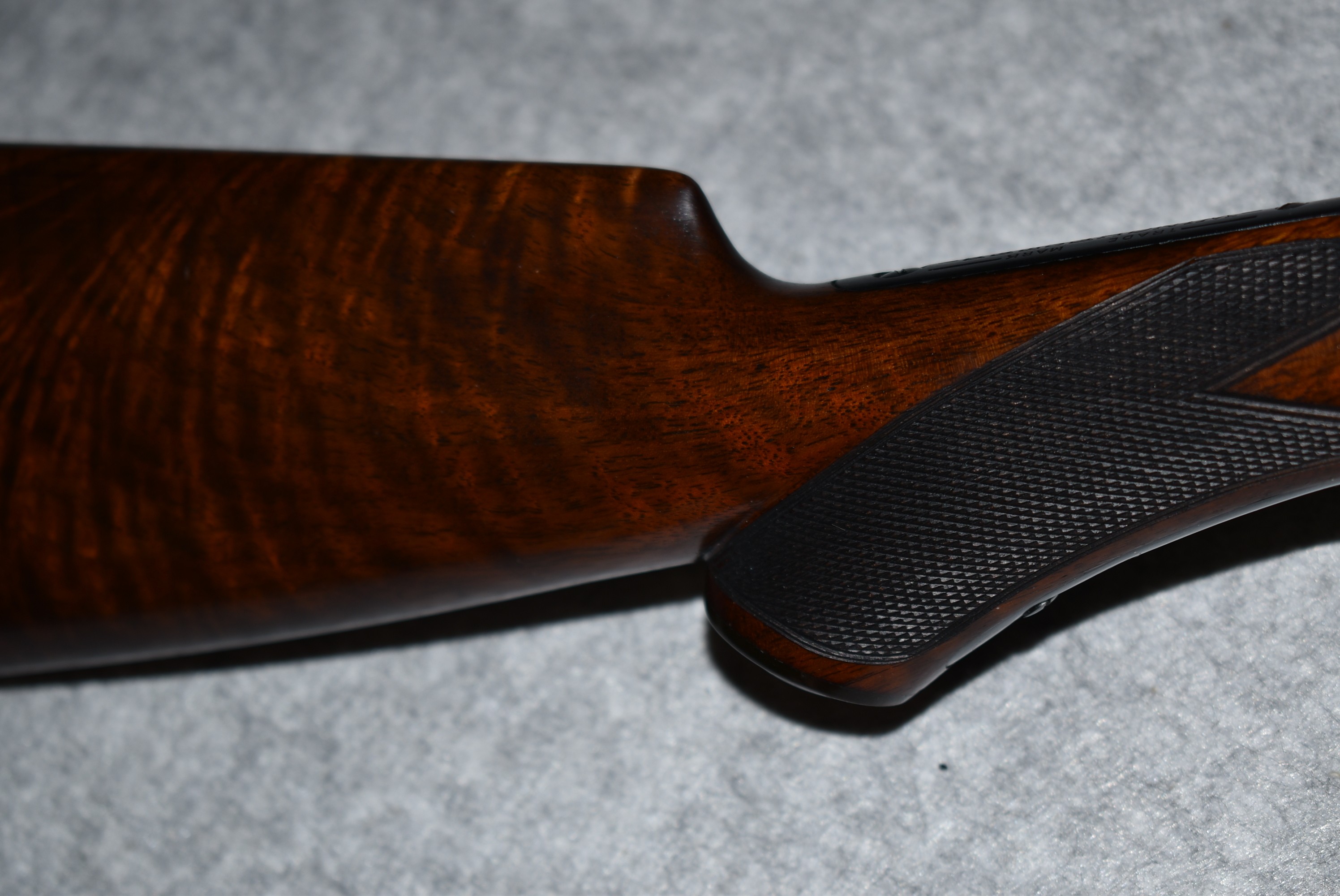

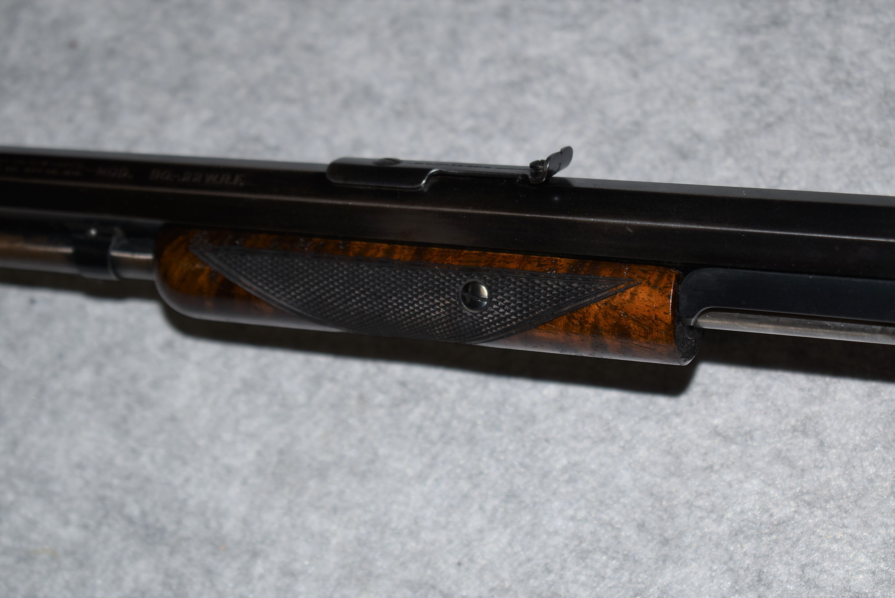

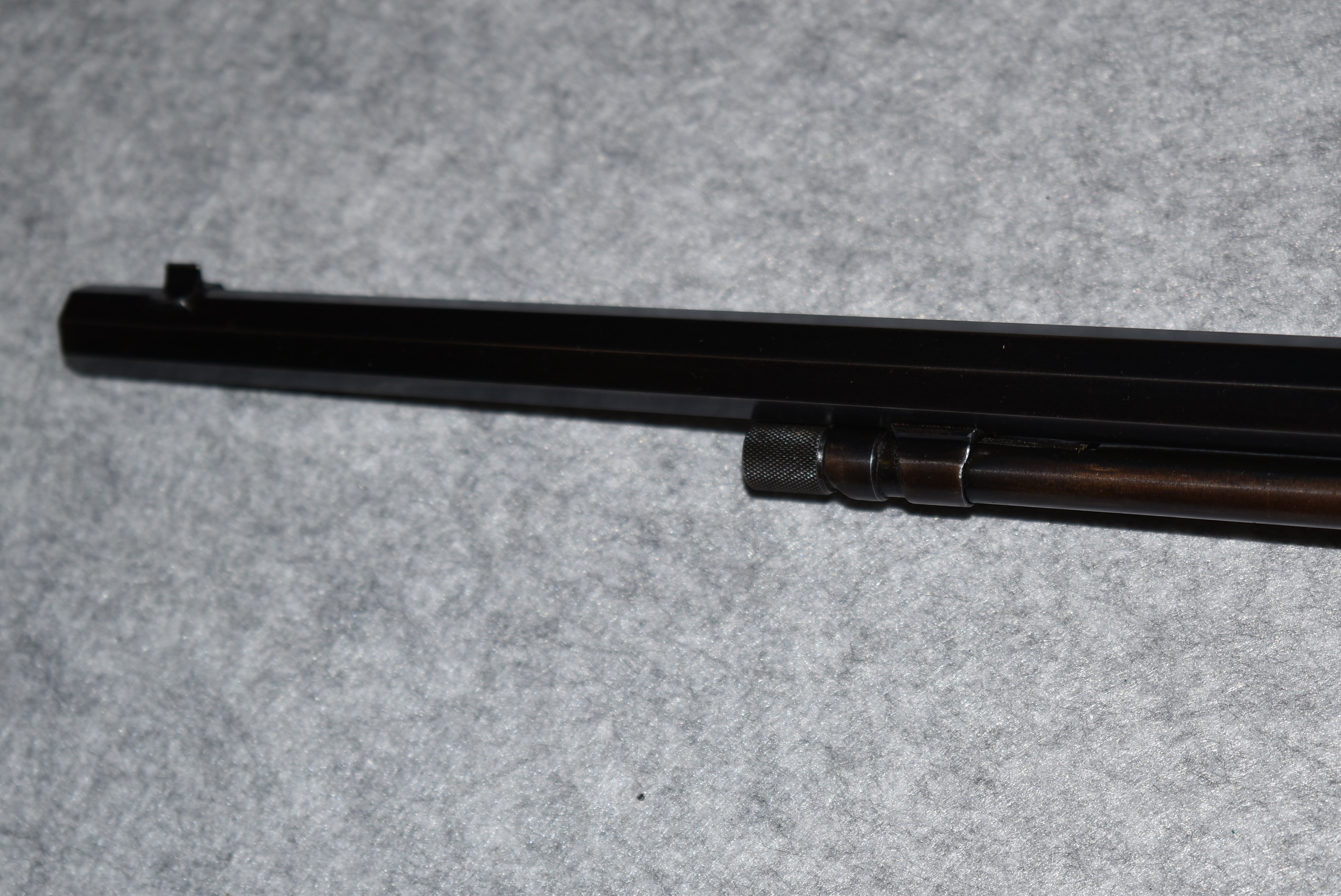

Per Rustyjack encouragement I am posting photos of the subject Model 90 Deluxe .22WRF.  Serial # puts it as 1920.  Whatta ya think: right/correct, reblued/refinished, value?
Thanks
Mac

Good looking Model 90 Fancy Rifle!

The pictures are too dark to see the details.  I lightened up a couple.  Looks good to me.  I haven’t kept up with the prices after I sold my collection but I’ve seen people asking 5 figures for these deluxe guns.  Can’t say what they actually sold for.

I wish the pic’s had better lighting, from what I can see, it looks original to me. The checkering is the most difficult thing to protect if refinishing a deluxe. Even if properly masked there are trace amounts of finish that will be present on the outside border of the checkering. This can be removed by “freshening up”  the checkering which has not happened. The metal also looks good in my opinion, the only discrepancy is the tang plug screw which has no finish on it, that certainly does not match the rest of the tang. Possibly had a tang sight that was removed prior to being offered for sale or some place along it’s long journey ???  If you end up with it, drop me a note. I have several original plug screws with good original blueing.
As far as Price, I would check the auction sites for recently sold, condition comparable items.
Nice Rifle! It would make a wonderful addition to anyone’s collection.
Erin

Beautiful 90 deluxe …… looks correct to me as well. I have one that’s similar with a straight grip and H checkered buttstock and slide in 22LR. Mine is quite a bit later production – 1930. The checkered slide really sets these apart form other deluxe 90’s. I’m not sure when they started offering that variation, seems like the later ones, but couldn’t say for sure. Nice find ….. hope you are able to get it.

I’m no expert but I’ve owned/still own a few “deluxe” and “semi-deluxe” 1890/90s for reference. It looks correct to me. Better pictures would help a lot. I hope you get it and can share more about what looks like a fine rifle!

I examined that gun first hand a couple weeks ago, beautiful, looked right to me.
