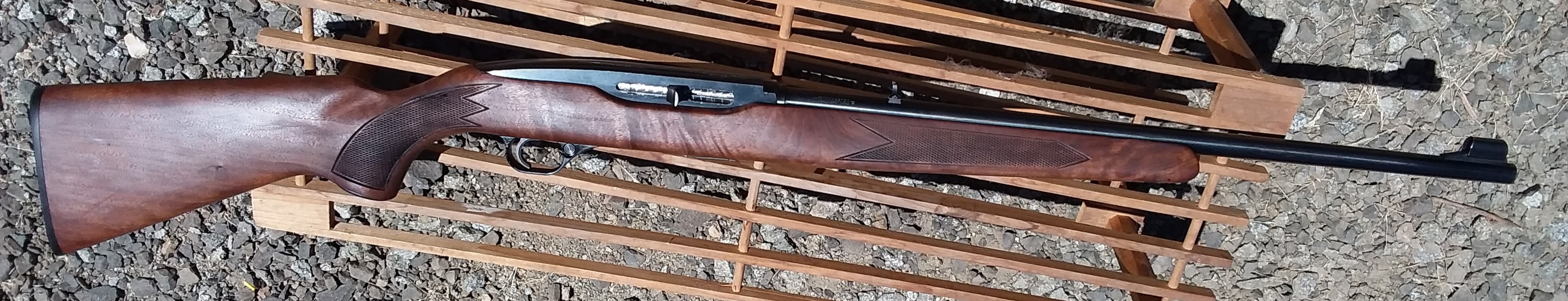

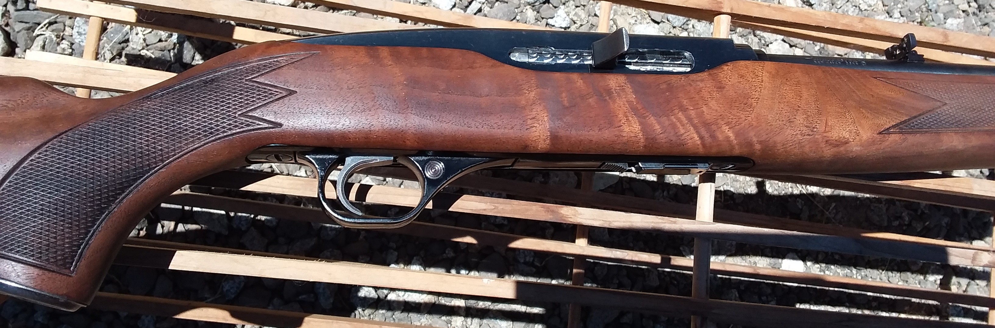

Since at the time Winchester was using tinted/stained lacquer, I tint some pure Tung Oil and apply it like we do linseed oil. Apply small amounts by hand and hand rub oil into the wood, many coats sometimes needed. It gives a very durable waterproof finish. You must use pure Tung Oil , no driers added.  This is my model 490, who’s finish had been water damaged.
Winchester-490-1.jpgWinchester-490-2.jpgWinchester-490-3.jpg and my 06 which was from a beyond repair bin.  Winchester-1906-2.jpg
