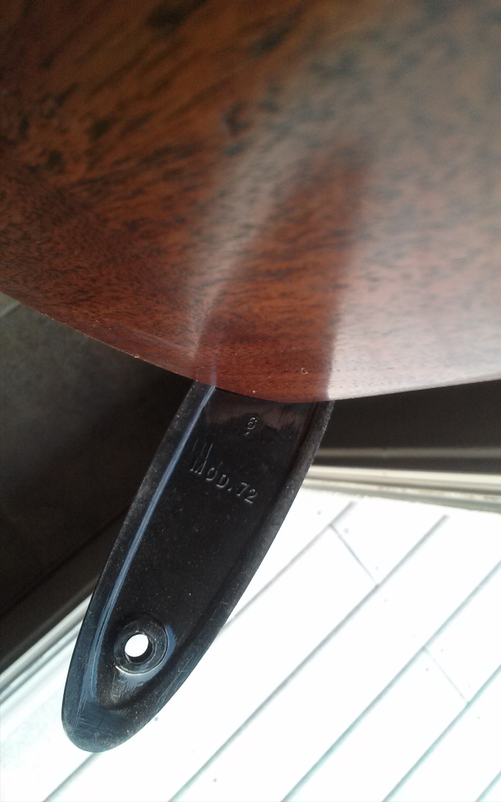

5BEAE0F5-0F3D-474F-9FD4-656BA4C370AE.jpegE732C3D5-998B-44FD-8113-EA44D2B82818.jpegAny encounters with the black moulded model 62A buttplates being marked M-72 on the inside .  Rare day you don’t learn something , sold a 62A to a fellow that was concerned when he took buttplate off and was marked m-72 . I suggested it is correct likely parts cleanup . His 62A was 1952.  I removed a buttplate from my 61 mag C 1960 low n behold marked m-72 . Grabbed a parts gun I had gathering dust c1948 . Same same . M-72 . Buddy is still a doubting Thomas .  Any feed back is appreciated  thx .

Looked at just one of my 62a rifles. Looks like yours.

The newer style Butyl Acetate butt plate was first used on the new Model 72 in 1938 so Winchester marked the mold “M-72” however the same buttplate was then used on the post-1938 models 67, 67A, 68, 69A, 62, 62A, 47, 55 and several other rimfire models.  Winchester used the same mold for each so post-1938 they are all marked M-72 on the back.

Thank you very much .  Amazing over 40 years and dozens n dozens of 62’s through my hands .  Been a good day I learned something .  Mystery solved . Case closed . I won’t delete topic may be useful to someone else

Hope someone here has more information.  If I had to guess I would say the M-72 refers to the size or model of the butt plate and not the gun it is put on.
