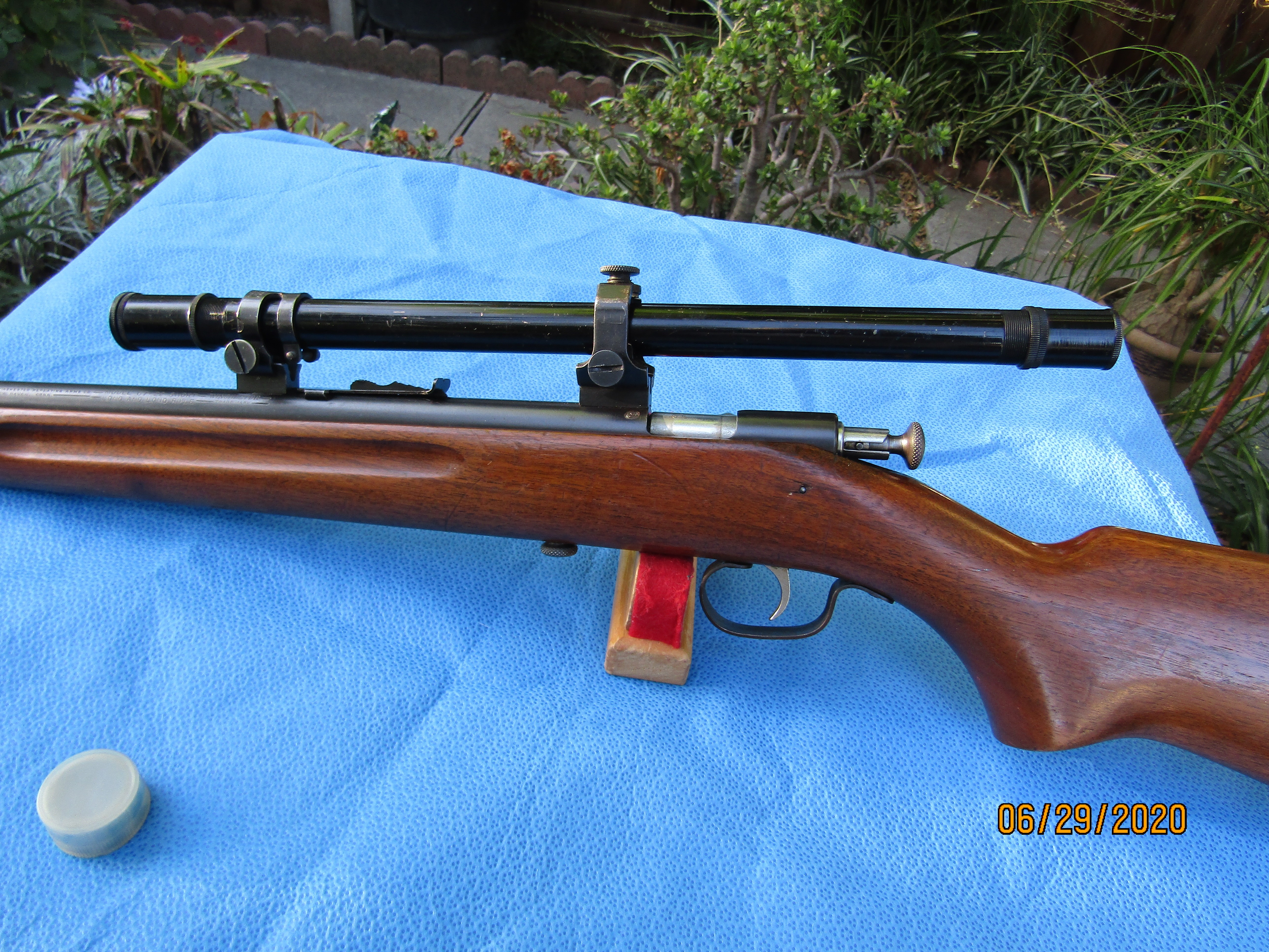

rogertherelic
Santa Clara, CA
Forum Posts: 988
January 27, 1992
June 23, 2025 - 6:34 pm
This is a picture of my Duel Sight 67 for comparison.  RDB
