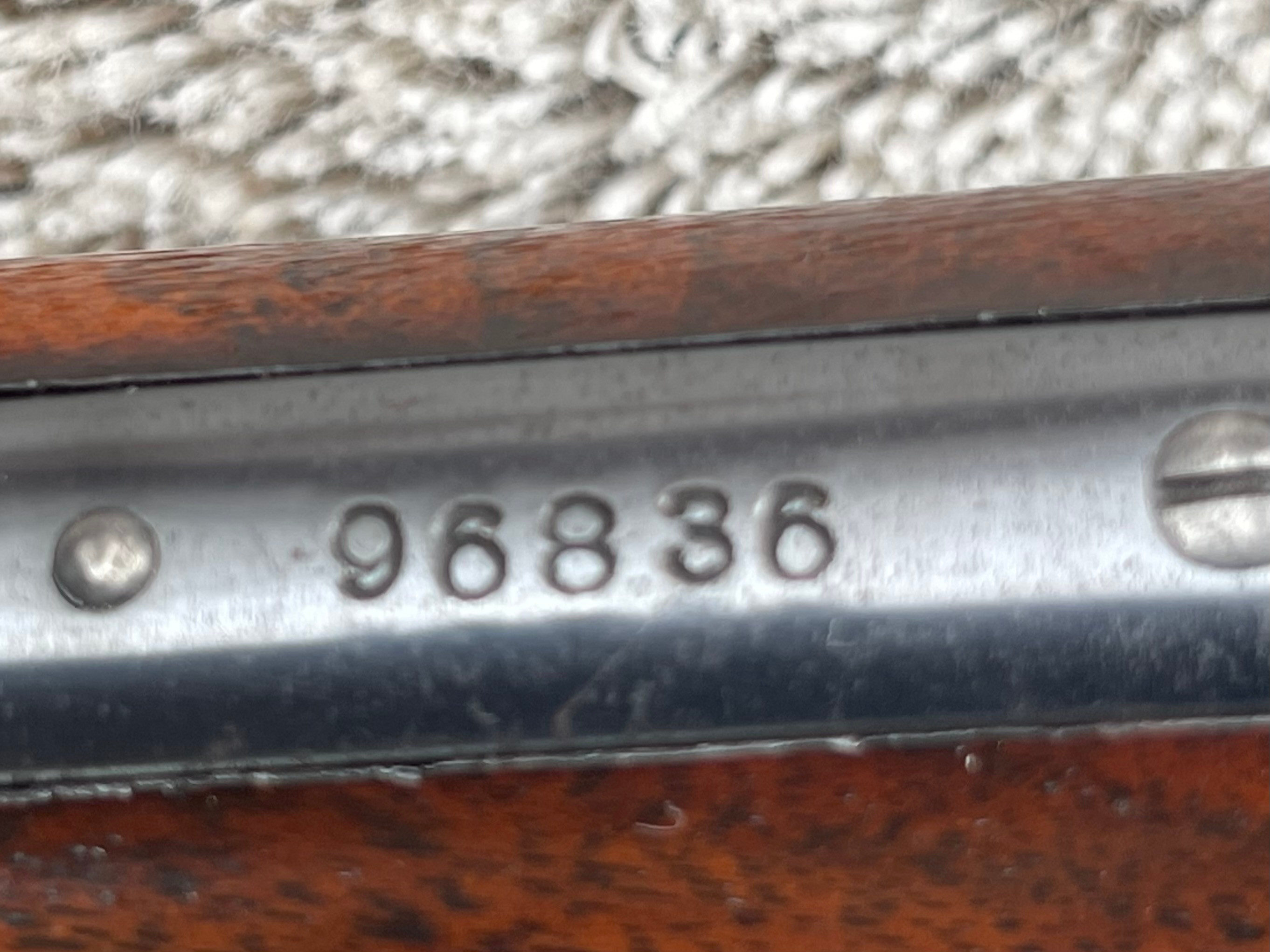

Forum Posts: 2127
April 3, 2025 - 5:03 pm
Thanks Bert,
You’re information helps out tremendously here as I’m trying to prove a point, based on facts, and not add to any possible mystery.
I had my friend stop by, with another example, of what I can call a sister to the rifle in question. He chose to make a deal for this, so called, “Experimental”, rifle, in his words, for about half of, or maybe a little more than half, of what the Gun Broker rifle, is the Buy Now Price!
Serial number # 96836A. With all the same similar comparable added similarities, as the one on Gun Broker. This one was looked at by, the Late Felix Bedlan, years ago, at an OGCA show, in Cleveland, that I suggested, to my friend to, get an opinion from, who purchased this from the same guy, that I claimed, the other one came from. Felix said, “No way Winchester did this work”! For those that don’t know or heard of Felix Bedlan, from Fairbury, Nebraska, he was a very well respected, and older gentleman Dealer, from years ago. His wife was a sweetheart to talk to and deal with, as they we’re at many shows back in the day. A no nonsense Dealer that knew his Winchesters! IMHO!
Facts;
I never saw any of these guns put together. Nor did I ever see these two guns together as a pair or set, etc……….
Both of these we’re mfg. in 1939, based on their serial numbers that put them, 878 digits apart.
One of the only differences that I noticed, was the copper solid rivet , in the middle of the top of the vented rib, on the second one my friend owns. The first one shows a small screw, matching the other fasteners on the rib.
IMG_9047.jpgIMG_9049.jpgIMG_9051.jpgIMG_9052.jpgIMG_9054.jpgIMG_9057.jpgIMG_9060.jpgIMG_9061.jpgIMG_9064.jpgIMG_9065.jpgIMG_90661.jpgIMG_9067.jpgIMG_9068.jpg
