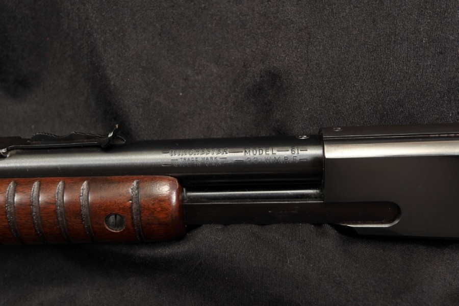

l started seeing ads in 1958 for the Win. 61 in 22mag, l wanted one real bad and had to do some saving l was able to buy one in 1961 with a tread in a Mossberg 346C l still have the bill of sale Sept 1961 without looking for the bill of sale balance due was around $28 dollars with my tread in, my serial number is 2920XX that puts my rifle made in 1959.l wasn’t sure how to post an image but l did it. l still have this rifle.
https://i.imgur.com/0LN7FKDl.png
Forum Posts: 14969
April 6, 2023 - 1:44 am
The DOM chart you posted a copy of is bogus. Per the actual Winchester records, your Model 61 was manufactured in the year 1960. The last Model 61 serial number manufactured in the year 1959 was 278022.

The first magnum version of the Model 61 rifle was in the SN 284500 range and corresponds to 1960 production.  There were just short of 20,000 magnums produced that year.  Can I get the last two digits of your SN so that I can add the rifle into my research survey?  Any chance that the caliber designation is stamped .22 W.M.R.F. on the left side of the barrel?

Sure you can 292083

l jump on the reply too fast, l just took thes pictures, if you can delet duplicates if l try l would mess things up.
https://i.imgur.com/Gnxg7B3.jpg
The white spacer l add when l was in Alaska in 1964 long winter’s.

Thanks for the SN.  I already had the rifle listed from a post that you had on Rimfire Central.  Ypou have taken good care of the rifle.

All my rifles look like that l use them but don’t abuse them. l did post information on RFC.
