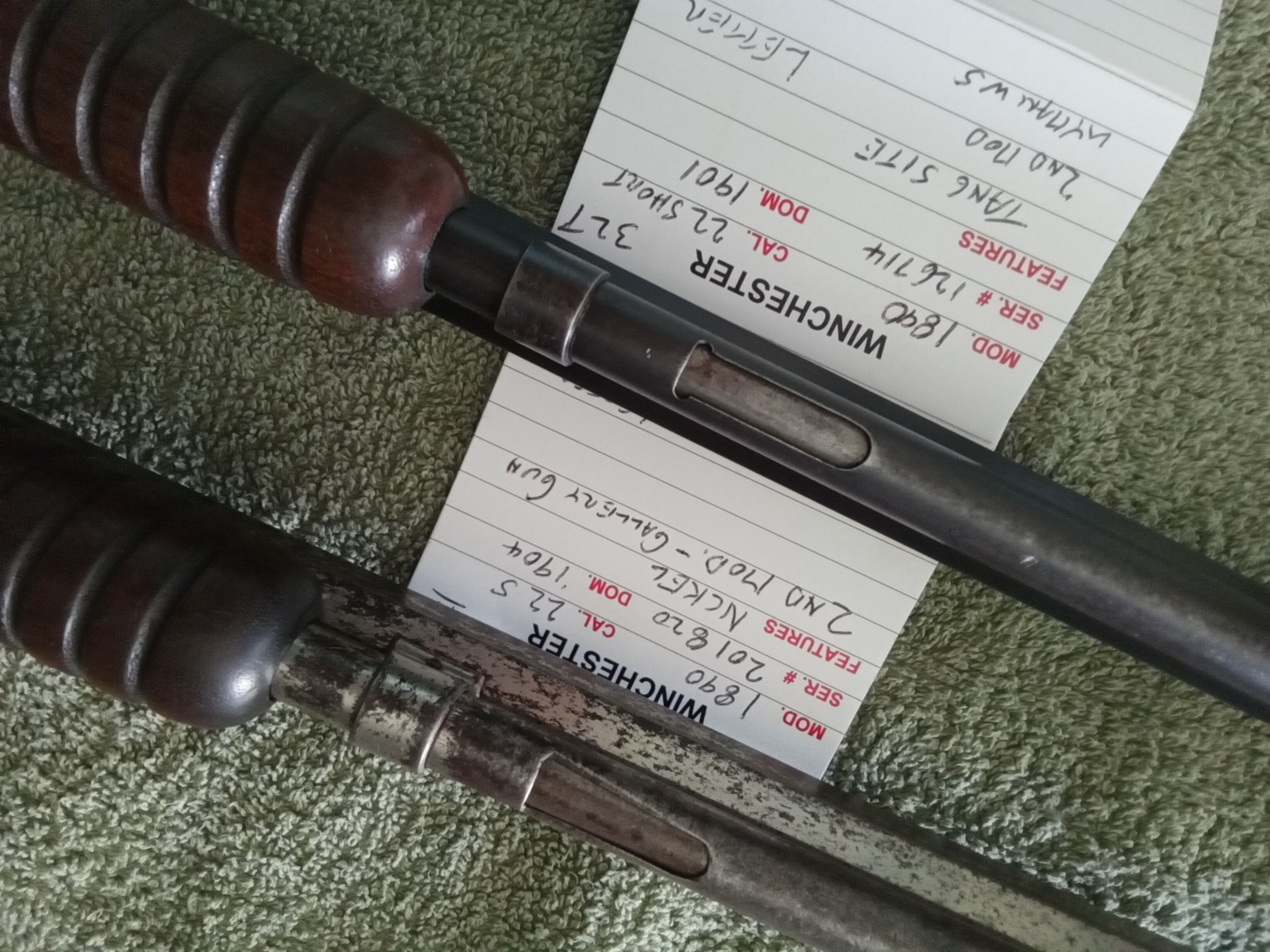

Heres a couple to compare, both guns letter
Hi Henry,
Does the 1890 letter as a “gallery” rifle?  I don’t recall ever seeing that on an 1890 letter.
Thanks!
Forum Posts: 1619
June 22, 2025 - 11:52 pm
No it doesn’t, it does letter full nickel.
