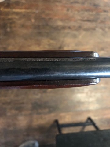

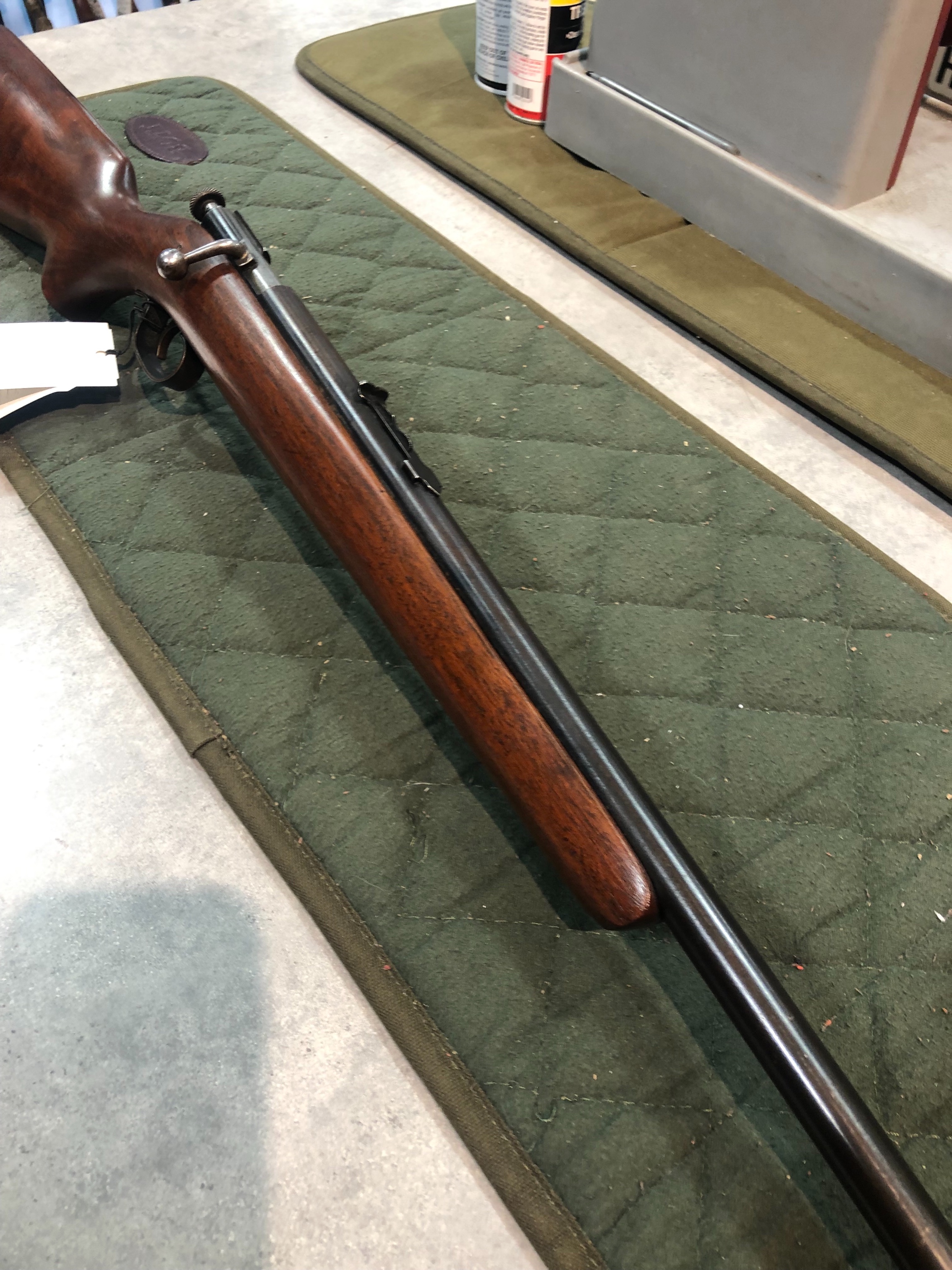

Wondering if anyone here has some knowledge on the Model 60a sporting with 23” barrel.  All these that I have seen have a proud take down screw and this one is flush like later models. The stock looks period to the gun. It is thin like you want to see them just doesn’t have a proud take down screw.

I just looked at three of mine and the screw is sticking down on all three. Maybe someone changed it, or, it is a very late rifle, but that being the case, the M67 followed this rifle and the early M67’s have the screw hanging down. Does your rifle have the cutout on the bolt for the late safety? I have seen many variations of the M60 and M60-A. All 3 of mine are different.  Big Larry

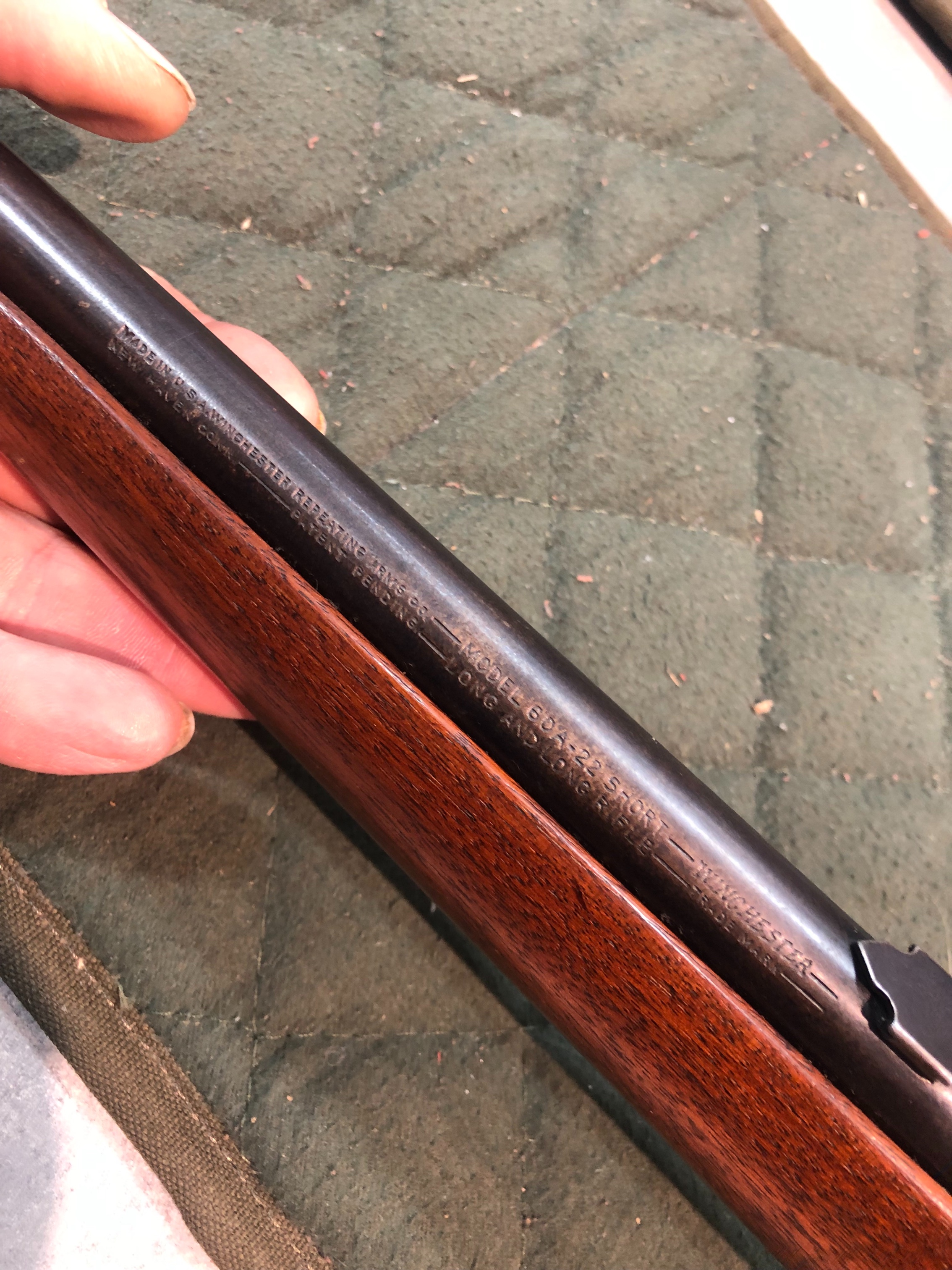

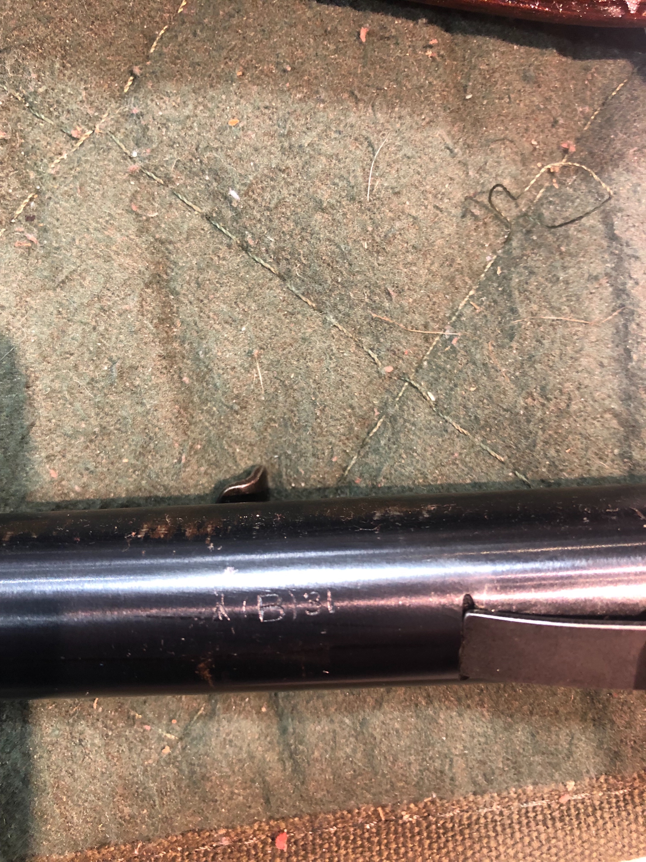

i was looking at this at a LGS with interest in buying it but the take down screw has me concerned. I first thought maybe it was put together late in production but it has all hints of being early. It has the early bolt without the safety window. The barrel date is 31 and 23” barrel. If you look at the pic of the barrel address you’ll see the wood is riding low like the early thin stocks did.  Maybe the take down screws not a big deal but I like em to be right.

That stock appears to be from a post-war Model 67.  It does not look original to the rifle.
The Model 60 and 60A stock had a butt plate marked “Winchester Trademark”  The post-war Model 67 stock butt plates did not say “Trademark”.

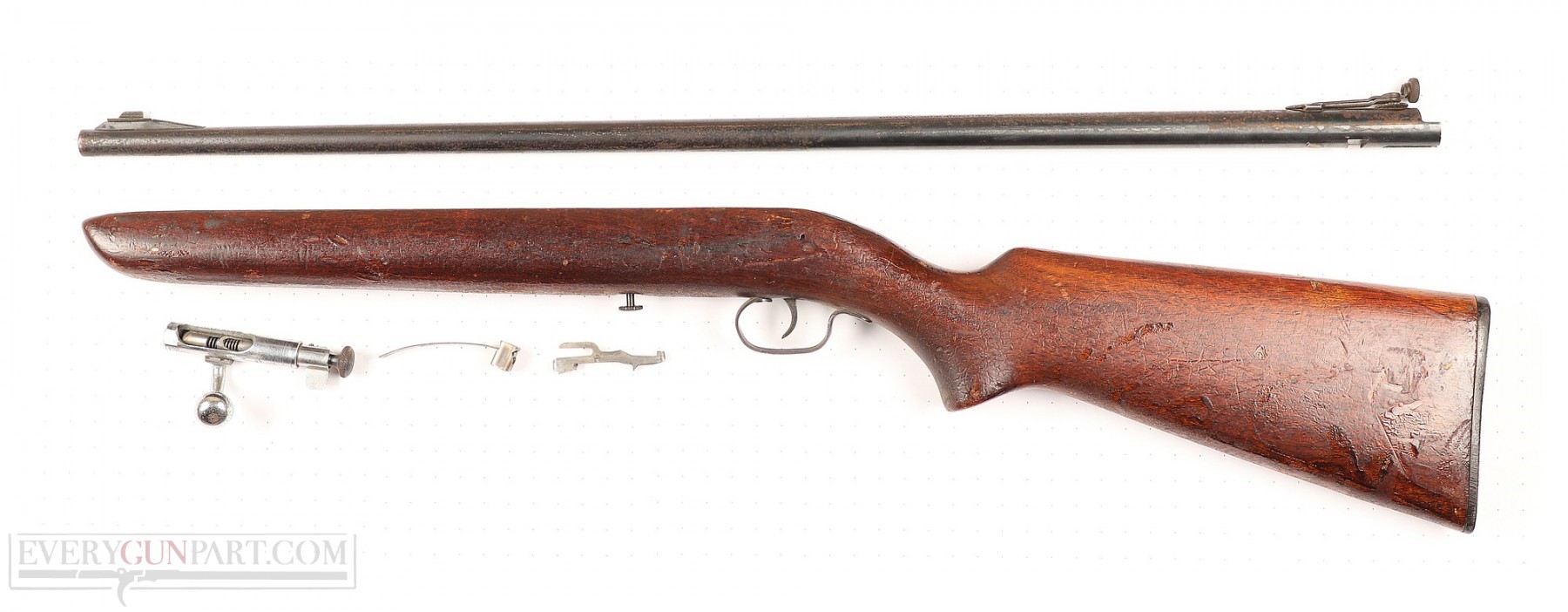

I do believe I have solved the mystery.  Found this pic on the web and I believe it is a Model 68 made right after the finger grooves were eliminated.

The Model 67 and 68 used the same stock. The stock that replaced the finger groove one had the blunt fore end. The last one you pictured looks more like a post war stock.

I own a post war model 67 and the stock that is on the 60a is similar but not the same. It has the tapered fore end but dimensionally it is thin like all the early proud take down screw stocks. I got out my post war 67 and compared it to my last pic and I fold the mystery continues. The nest time I am at the gun shop I will get more pics of the stock.

It’s a baseball bat.  Big Larry
