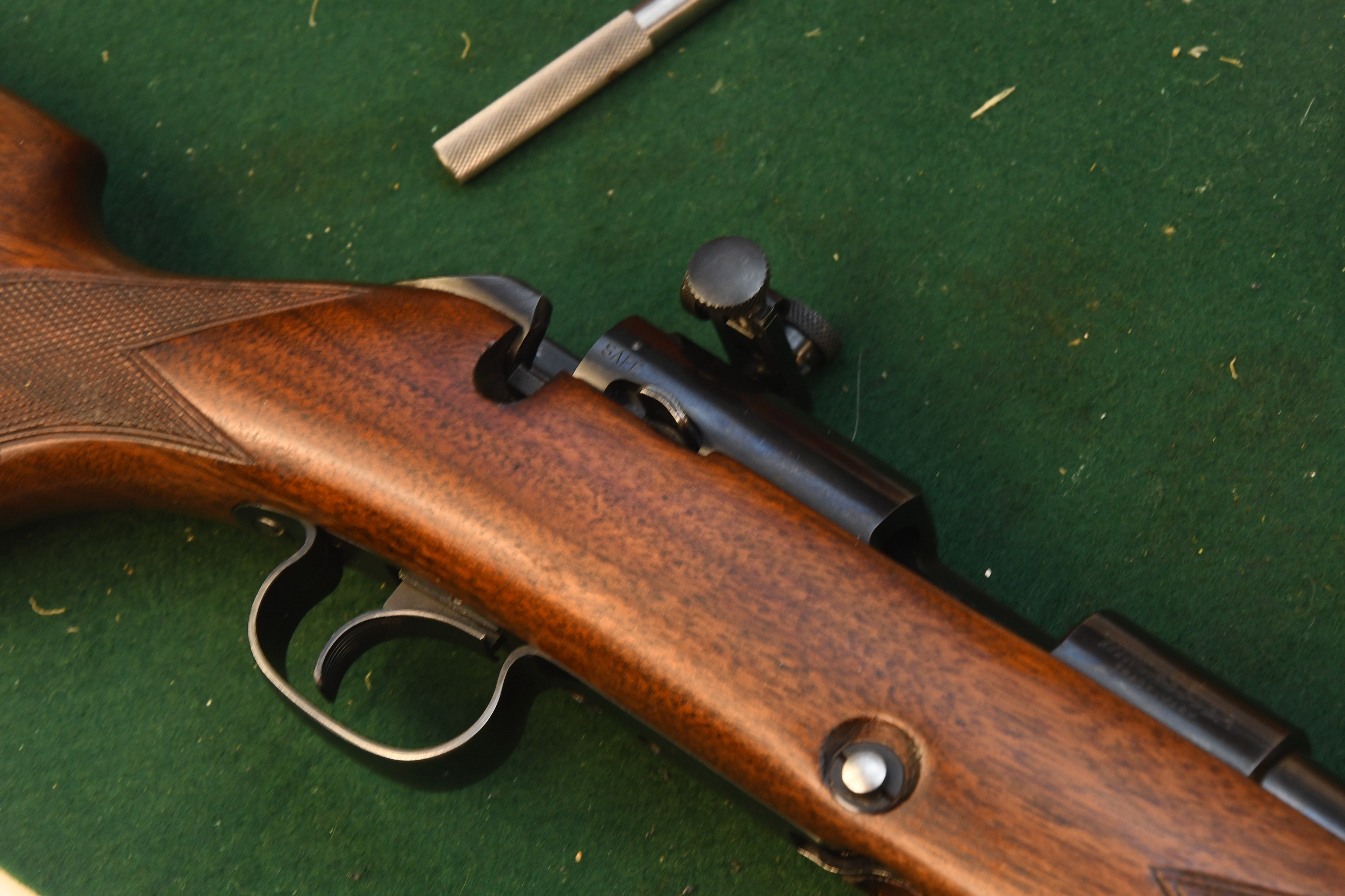

I can contribute a little on this one. Mine is 99076C a 1960 vintage gun with original metal and wood finishes.
The basic configuration of the C Sporting in question is correct for a late G5272R. It has the Micro-Motion trigger,  poorly executed checkering diamonds, plastic M88/100 buttplate, and brazed (non-integral) sight ramp.
What is missing is the original #3279 sight hood. The image of the hood Ive attached is a marginally lower #3278 because the #3279 is impossible to find.
The blank in the sight ramp is appropriate for the G5272R version of the Sporting but it is the wrong blank. The correct blank is Lyman’s “FS” blank that doesn’t overhang the dovetail as does this one, which is a blank designed for a rear barrel sight dovetail. With this one in place, a sight hood could not be installed.
While images can be misleading, I’m pretty sure both wood and metal have been refinished. I’ve attached an image of the wood finish on mine.  Much more subdued. The finish on the subject rifle is too bright and a little thick.  To me, the metal finish is too black. Mine is a bit worn in places but original.DSC_0289-1.JPGDSC_0291-1.JPGDSC_0293-1.JPG

Oh, I missed the obvious. As Tony says, the buttplate does show some honest wear underneath its coat of finish or wax but the bolt knob shows no wear at all. Zero, zip, nada.  What is the first blued metal part to show wear, besides the floorplate at the carry point?
Re-blue job, Q.E.D.
