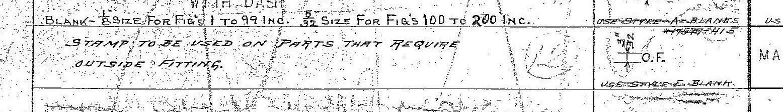

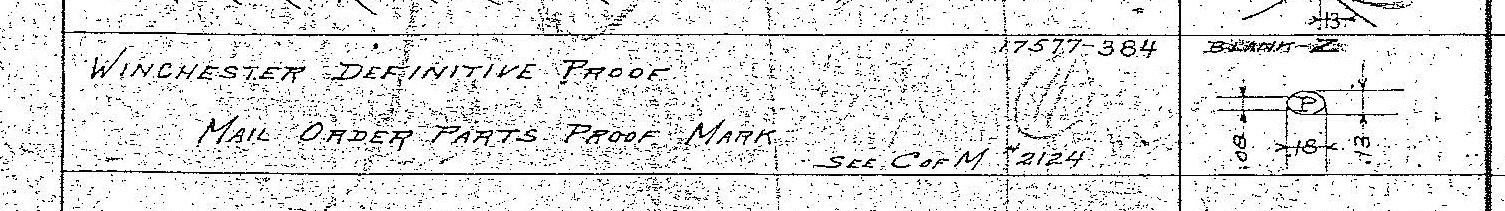

O.F. is the stamp used for parts that required outside fitting and a single “P” in an oval was used to denote mail order parts.  The following excerpts are from the Winchester ledgers at Cody.

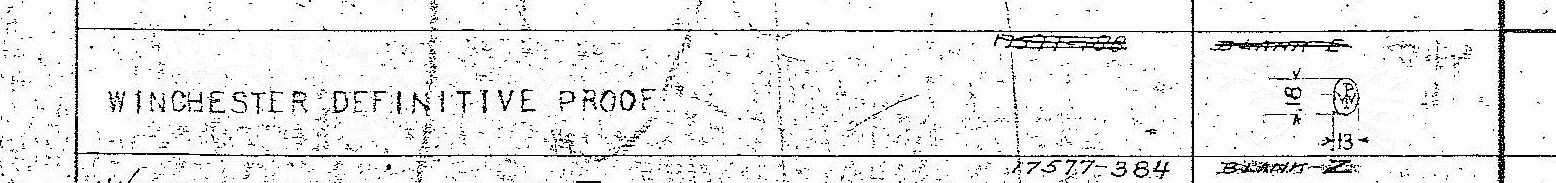

And here is the Winchester Definitive Proof “WP” in an oval which is applied when a rifle is proof test fired at the factory.
