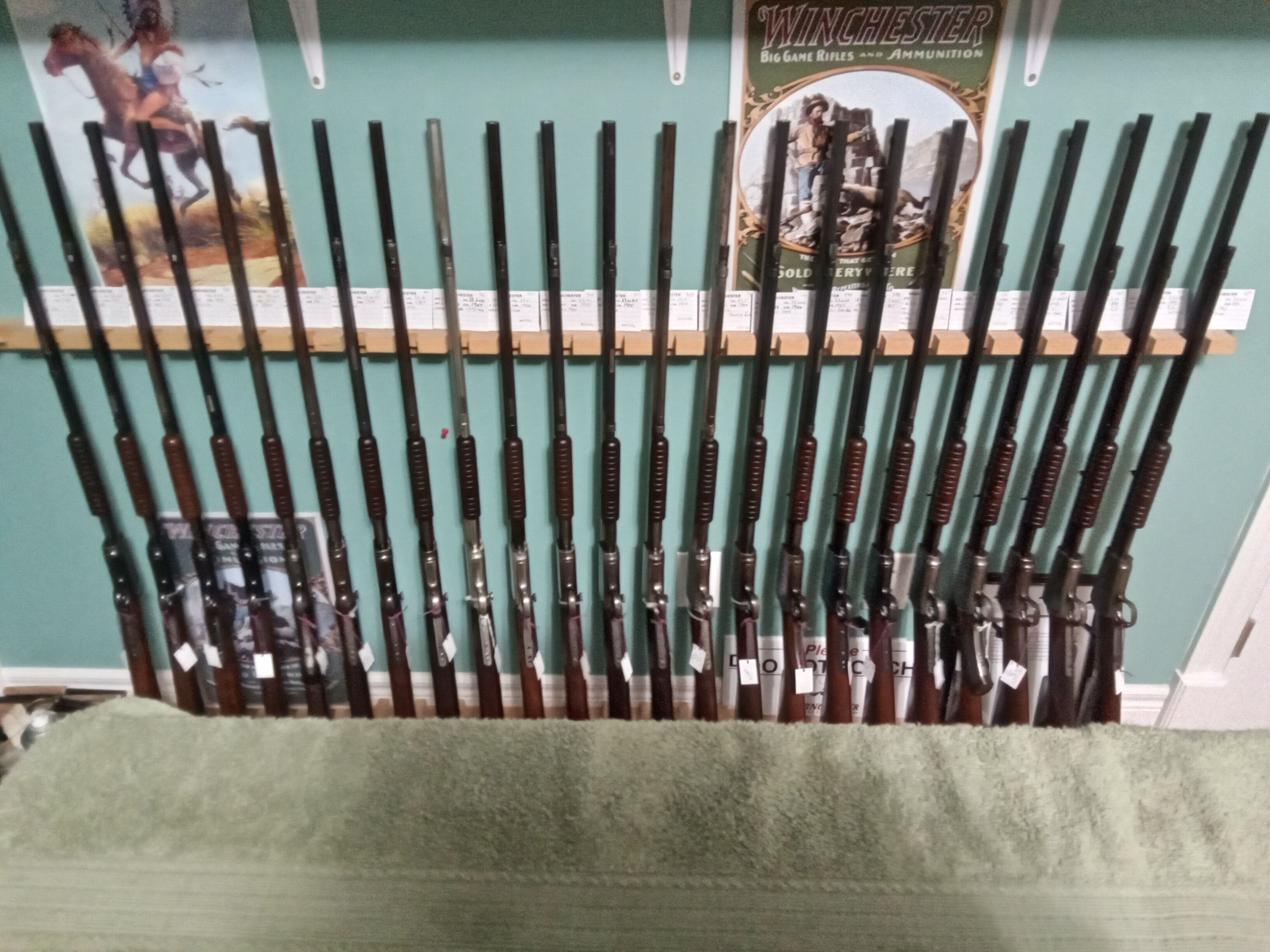

Welcome to the “sickness”, and good luck with only oneSmile 20251021_093007.jpg

Wow that is great
