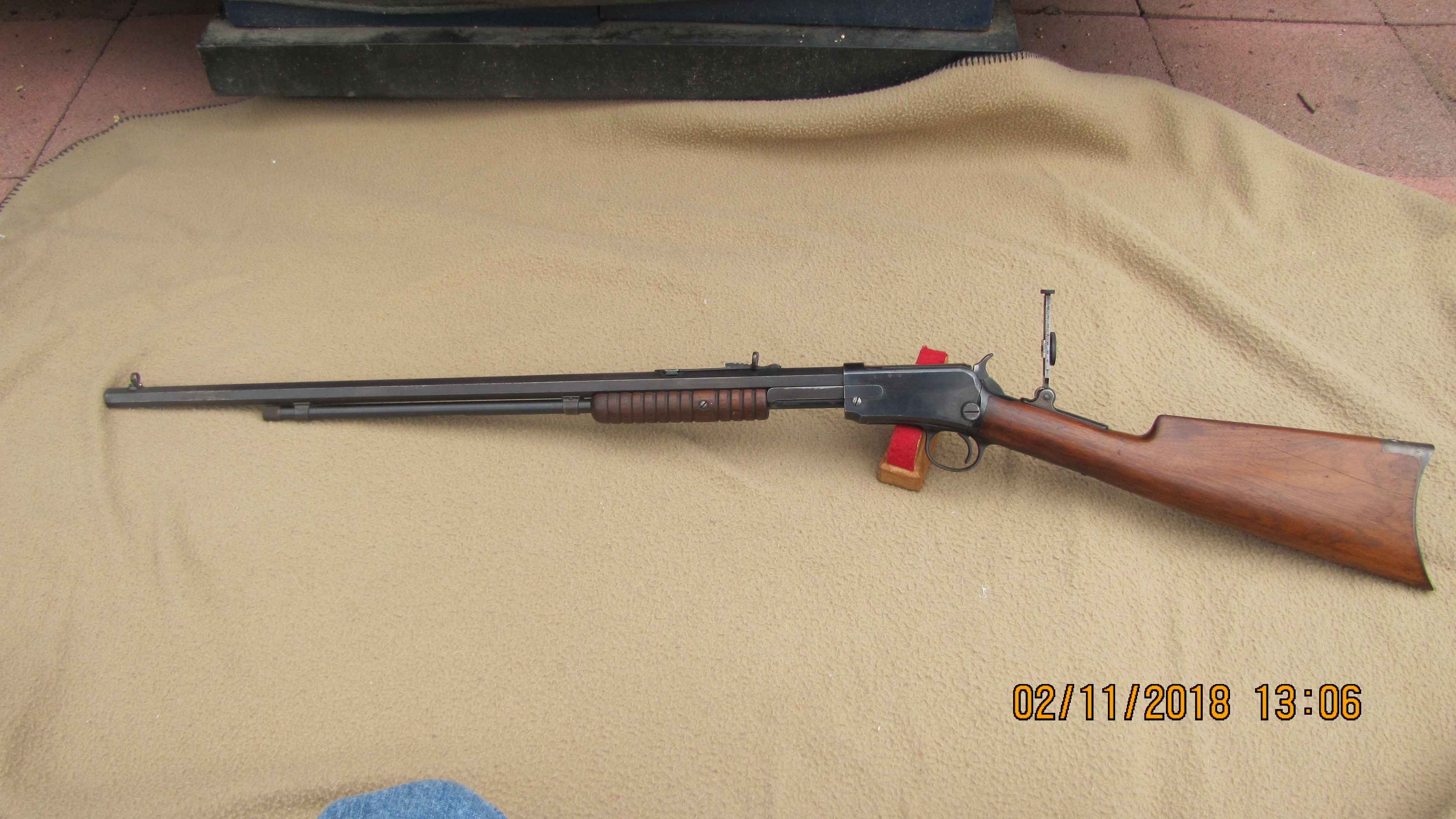

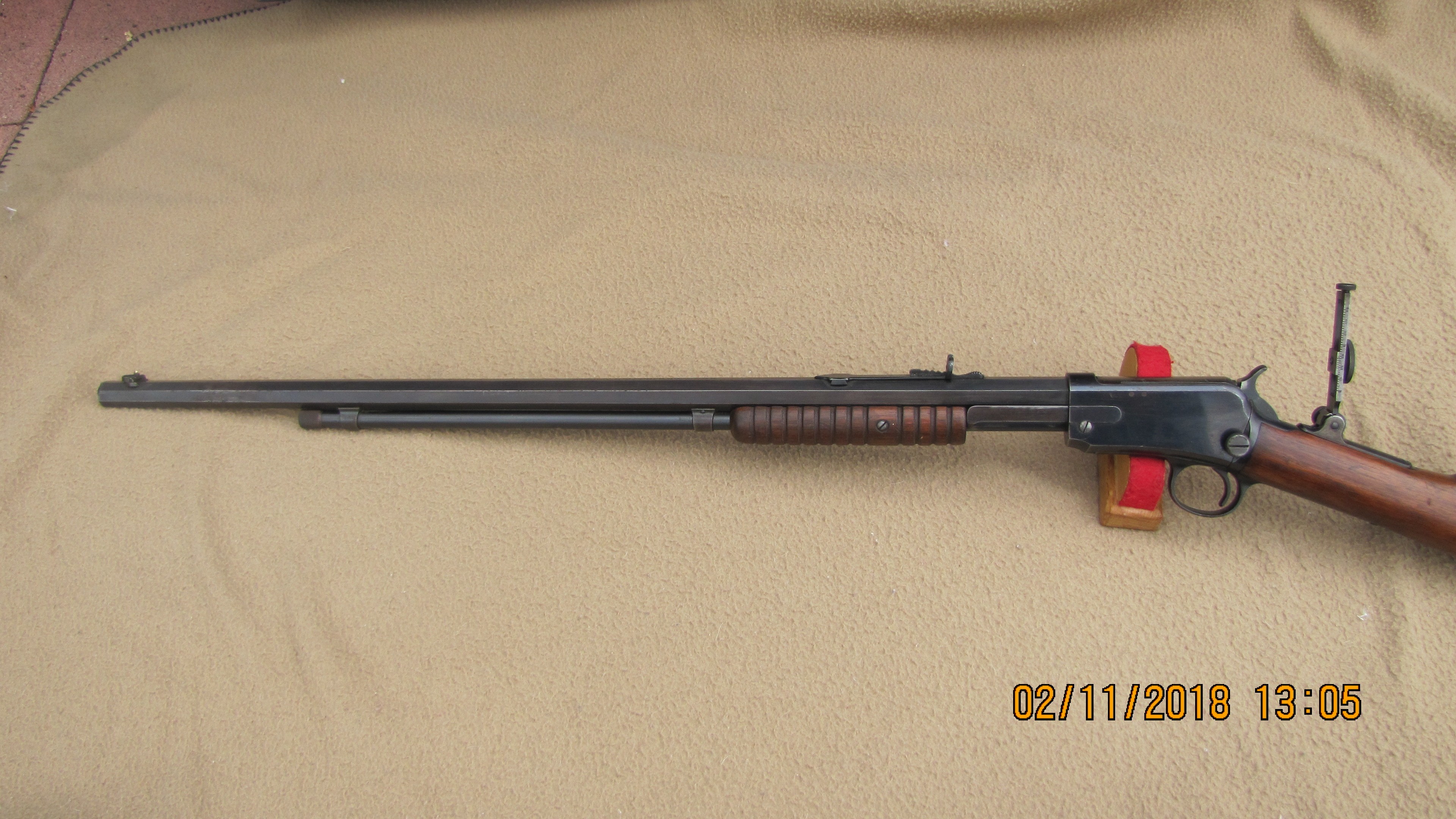

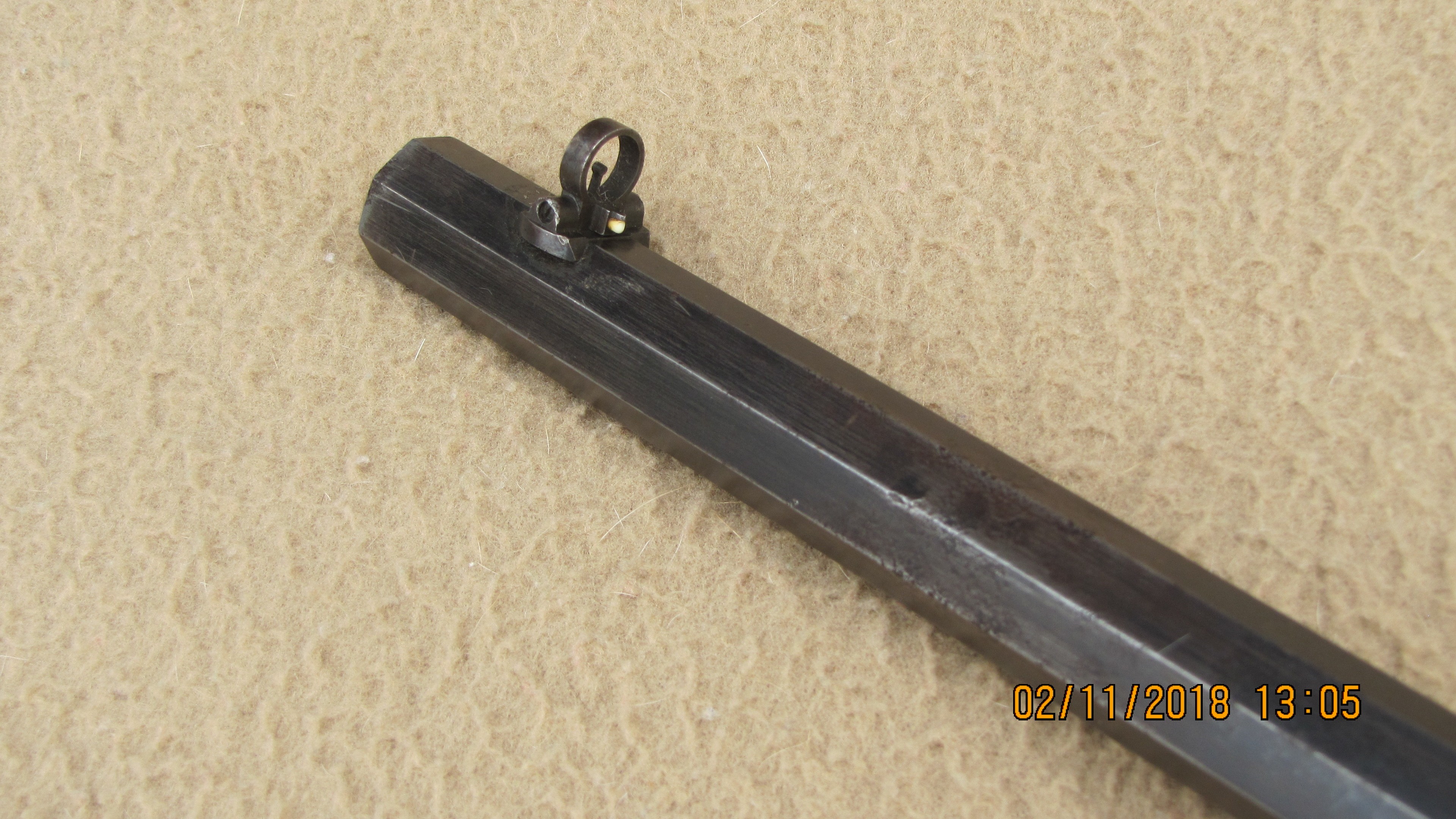

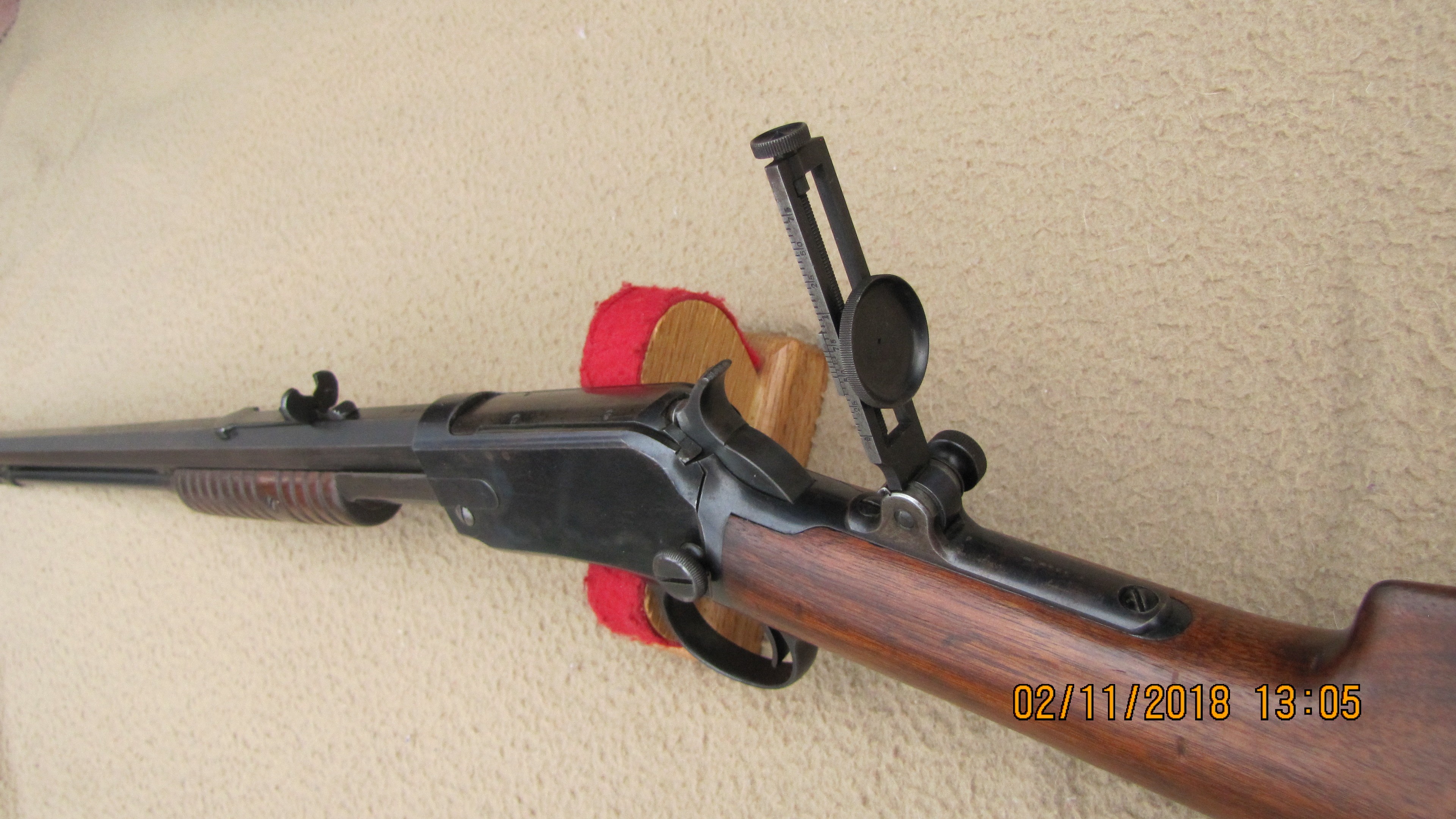

Found a Model 1890 on an auction awhile back with great sights and reasonably good finish, so I went for it.  Not enough time left on the auction to check with Cody.  Ended up right at $1,100 which I figured was justified because of the Winchester Vernier tang sight I was after.  Imagine my surprise when Cody verified the sights as original to the little W.R.F.  Needless to say I was happy to discover a very good bore (not perfect!).  It shoots very well and I have abandoned any thoughts of removing the sights!  Sooooo…. it’s ok to buy a gun to get the sights or scope or….

Nice clean second model Roger!  Congrats. on the nice surprise from Cody.

That is a fantastic piece. I would have never guessed an 1890 might letter with that set of sights………. wish I had that one.

Super nice find!!   Congrats!
