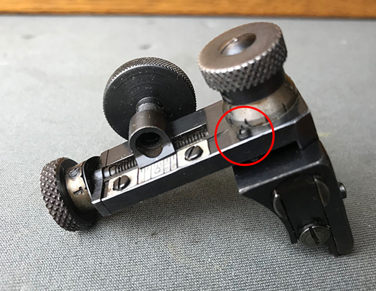

Hi Bill-

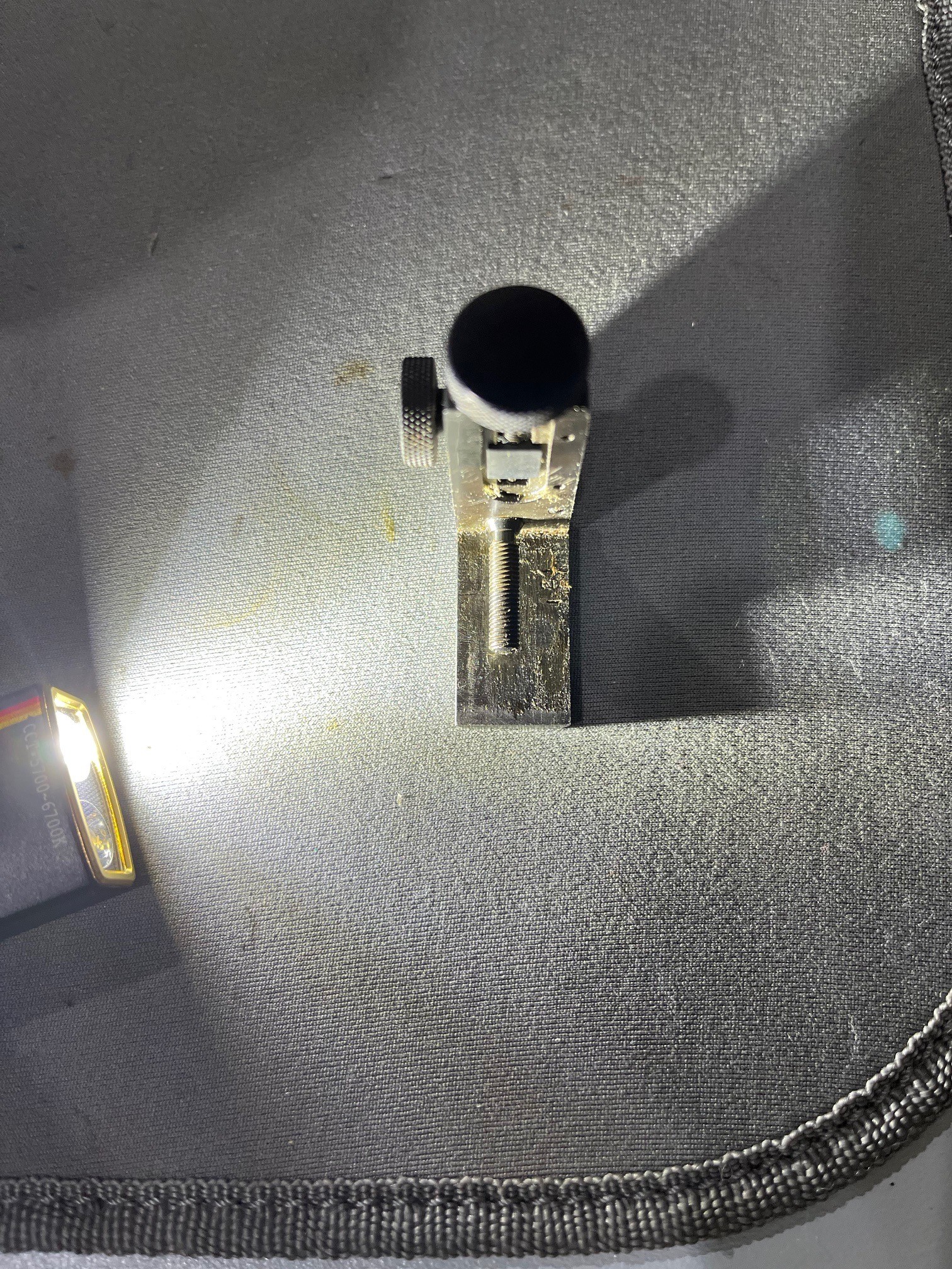

I don’t want to insult you by telling you what you already know, but when I read your post this AM my thought was the same as Steve’s.  In the lowest position, is the horizontal cross bar of the receiver sight slide all the way down in contact with the base block? Or is something preventing that? There is a set screw in the cross bar that limits travel.  It was supposed to allow one to “set” the minimum slide height after sighting in, so that you could remove the slide and return to “zero” automatically upon replacing it.  But it limits adjustment (on purpose)…
It’s the thing circled in red on this pic.  This is a Lyman 48, but the Lyman 57s have it as well:
I apologize for telling you something you already know, but it wasn’t on your “Usual Suggestions” list above.
Good Luck!!!

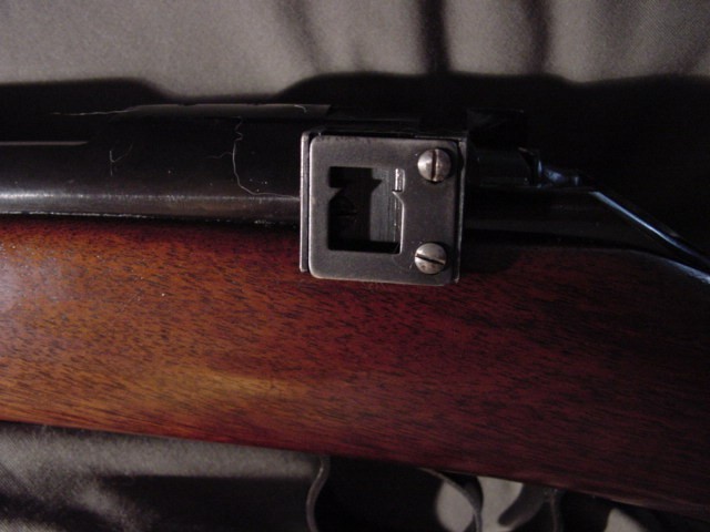

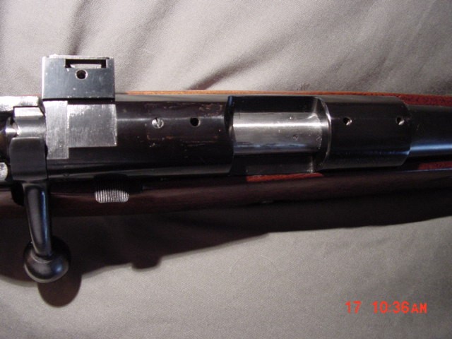

Hi Bill-

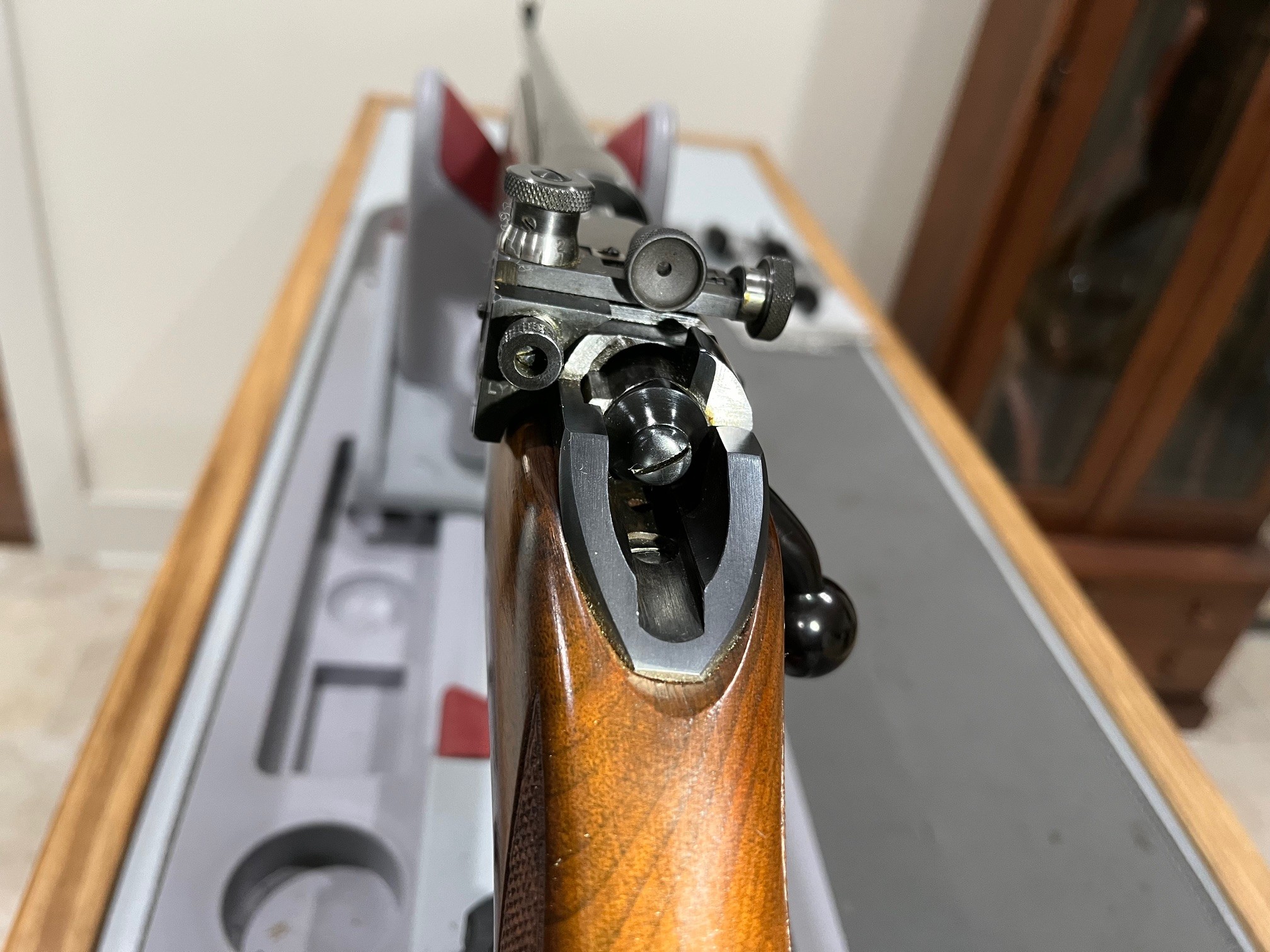

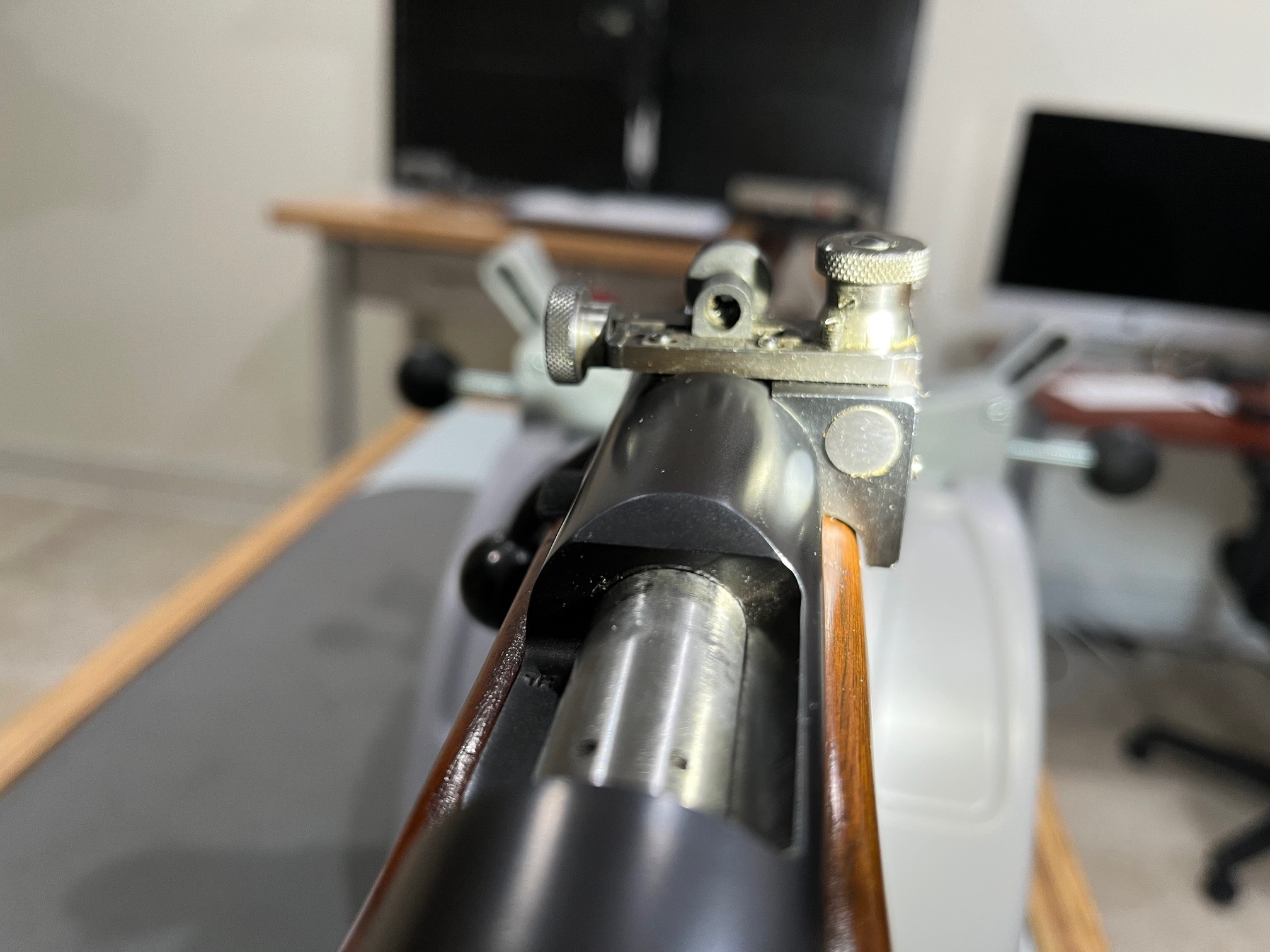

I know nothing about M52s (that’s Steve’s Department)…  The one M52 Sporter to which I have access is a late B Sporter (s/n 84635 B).  It is a very high condition gun with what I believe are the original Lyman 48F and Redfield 255 sights.  I have never fired this rifle, but now I’m curious… Laugh
On this one, with the elevation stop screw retracted and the slide pushed all the way down, the cross bar contacts the base block of the sight.  No wood or metal interference.  I’m attaching a couple photos showing the cross bar all the way down, and one of the elevation screw from the inside.
Hope these are useful for comparison… Laugh
EDIT:  To follow up on what Steve just wrote below, the elevation screw on this sight protrudes about 0.708″ below the cross bar.  When all the way down it does not protrude from the base block or make contact with the stock.

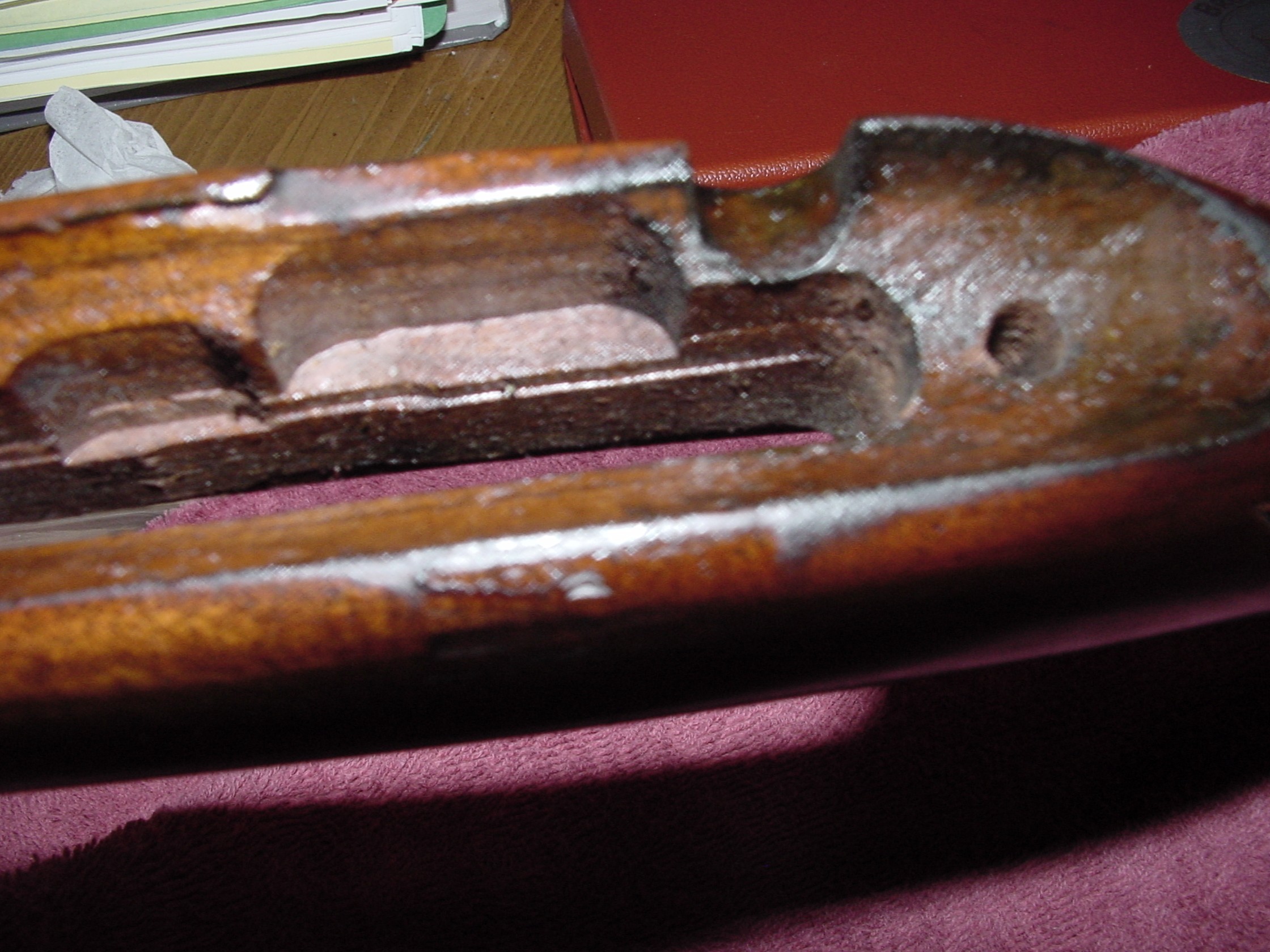

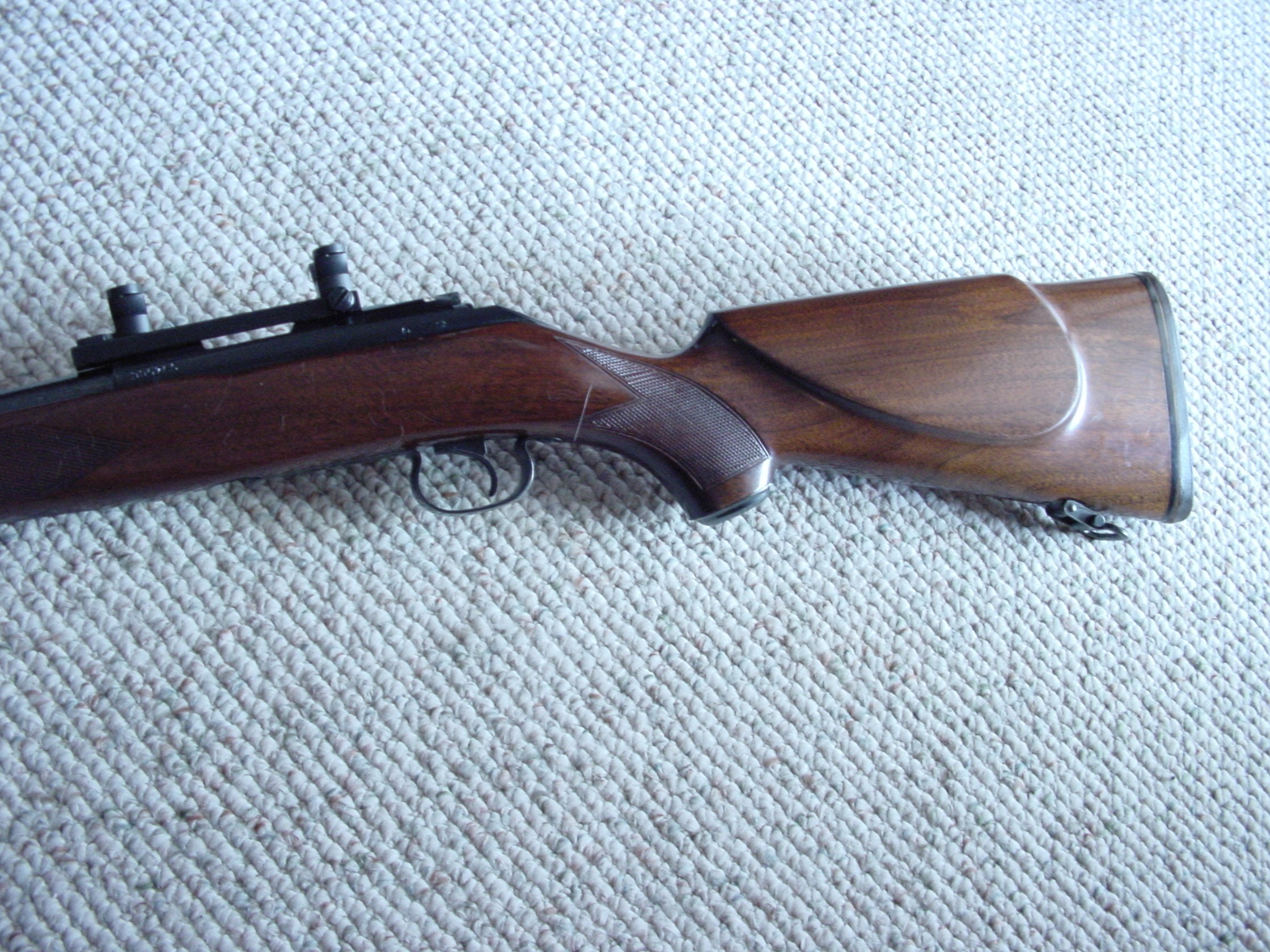

Steve, Lou, BRP — After your collective advice, I can better understand why Mother said I should go to law school instead of pursuing an engineering degree. I couldn’t quite get my head around the mechanical principle involved — that to lower the bridge I must lower the elevation screw to which it is connected and which moves it up and down. duh.
Lou, you are right neither the Lyman 48F nor the Redfield #255 are original to the gun, S/N 99076C being an end-of-the-bolt Sporting Rifle. I only recently obtained both sights from BRP, who, in a moment of Christian charity, sold them to his fellow Anglican at (slightly) less than their current eye-watering market price. He furnished me two lengths of elevation screw, the shorter one presently installed but very likely still bearing on the stock.
As you can see from the attached photos taken shortly after I bought the rifle, it came with the body of a Redfield 70 receiver sight, shade tree engineered to poorly fit the receiver. The bare stock photo shows (dimly) an indentation made by some sight’s elevation screw, although not likely the Redfield.
I will remove the Lyman 48. Once free of the stock, I’ll see if the elevation knob will operate to further lower the bridge. If so, I’ll inspect to see how far the elevation screw protrudes from the sight base when the bridge is fully down, and relieve the stock to allow it.
TxGunNut and I will then repair to the range and see if we can get the point of impact to coincide with point of aim at 50 yards. If it should prove to be an inch too high still, I have a ready remedy. A Redfield Sourdough .375 H now rests in my 1950 Model 70 Super Grade .30/06, paired with a Lyman 48 WJS-H.  I will install the Redfield #255 in the Model 70 and install the Sourdough in the Model 52. The Model 70 will then be stone “correct” and the 52 will be squirrel-ready.
Hoping to be Spared, I’ll report further.
*** Image attachment removed from post content ***
win-99076C_hires-010.jpgM52-Sporting-Rifle-99076C-026.jpgwin-99076C_hires-022.jpgM52-Sporting-Rifle-99076C-011.jpg

If you look closely at the first of the three pictures I posted above, when the 48F sight is all the way down, the bottom edge of the cross bar is actually slightly BELOW the radiused (cylindrical) part of the receiver, nestling (slightly) into the flat milled portion of the receiver top aft of the round section.  Downward travel of the slide is limited by contact of the cross bar with the top surface of the sight base, not the receiver…
First thing I’d do is remove the sight (so no interference from any part of the gun) and make sure that the slide will go all the way down until the cross bar contacts the base block.  That’s as low as she’ll go… If it won’t then there’s something wonky about the elevation screw.  If it will, then I’d see if (how much) the elevation screw protrudes from the sight base.  If it’s enough to contact the stock, then you’ve got your answer!!!  Laugh
I think I’d be more inclined to shorten the screw rather than remove wood from the stock.  A Lyman 48J may be pricey, but a M52C Sporter is in an altogether different (loftier) price bracket…

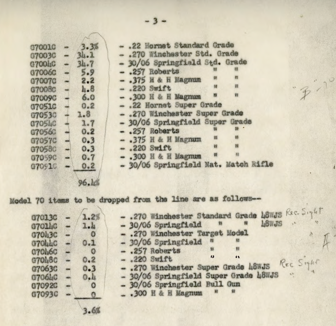

But for the real Geeks, i.e. ME… Wink In 1950 Lyman made several changes in the Lyman 48WJS.  Since 1947, they had been made with the coved base block that did not require the rectangular stock inlet.  But in 1950 other changes occurred; the slide release return spring was changed from an external leaf spring to an internal coil spring AND “Stayset” knobs were introduced.  The January 1950 catalog is the first (and ONLY) catalog to depict/describe the M70 with Lyman 48WJS as having “Stayset” knobs.  Here’s the Super Grade page for G7063C and G7064C from January 1950.
Two more interesting clips from the Revised “Firearms Simplification Program of 1951” document.  These explain the rationale behind dropping the receiver sight option altogether and (for real trivia fans) show the percentage of orders by Catalog Symbol of the 1950 offerings.
You can see that by 1950, M70 Super Grades with factory 48WJS in 270 WIN and 30-06 SPRG constituted only 0.3% and 0.4% of orders, respectively…  People were either going with telescopic sights or installing their own receiver sights aftermarket…

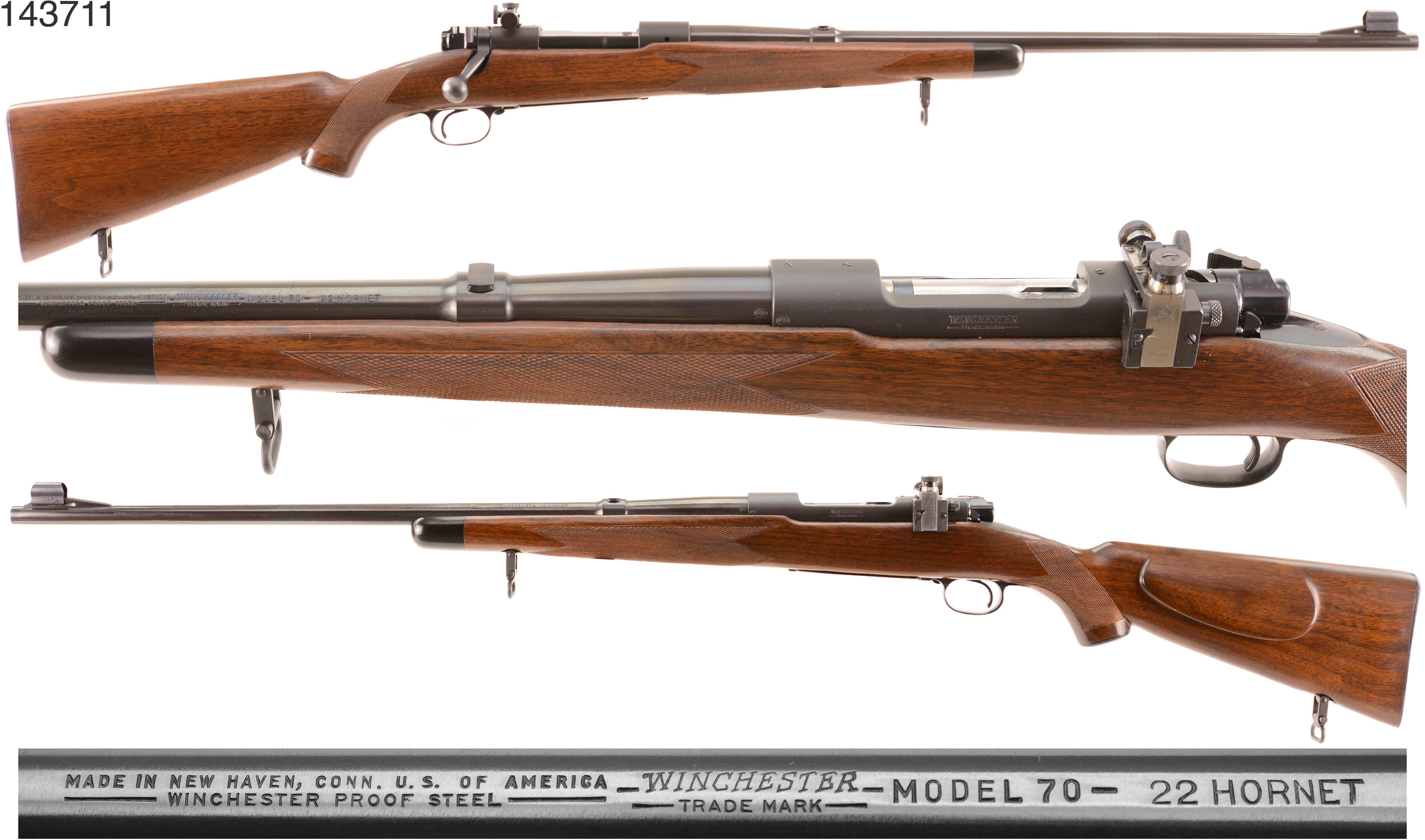

I’m in about the same boat…  One of the two M70 Super Grades in 22 HORNET that I’ve decided to keep is a 1950 rifle my that Dad bought from the original purchaser.  It has literally had about half a box of ammo through it. The seller included two boxes of vintage 22 Hornet ammo with the gun, one half empty; the missing shells representing the total number of rounds he’d fired through the gun…
Anyway… It came with a Lyman 48WJS with target knobs installed.  I know for a fact that the owner put it there b/c the sale also included the original box the sight came in.  Just like Winchester’s assessment above that lead to their discontinuation of the 48WJS option…
I like the gun…  You’d be hard pressed to find one in better condition.  But the receiver sight is not factory original to the gun.  I don’t care… Laugh
But it does still have the original Redfield 254… Wink
