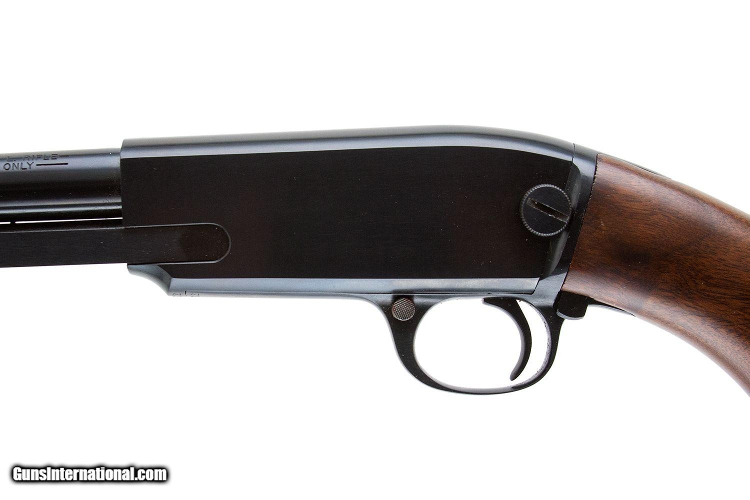

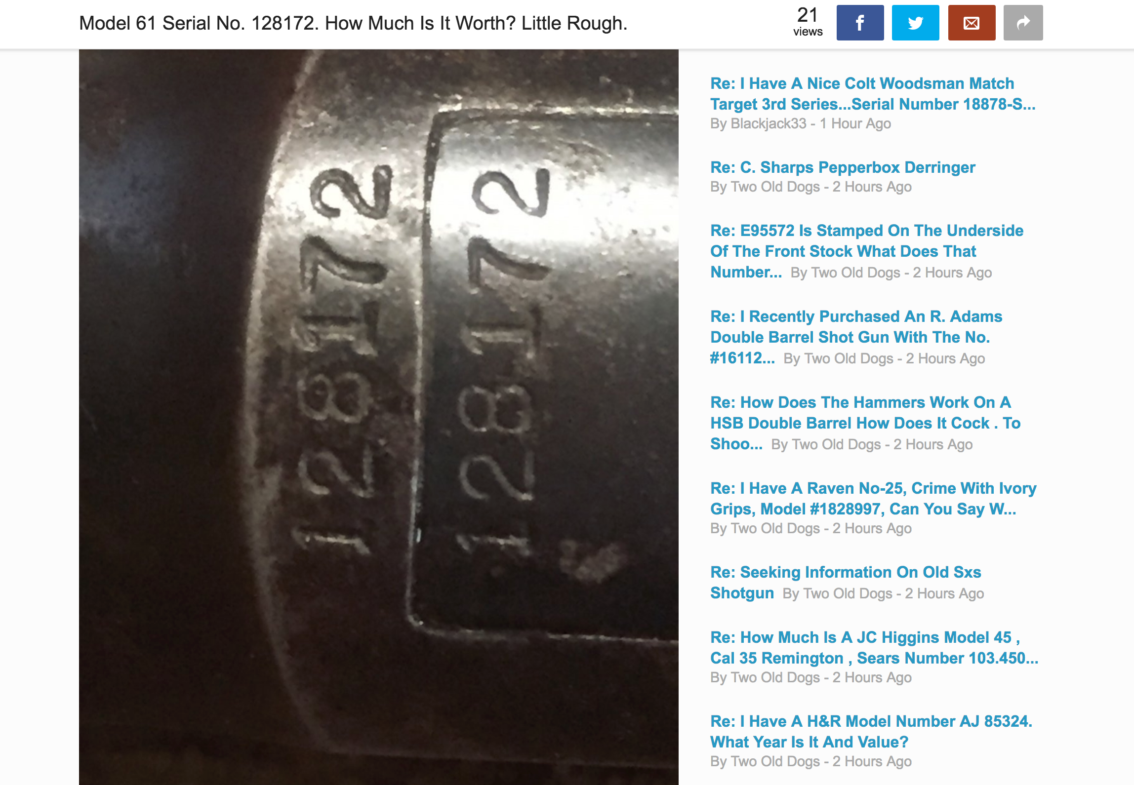

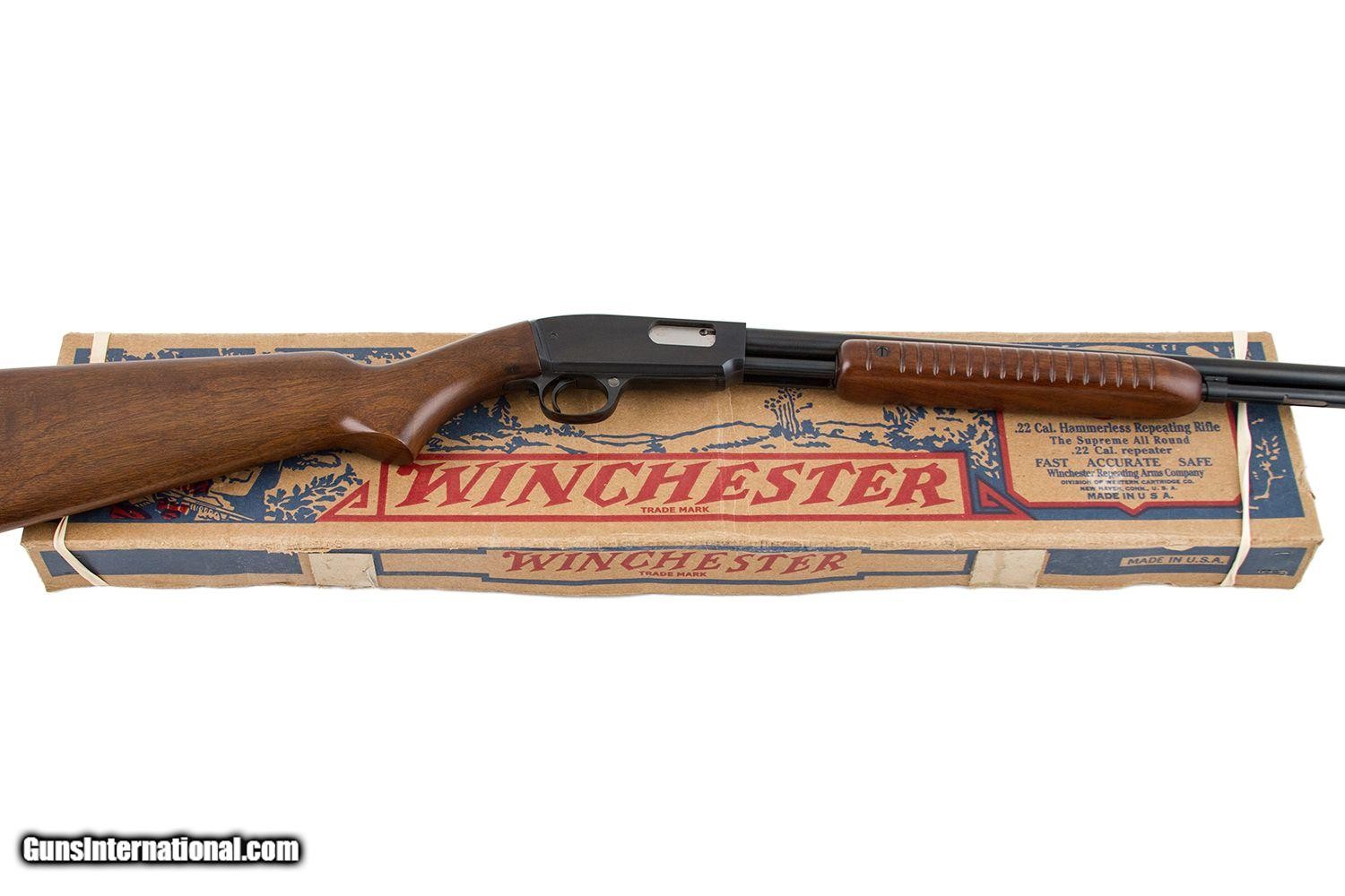

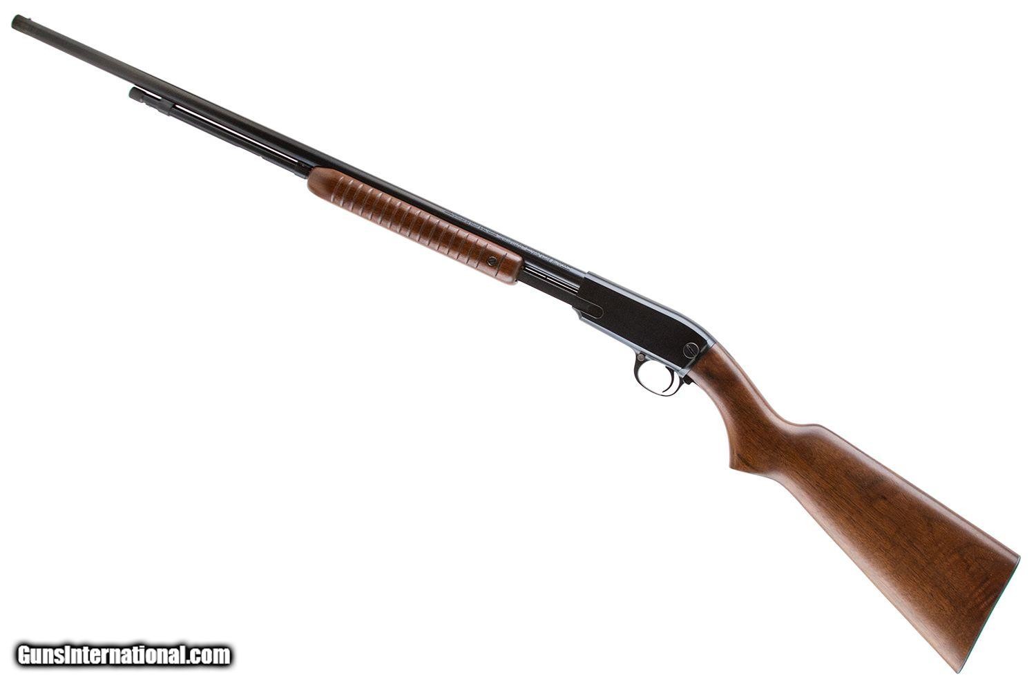

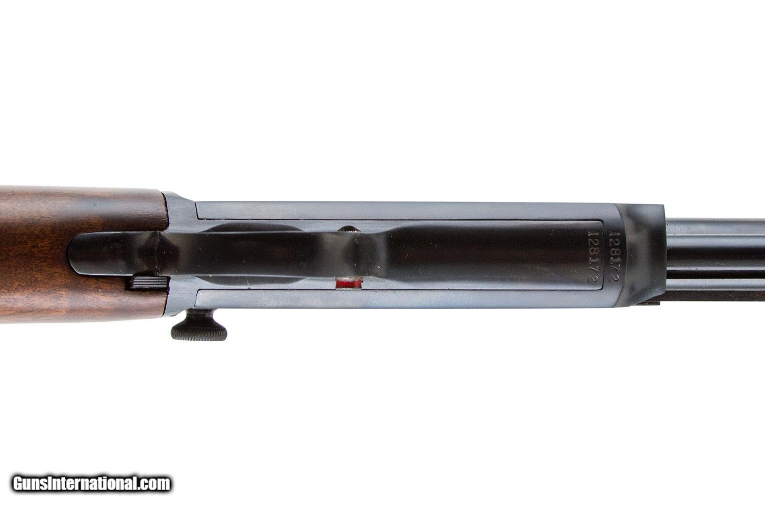

This one, SN 128172, started out as a POS old standard rifle which I had seen on the Gun Value Board about 11 months ago. Now it shows up on Steve Barnett’s site via Guns International as a spanking new (ANIB) looking “Shot Only” configuration with a/the box to make it all so much worth $6500 asking price!!! How do these guys sleep at night?  Save this serial number guys!!  Be looking for it down the road.
Here is the original GVB forum thread:  https://www.gunvaluesboard.com/model-61-serial-no.-128172.-how-much-is-it-worth-little-rough.-573163.html#615089
And here is the link to the faked rifle offered by Steve Barnett:  https://www.gunsinternational.com/guns-for-sale-online/rifles/winchester-rifles-model-61/winchester-model-61-picture-box-22-l-rifle-shot-only.cfm?gun_id=101047598
Original SN
Faked SN

Are these barrels  counterfeit or factory barrels that someone is faking a standard gun into a rare shot rifle?
 Any idea on who might be doing these conversions because they’re really screwing up the market on 61s and honest people are getting hurt  thanking they have a rare original when in fact they don’t.
Forum Posts: 7757
June 6, 2018 - 11:48 pm
Listing pulled/sold. I suspect we’ll see it again. Good eye, Michael!
Forum Posts: 7757
June 7, 2018 - 3:34 pm
Looks good to me. Other than some irregularities in the serial number I didn’t see anything that would indicate refurbishing. Only red flag for me is the box but that’s just a personal prejudice. Are they using NOS barrels for these fakes?
Forum Posts: 2765
June 7, 2018 - 3:42 pm
Mike,
I have no idea where the barrels are coming from.  Most likely brand new manufacture stuff.
