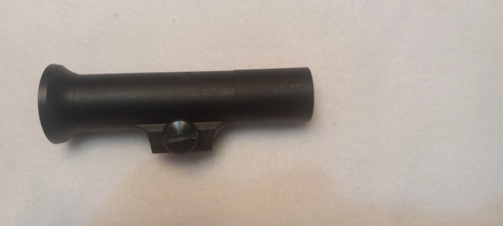

Winchester did not include sights with the Commercial model D’s. The Military D’s were equipped with 670 rear bases, International rear sights, and Olympic front sights.
FYI there were 2 distinct models of International front sights, the Big Bore for centerfire rifles, and Smallbore for the rimfires. The SB looks very similar to the Olympic and the BB is much shorter with no “bell” at the front .

I’ve seen both of those styles but until now, never knew the difference.  Mine is the small bore according to your description.  Here’s a few photo2 of the one I got from eBay.

June 10, 2024 - 1:14 pm
I’ve never handled one.  Aluminum?

June 10, 2024 - 1:30 pm
Yes, the Redfield International front sights, both the big bore and small bore versions, are made of aluminum.
The Olympics sights are all steel, which is why I prefer them.

June 10, 2024 - 3:11 pm
I’ve never handled one either.  I wanted the International mostly because it has a larger diameter tube to see through.  Also, name wise, it matches up with the International rear.
It appears, and I knew this before hand, it may be more difficult to find apertures for International size.
