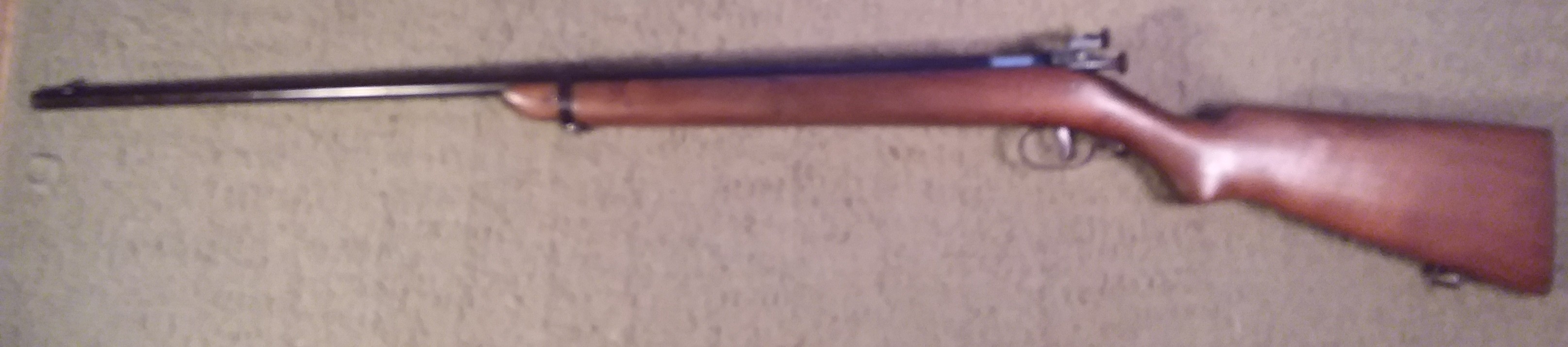

Sling is not original. The original sling was a canvas type called a Kerr. Styled after the M1917 Kerr from WW1 that they put on M1917’s and M1903’s. They also used the Kerr on the Thompson Submachineguns.
The Kerr for the M60-A was less than an inch wide and was a different color.
BTW, the M60 did not come with sling swivels. That was the ultra scarce M60-A target rifle. About 6,000 were made making it one of the rarest of the 22 series not counting the scoped models that came later.
The bbls. are dated. At about 6o’clock underneath. Take the stock off and you will find it.
Pictured is a M60-A target rifle. I have a M60 as well, but no pictures for you. Let me know if you need more info.     Big Larry

 Wow, that is a real beauty you have there, Big Larry!
Mine isn’t near as nice!!
I don’t have that clamp near the foregrip, nothing even showing that it may have even been there at one time or not…. also my barrel doesn’t look as long as yours!

I wound up with 2 M60-A target rifles. One 97% and the other a 98%er. I also have a very early M60-A Sporting rifle with the short bbl. and the early safety. Strange rifle, has all the characteristics of the early M60 Sporting rifle. Winchester sure did some strange things.   Big Larry
