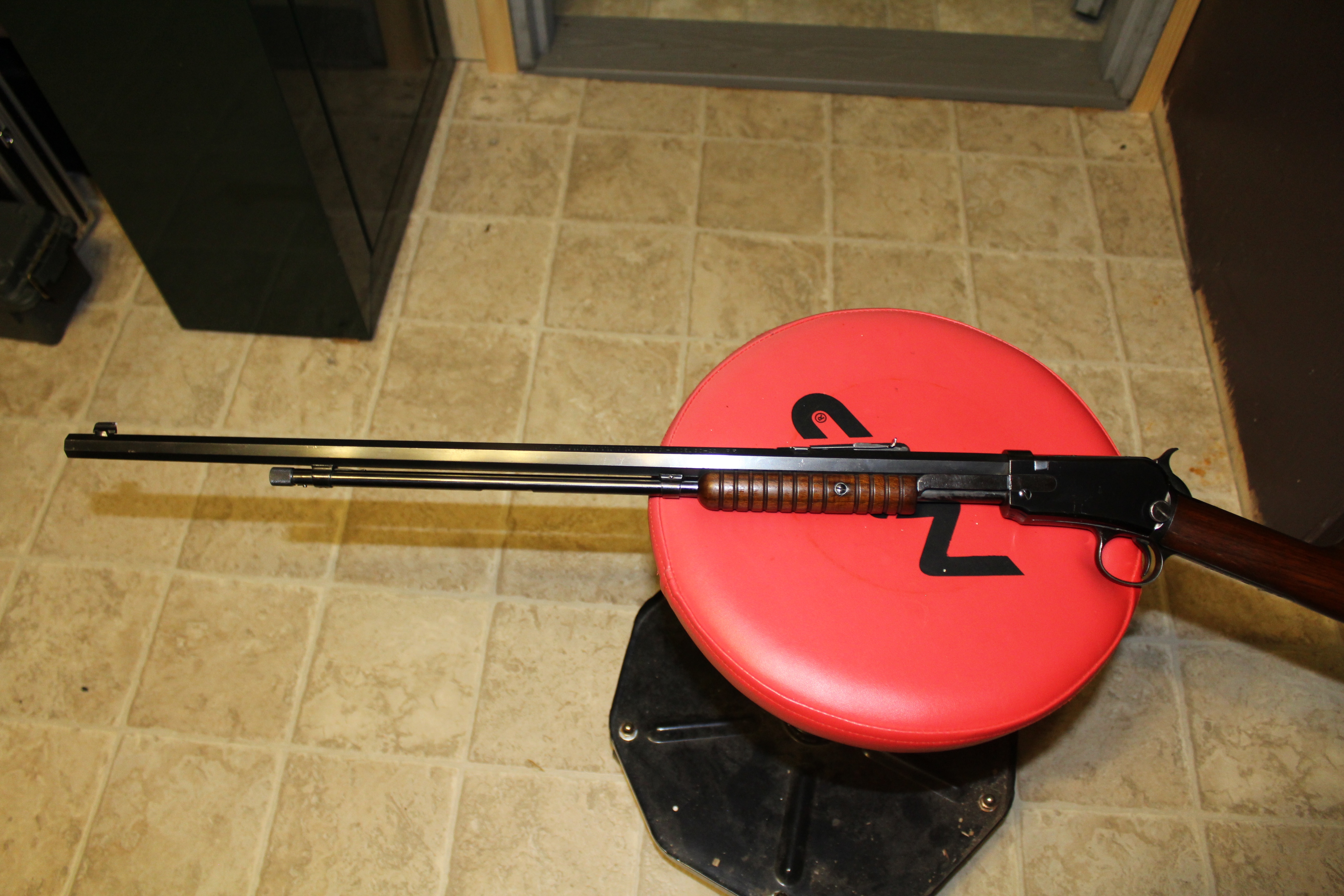

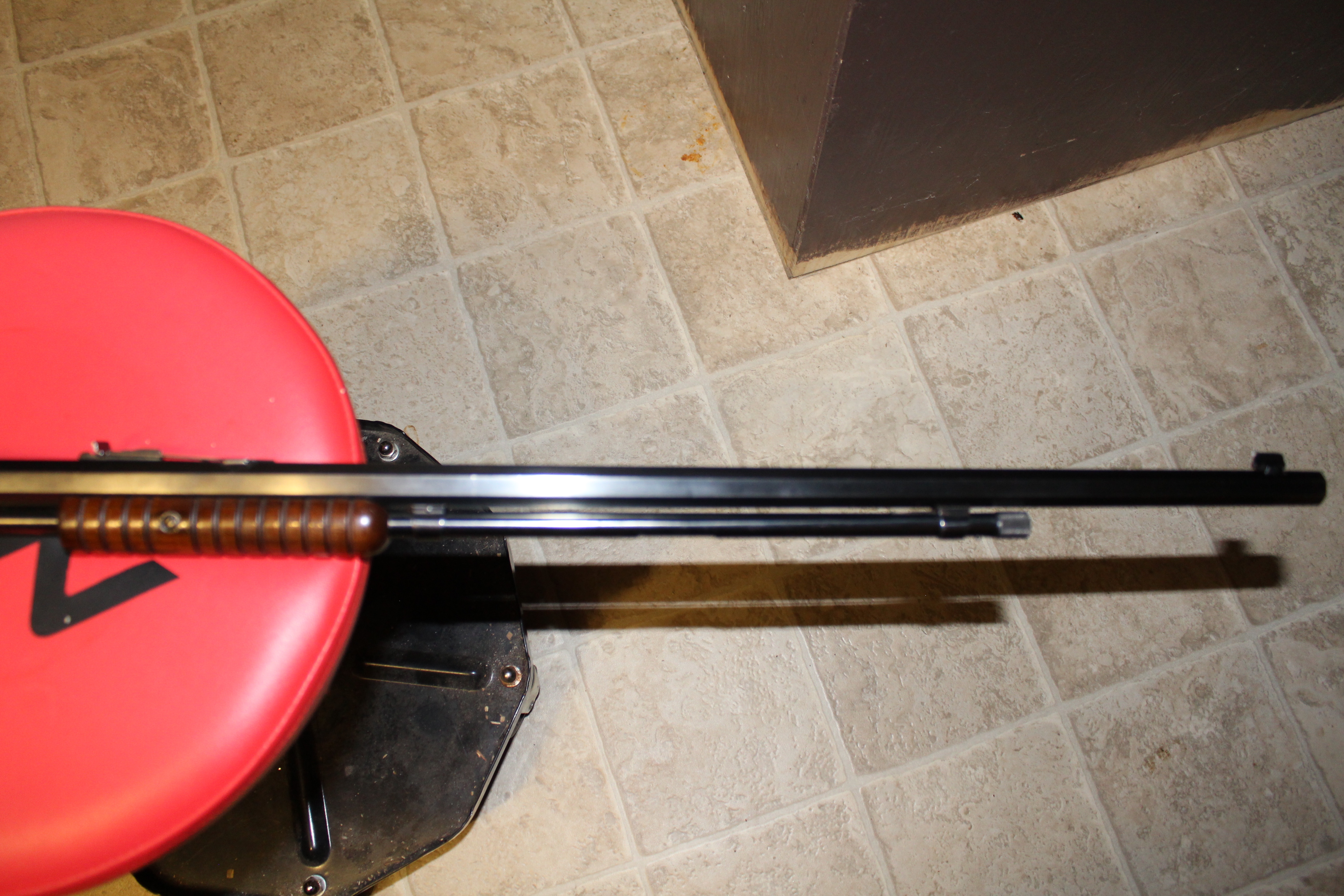

Gentlemen, I came across this 1890 on a forum and seller was nice enough to send over some pics as well as the serial number.
What struck me first was the bluing, the gun appears to be too dark for its age, but that could be lighting/camera. On closer inspection it appears some of the blueing is chipping off?. The next piece of the puzzle is that the barrel stamp and serial number are out by approximately 10 years?
The serial number is 467677, putting around 1911/12. The “made in the USA” barrel stamp didn’t come around until aprox. 1923. What I think the seller has is a pieced together re-blued 1890 22 wrf, I care because this would be a collection piece and not a shooter.
I seek the council of higher powers!
Thanks
Kristjan winchester-1890-22-WRF-001.JPG winchester-1890-22-WRF-003.JPGwinchester-1890-22-WRF-004.JPG

Seems to me your powers of research & good sense have already answered the question!

Definitely refinished, and rebarreled with a newer production barrel.  Not a “collector” piece.

You have done a good job analyzing the rifle and have drawn the correct conclusion.  Definitely refinished, the sling stud attachment in the stock is not original, the butt stock has been sanded, and the barrel is not original.

Both front and rear sights are incorrect also.
That’s what I thought, thanks for the input, glad I asked first and didn’t role the dice.
Erin
Very interesting, I didn’t even get that far to investigate the sights. Its really pays to invest in Winchester research materials.
