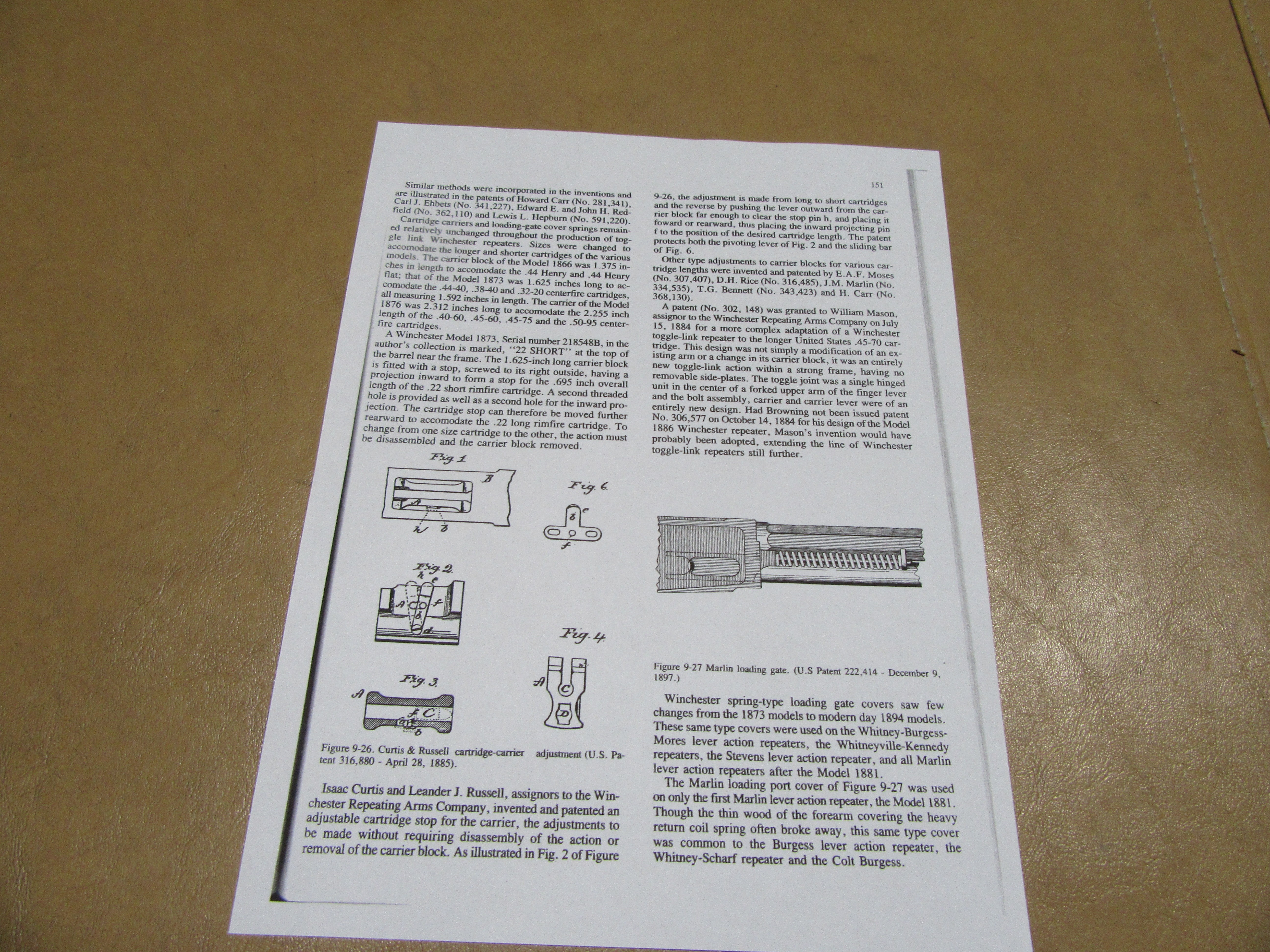

   Bob I will send a copy of page 151 of Bruce McDowell’sIMG_2650.JPG book. It has a lever pivoting from the bottom of the carrier block sliding the cartridge stop from short to long or back. See figure 2. In James Gorgon’s book they surveyed 0ver 3800 guns of which 283 were 22cal. 3- 22 cal. short guns had a selector & 1 22 cal. EX long gun had a selector. The EX long I would say it would be like yours. Could the 22 cal. guns be like this drawing? they would just be changing between short & long.    Gail

Gail,
I have only seen 2 types of cartridge adjusters in the 22’s. The one that you have to remove the elevator to move and the one with the lever like figure 2 in the patent drawing. I have not seen anything like the figure 6, the sliding bar. One thing I have learned reading these old patents is the text and pictures in them somewhat resemble the final production part but can have big differences. I looked at my Extra long gun with the selector lever and noticed it had 4 positions. It has the short and long positions  and then it has two positions close together for the extra long. I have some 22 extra long made in Switzerland that feeds correctly in the #3 position that I shoot. The Winchester brand Extra Long shells are slightly longer and work in the #4 position but never tried to fire them.

Have you seen one like the one with the lever in picture 2? I don’t know if you can read this. It reads on the top of the page right column the adjustment is made from long cartridges to short cartridges and the reveres by pushing the lever outward from the carrier block far enough to clear the stop pin h,and placing it forward or rearward. thus placing the inward projecting pin f to the position of the desired cartridge length. ( f is the cartridge stop.)

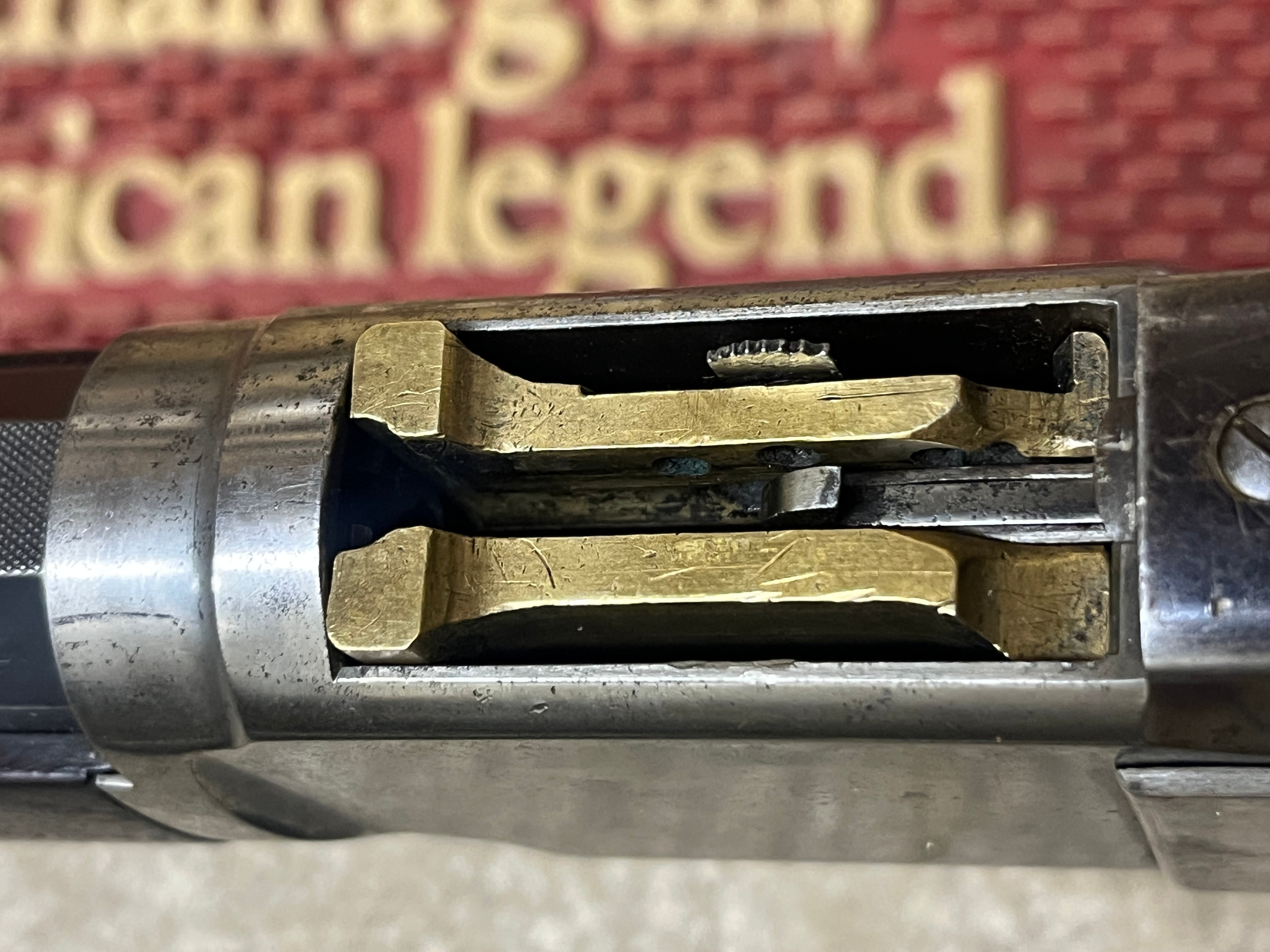

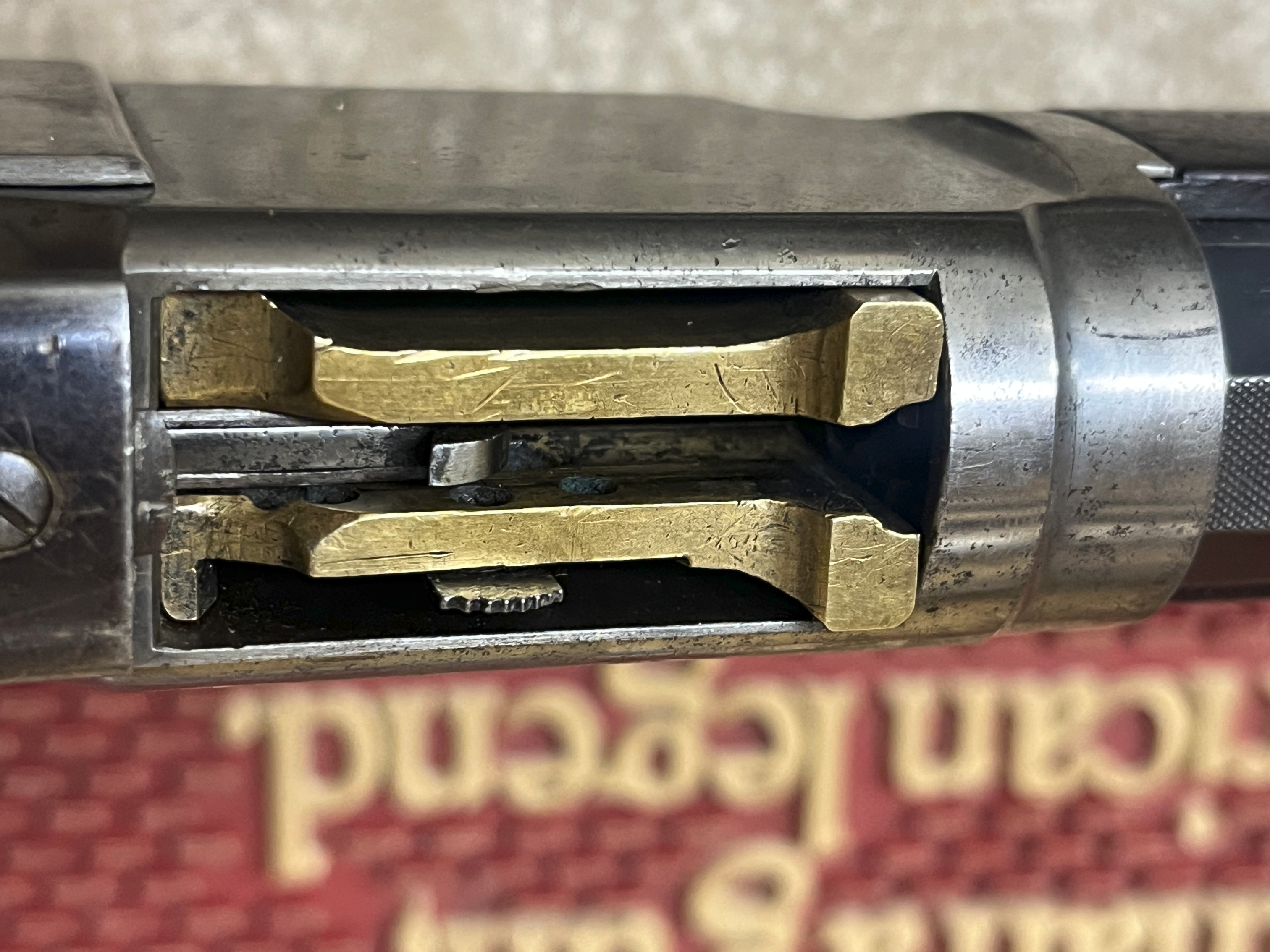

 Yes I have seen the lever style like figure 2 but like I stated before the production lever selector is not exactly the same as its described in the patent. I have the serial 194605, the one pictured on page 520 in the Gordon book and pictured in the Madis book. From what I see in my research there is only 3 with the levers
Here is a picture of the elevator on it.
